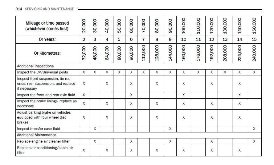

Before I go in for service, I check the manual. If its not on the manual or Im not having an issue, I do not get their "suggestions." There was a few times in a row where the service adviser advised that I do their fuel system cleaner. I kept declining. Finally one time I had him explain exactly what it was. When he was done, I said "oh that sounds like the techron I ran through my tank 500 miles before I brought it in today." I hasn't come up again. Have them explain what the induction service is. If they say they just run cleaner through the tank, pass. You can get techron or some other cleaner at autozone and do right before your next oil change. Your jeep shouldnt need it unless you have been running no name gas. Do your brakes fell spongey or less responsive? If not, I'd pass on the flush. The differentials are different. Do you know for sure that they looked in them? 30K is about halfway through its change interval. For piece of mind you can have it done. That seems like the going price. For about $40 total and a couple hours you can do it yourself like others have said. The main thing that takes time is waiting for the oil to fully drain. I had mine done at 30k right after I bought the jku, and I did the 60k service myself. And im not that mechanically inclined, so its pretty easy.

I was at the dealer today for my Wave service. (Oil and filter change).
I was told that I needed to have both differentials flushed as the oil was black. $189.95 for each axle.
This Rubicon has lockers, and I don't know if that makes it harder on the oil. I've used the lockers twice.
Does this sound like a ripoff?
Also, they tell me that I need induction service for $219.95.
Lastly, they tell me I need a brake flush for $189.95.
I appreciate any thoughts on this. I would guess I don't need any of it, please help.
Thanks,
Sounds like pretty routine 30K miles preventive maintenance.
My rule is: "It's cheaper and better to maintain things than it is to repair them or replace them."
But that's just me.
Ridgway Jeeper
Frank
Jun 24, 2021
475
883
Ridgway, CO
2021 JLR
Real Estate Agent

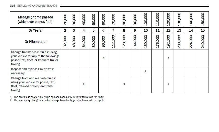

Relying on a dealer to "maintain" your vehicle properly is a pretty dubious plan for those of us that do our own service work. I can not imagine your differentials need changed yet unless you have been towing a lot. The front one almost certainly doesn't need changed as that oil has mostly just been riding around doing nothing unless you use 4wd a lot. When I did a lot of racetrack time annual brake fluid flushes were mandatory. No way you use your brakes that hard. Every other year is more than adequate but good maint many people skip. The induction system clean is just a rip off. Completely unnecessary at this mileage and likely unnecessary pretty much ever on this vehicle. Change the air filter, that is the only induction service your Jeep needs at this point.
So you can have these things done but it sounds like they are a bit offensive to your budget. If so, I would pass on the extras myself. Diff fluid being dark is hilarious... my rear diff fluid was already dark at 1500 miles when I dumped it to pot my locker sensors. If that was the standard you would be changing it all the time.

Lastly, they tell me I need a brake flush for $189.95. - Fudge no
The rest: Personally, the 3.6 induction cleaning I may do at 100K, not a 33K. The differential flush, I would do at home when the manual says to do it.
