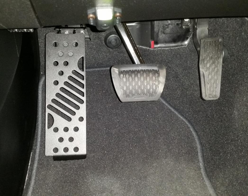

Looking at the pictures, does this make it difficult (or impossible) to pull your all weather mats out if the dead pedal is bolted in place and sitting on the mat? Does it damage the mat?

It is hinged, so it can be “flipped” up to remove the mat. I can’t speak to damage as I’ve only had it in for 2 days

Mine is not hinges but there is enough room to slide the Matt out. I’ve had it installed for a couple of weeks. No damage.

Mines been in for over a year and no damage and mat slides out easily.

Mine is hinged and it swings up.
If you assemble it first, then it is a less than 5 minute installation.

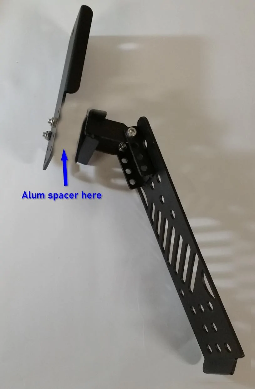

The base plate to the Jeep has two bolts that attach the bracket. The way mine arrived it was already as forward as possible if the middle bracket is attaching at the top to the pedal as shown below.
An option is to add a metal spacer in between the back plate and the bracket and use longer bolts, if handy with cut/drill or know someone to do this, that is if not minding a little DIY to modify.
First would see what distance is needed, use either piece of wood or thin book and while stationary, place it against the pedal and see how much more forward to feel comfortable.
If it's a small amount the spacer idea can be something to explore.
Too much spacer and it will change the geometry to meet the floor which is needed for
stability, so perhaps dropping down a position on the rear base plate, but that again will
also change the angle slightly.
Jeep Wrangler JL Dead Pedal, single bolt attachment type. Spacer

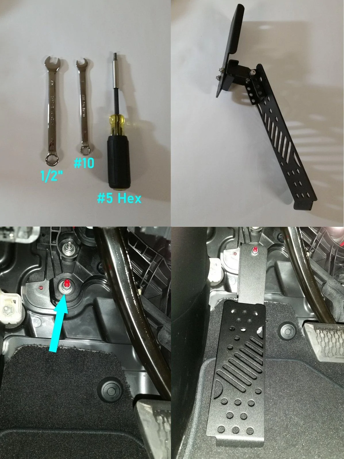

20 minute install dead pedal, came in two parts, pedal and small bracket and back plate that goes to Jeep,
and supplied with two sets of bolts and nylanuts to attach parts together. Made of steel. Feels solid.
Faster to remove the bracket, attach bracket to back plate, then reattach to pedal using #10 open wrench
and #5 hex driver. Choose one of four positions on back plate for height of pedal attachment. I choose the
second from top, will see how that goes for positions and different boots.
Attaches to single red bolt on Jeep firewall under dash using 1/2" wrench.
The pedal hinges up with friction hold to remove the carpet to clean, presses against the floor, so it's a
few inches back from brake.
Read of so many install issues with the side mounted pedals, was pleased this was not difficult, one bolt
straight back. Probably faster to use a small low power air wrench to deal w/ 1/2" nut, but on one knee
outside Jeep, front seat back, towel over edge, leaned in to wrench nut off and on, not so bad.
There are a lot of these on Ebay, some overseas, but searched for metal black left peg jeep wrangler jl
and found a supplier in Los Angeles (customer). Was $23 and free ship. PM if interested in link.
