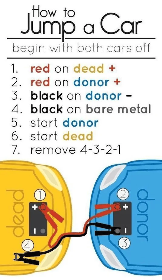

I make my wife and kids keep this in their iPhone notes app:
Jeep Wrangler JL Dead Battery, Cables Hooked Up Wrong! 1616802845433
Yes, thats the proper way & the notes idea is great! I also instructed my son to never go solely by the cable color as a lot of people replace cables and dont make sure to use proper colors for pos/neg - though as my co-worker says when I'm being picky about wire color on a test cable or some such "the electricity doesnt care what color the wire is "' :)
