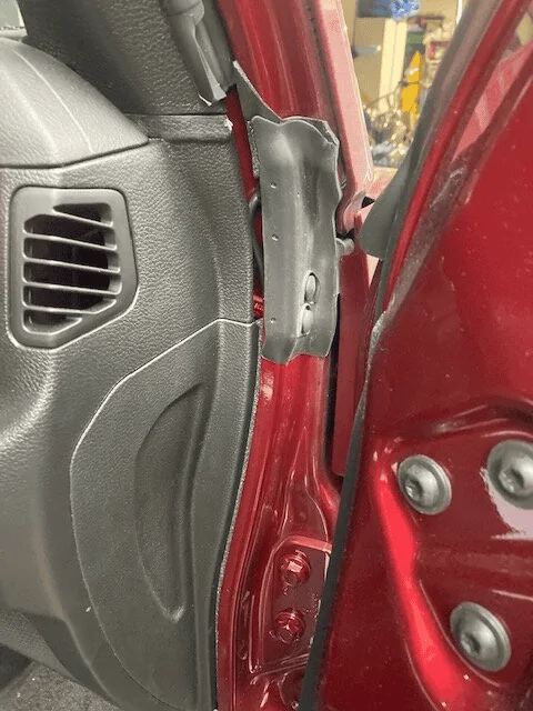

This is a picture of how I ran my GMRS antenna cable from the inside, you can see the black cable between the door frame and the edge of the dash (look to the right of the air vent if you are having problems locating it).

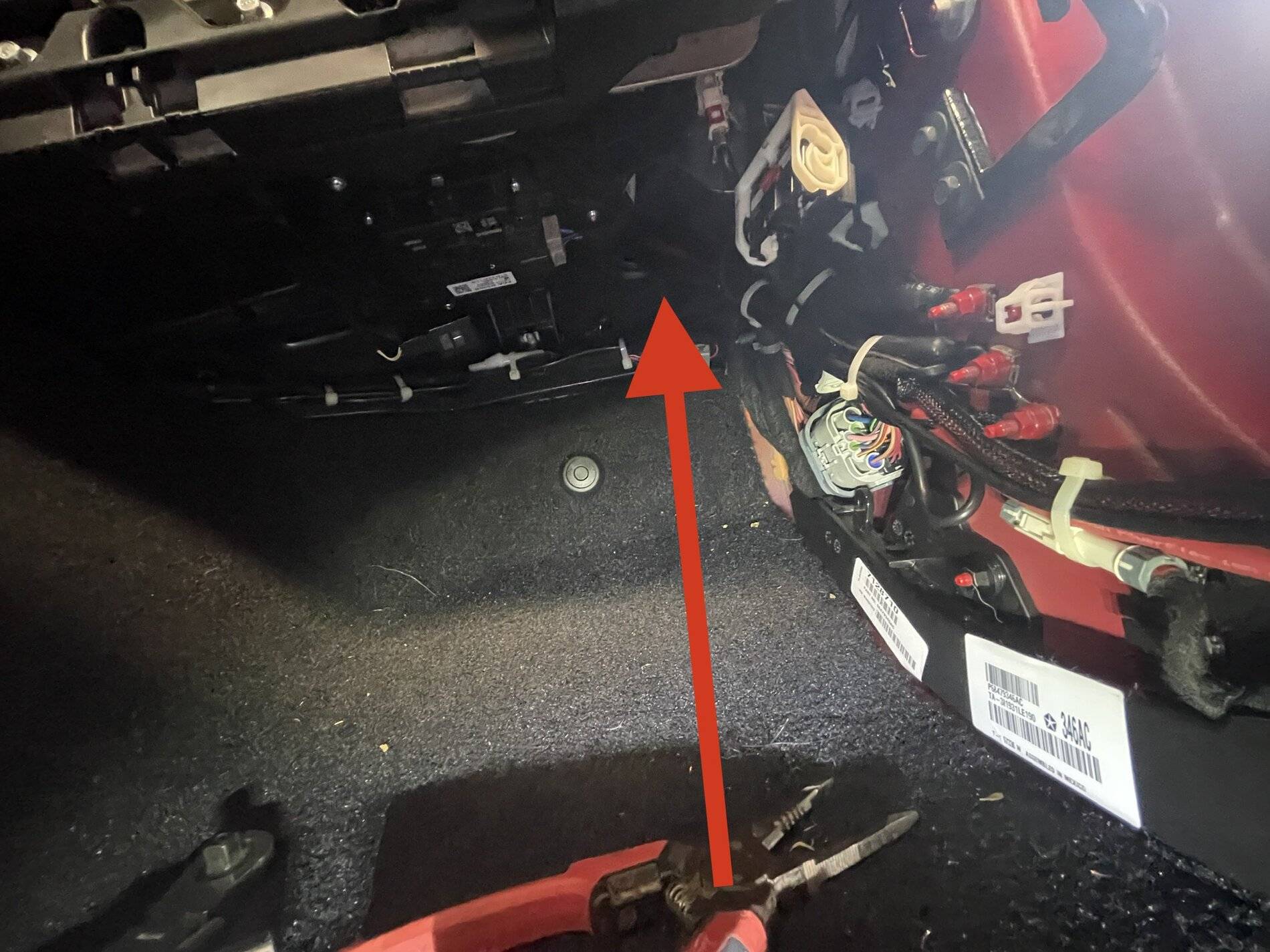

You can run the wire along side the factory wiring harness behind the glove box. Poke a fish tape or hanger through the rubber gasket and it pops through to the engine bay. It helps to take the two Christmas tree clips out of the fender liner to get access to the engine side. This is the way the mopar instructions had me run power when I added the mopar auxiliary switches on my last JL. It’s easy, and the rubber seals around the wires when you pull them through.
You can see the location here
DUDE... this is what i was looking for!
I'll have to research how to remove the fender liner but thanks for the spot to look for! I was looking at that spot for 20 min and could not locate.ha.
Found this video for removing the fender liner.
Awesome!
Do not remove the fender liner! That’s too much work and the plastic rivets need to be replaced if you do.
Just pop the two clips on the bottom (these are the reusable type) and peel it back to gain access to the back side of the firewall there’s two clips on the bottom closest to the door. Pop those and manhandle the liner out of your way. It’ll pop back into shape un-damaged when you put it back.
