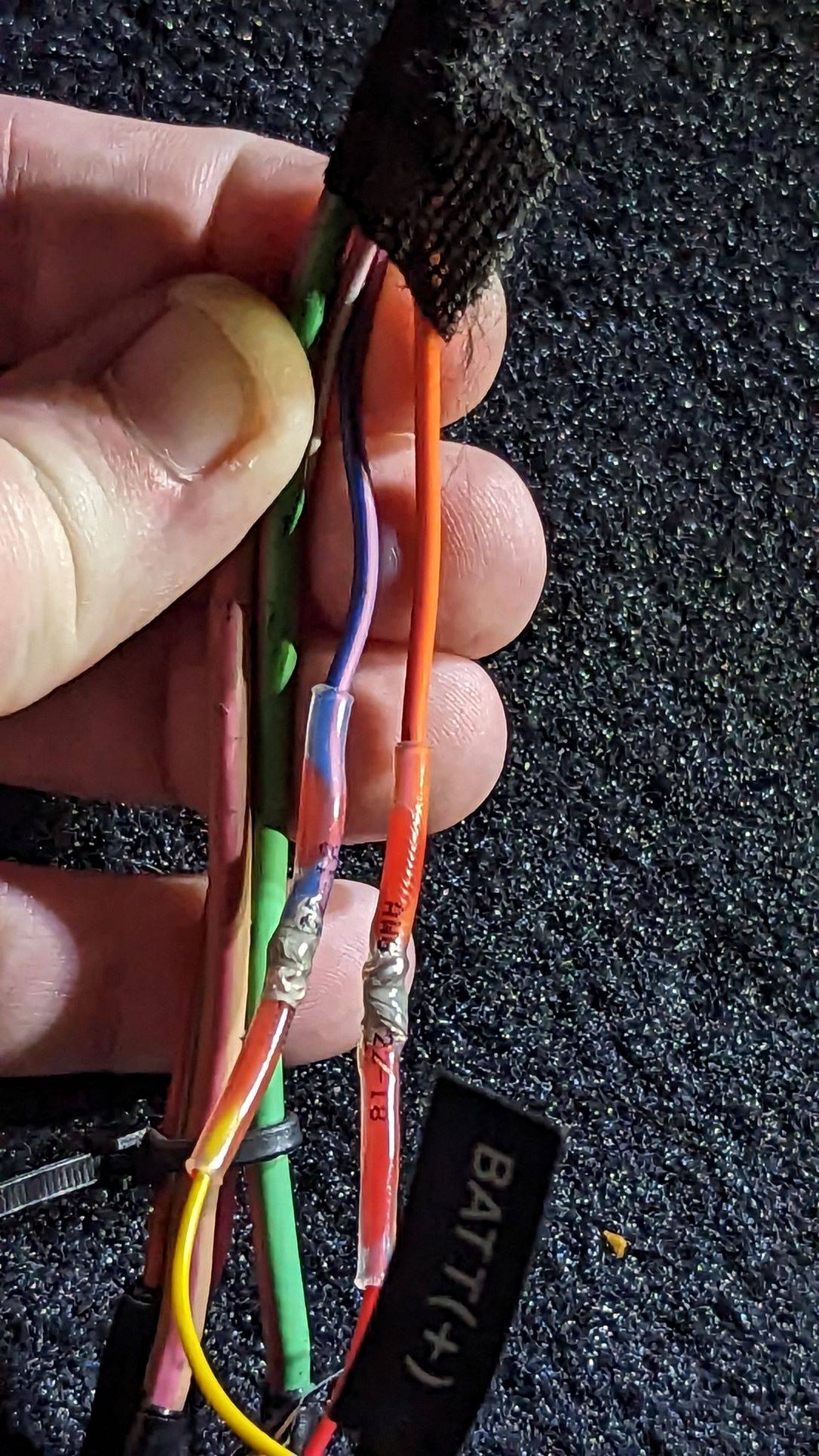

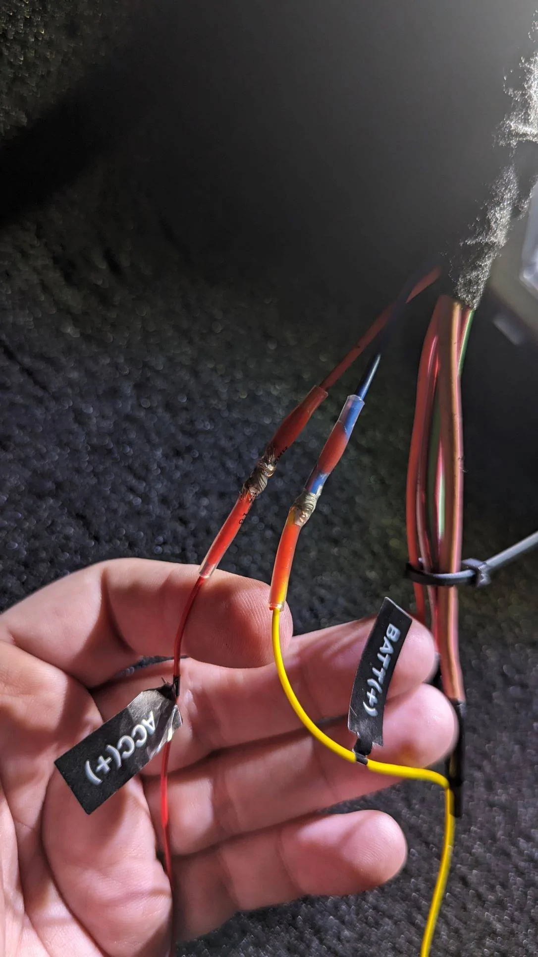

I have some questions about the hard wiring setup for using a dash cam using the factory AUX switches, or in another way if necessary.
Over the holiday weekend I installed a dash cam, specifically a BlackVue 900X Plus. We (Father and I) hardwired it, the Battery to the Blue/Pink (Ignition) wire and the Acc wire to the Orange/Pink (Aux 4). The camera however would only turn on if both Aux 3 & 4 were turned on. Which is very strange. At this point I turned off parking mode just in case and planned on troubleshooting at a later date. In hindsight I wondered if it should have been wired battery to battery.
The next night my Jeep was damaged by a drunk driver. The incident was caught by our home security cameras and the driver was arrested. However I regret not having the parking mode issue fixed.
The camera also came with a "cigarette lighter" power cable which I set up to test out if would power the camera for parking mode. I even turned off the battery saver option in the camera settings and it still did not record while parked.
Any advice or help to get this fixed is much appreciated.

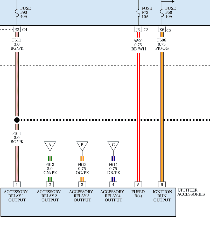

I don't think it is advisable to wire the camera to a switch, and the experience you gave is good reason.
The Aux wiring in the passenger footwell provides all that you need in a convenient place. I have my dashcam wired as follows, with a ground wire to an existing stud in the footwell. The cable is easy to run down the passenger side A pillar (remove the handle to pop the plastic off). There is a gap under the tweeter speaker panel to run the cable behind the dash into the footwell.
Fused Battery positive (B+) is the .75mm Red wire with white stripe. This will provide power to the camera at all times. It has a 10A fuse by default, but could be changed to a smaller one if you want.
Ignition Run output is a .75mm Pink wire with an orange stripe, that would hook to your camera's ACC+ cable. This will tell the camera when you're driving (to wake out of parking mode). This is also fused at 10A. (note this is often confused with the AUX3 output, which is the same colors and size but reversed as Orange with a pink stripe)

@Ratbert - I'll look through the tread, I did not see that. Very frustrating.
@Fudster & @BigMaCro - Thank you so much for the information and advise.
I currently have the cable from the camera through the A pillar and down to the passenger footwell. Ground is to one of the studs behind the kickplate.
I did consider the fuse taps, however they were sold separately so if necessary I was saving that option for last if all other options were exhausted.
If I am reading this correctly, I have the wires connected wrong. Mainly the battery (camera) which should be run to the red/white batt wire.

Wired the Batt to Batt and the Acc to Ign and ignored the AUX switches. The camera does go into parking mode now. Thank you.
