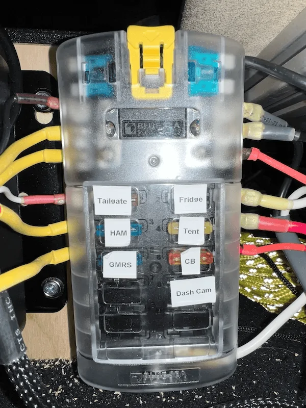

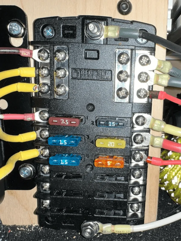

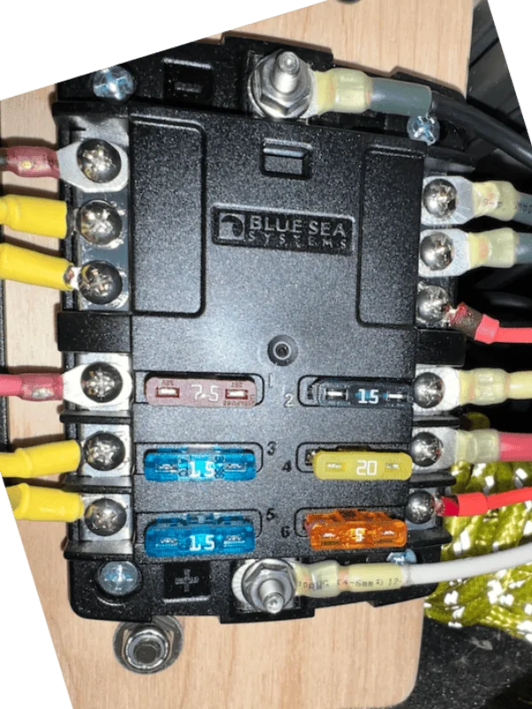

I suppose you're right. Since Parking Mode is built in on the "X" series, it makes sense. It's my daily driver.
I'll need to move up from a 6 fuse box to a 12 fuse box.
