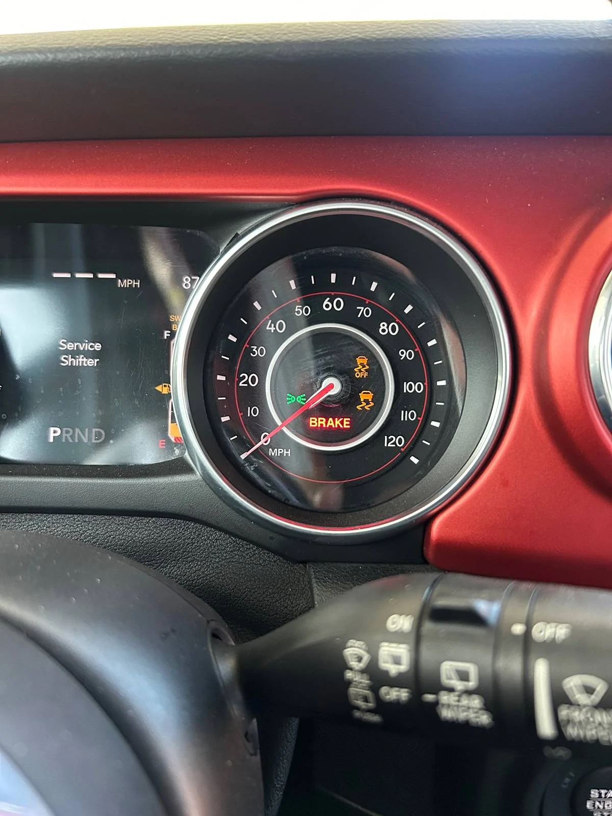

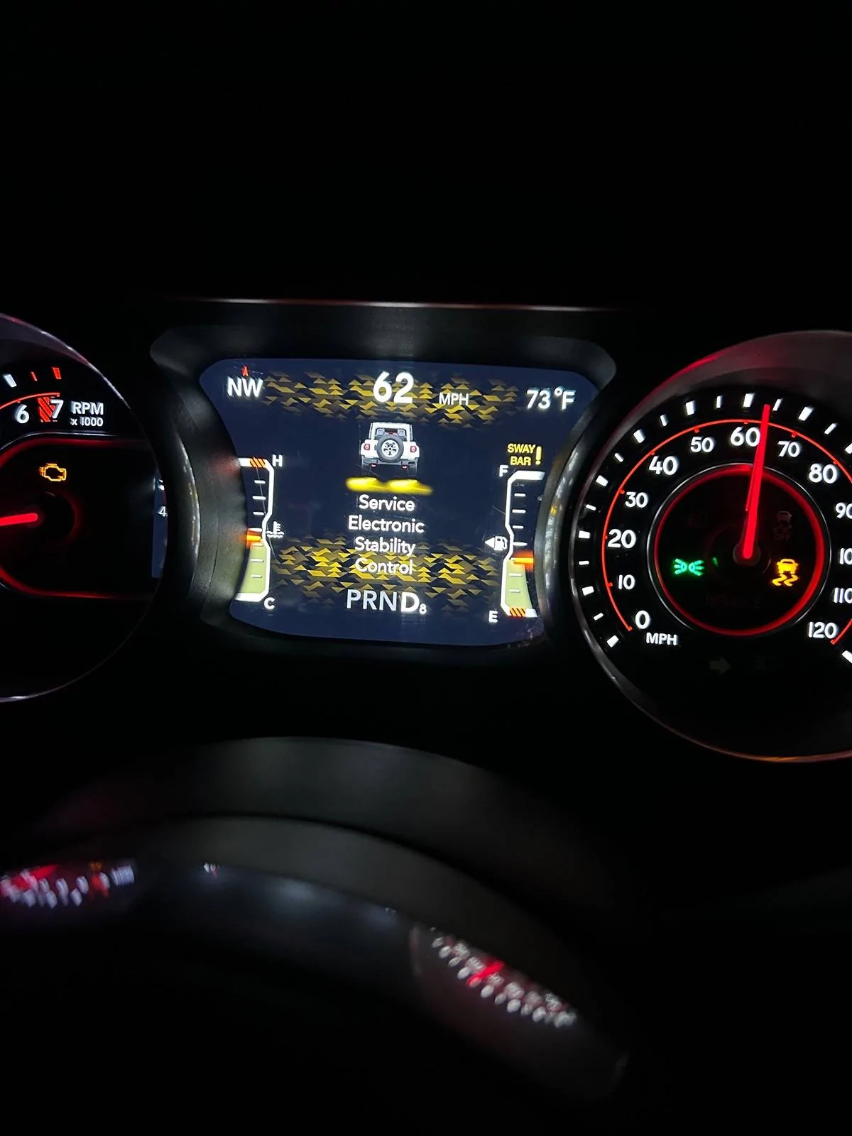

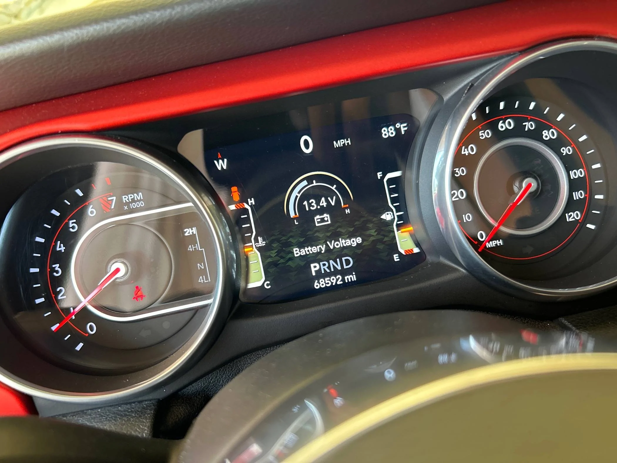

So about a month ago my 2018 Rubicon began to turn on the CEL, threw the scanner at it & it showed me a bunch of codes one of them being an aux battery code, I figured that maybe the aux was causing all of the other codes to go off so I went ahead and replaced it from the engine bay & not being to familiar with these things I burnt the N3 fuse out causing the vehicle to go into a panic mode anytime I would start it I went ahead & took it to a very good shop around the area that replaced my aux/n3 fuse/ & main battery we also tested the alternator which was good & yet the vehicle will still go into weird light attacks it’ll flash every light on the dash while running the dash shuts off & suddenly the day after every light will be off including the CEL ? We have gone as far as to to check the can bus & everything checks out, anyone who might be able to shoot some tips as to what else I can troubleshoot this is getting very frustrating & taking up a lot of my time as this is my wife’s daily driver & have had to arrange our schedules any help is appreciated.
