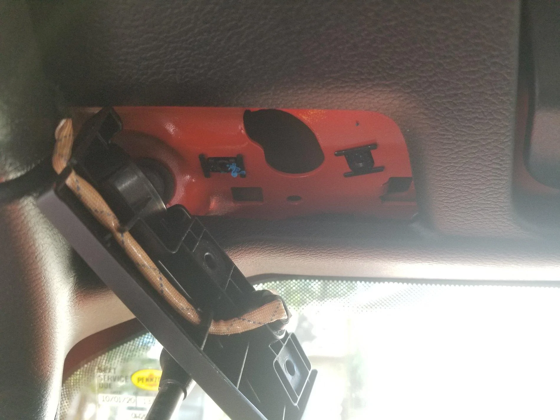

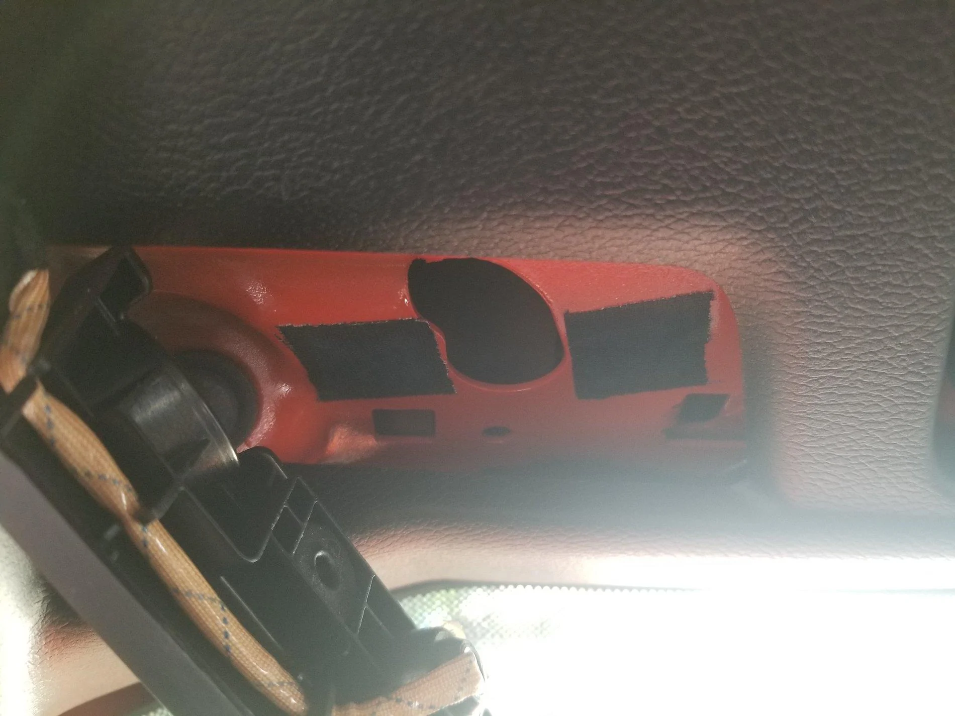

Update: Fixed
I tried a few things including the screws holding the visor on.
For the visor, I did find the screw retaining clips to be very loose and causing a similar noise when rattled by hand. I decided to gaffer tape the two clips down and put the screws back in (before and after pics attached)
This resulted in the rattle noise, but without the metal sound (almost muted).

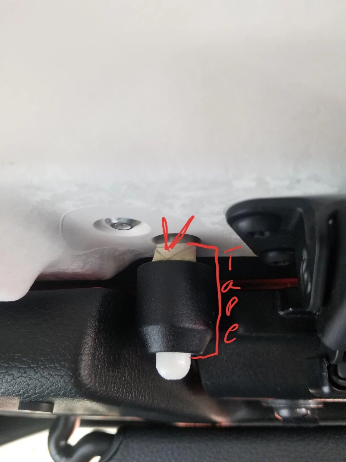

I finally tracked down the primary source to the hole for the freedom panel. The panel would vibrate resulting in it hitting the holder and thus the sound. Tape around the nipple for the panel fixed the issue (pic attached).
Hopefully this helps someone else out. There are many things that can rattle in a Jeep.
