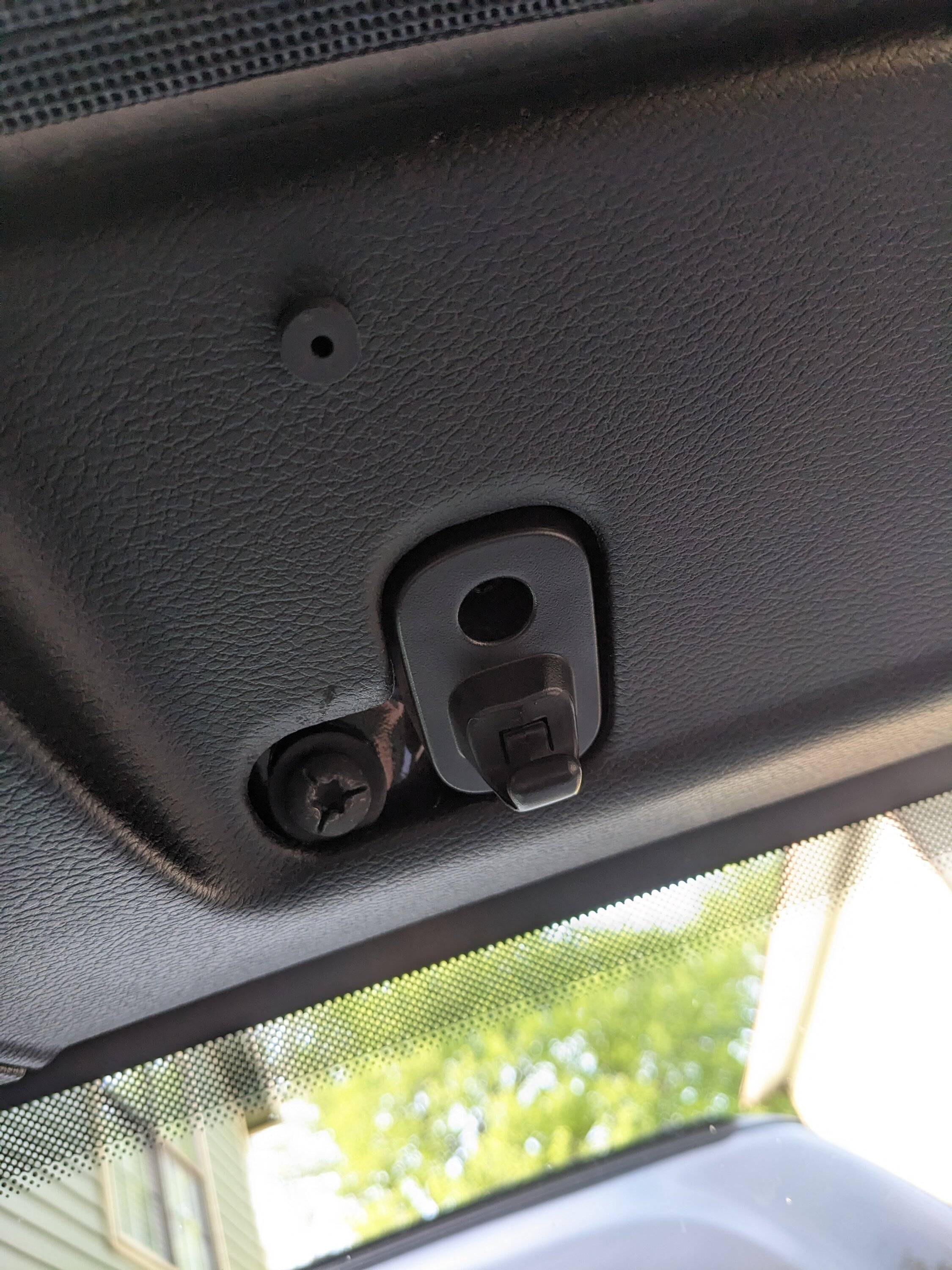

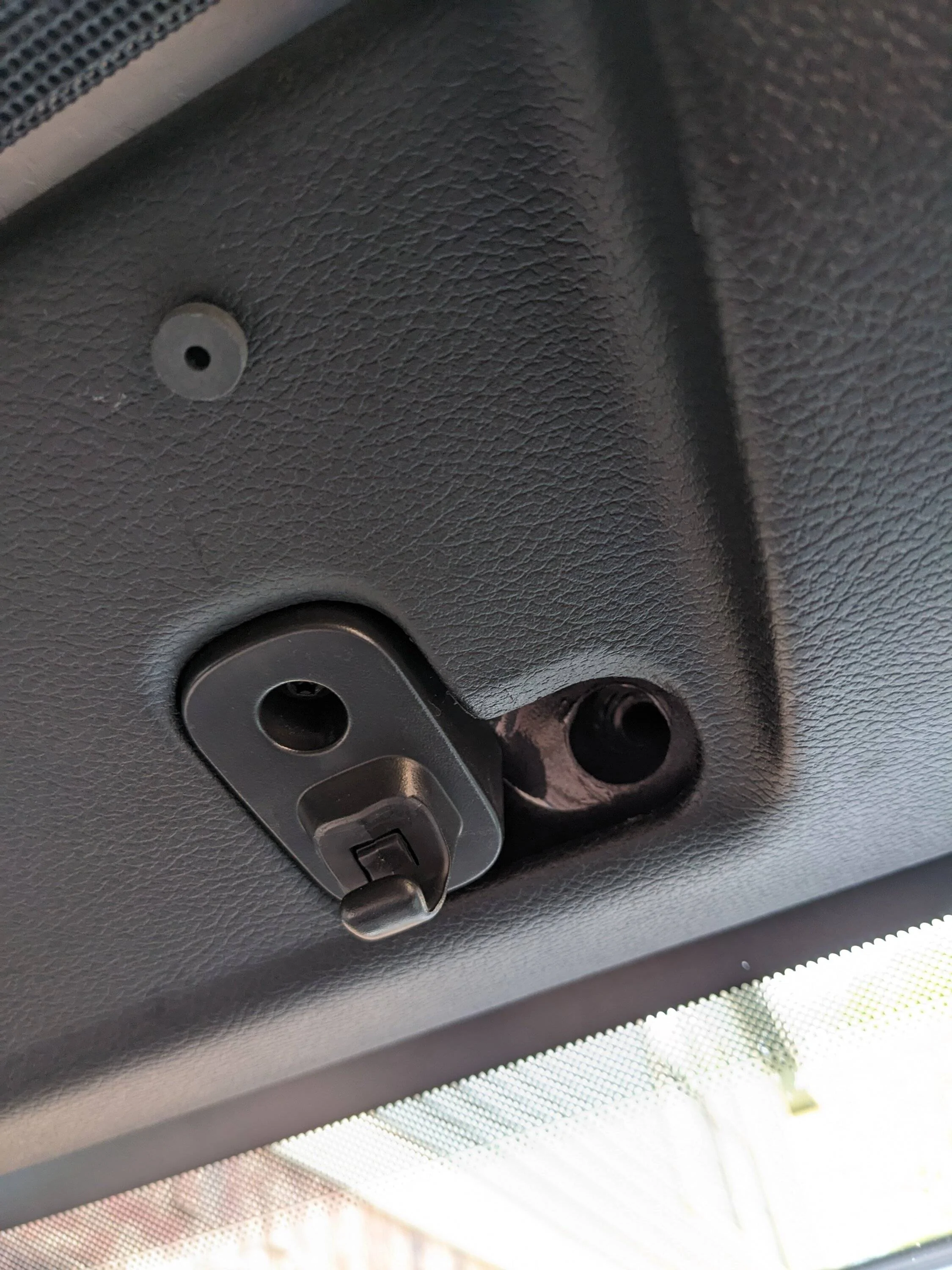

So I had this rattle too and this was the forum I looked to for an answer. Skeptically I was led to the visor. As soon as I unfastened and lowered the driver's visor, this bolt fell out. It had obviously loosened itself as all the other three were loose. That fixed.it.for me.
Jeep Wrangler JL Rattle behind dash - driver side PXL_20230312_214704016
Jeep Wrangler JL Rattle behind dash - driver side PXL_20230312_214706491
