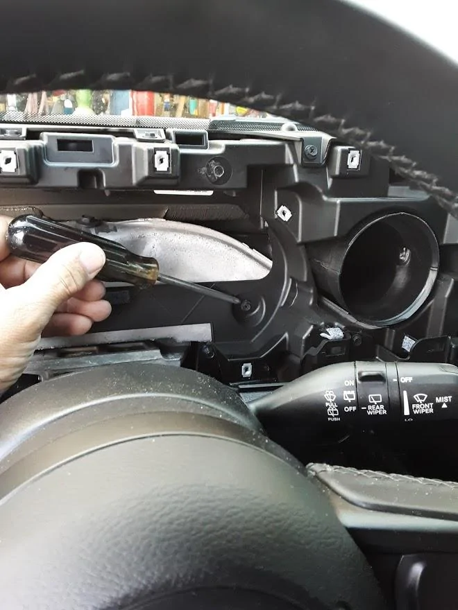

This is a photo of the dash after removing the speedo and tach instrument cluster.
What I found was that one of the screws holding part of the plastic dash frame assembly to the aluminum bulkhead in the dash was very loose.
Below is a photo showing the culprit loose screw that I'm pointing at with a screw driver. I applied some RTV behind the heads of the screws and tightened both.

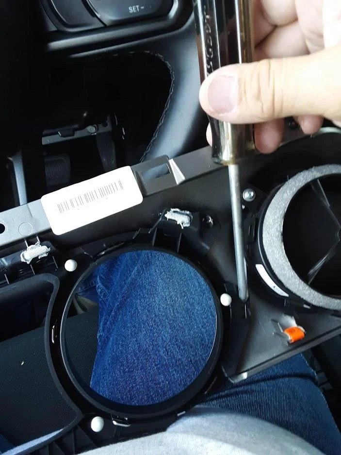

I further found that the dash cluster bezel is made up of multiple pieces of plastic that are put together by sort of melting them together after inserting one piece through the other with tabs through slots. I found one of the tabs was broken and just barely hanging there.
So the broken tab caused the two pieces of plastic to vibrate against one another.
In order to fix this issue I just spread some RTV on the broken area and any other loose areas I found that could possibly cause a rattle in the future.

Below is a photo of the broken tab I found in the dash cluster bezel.
