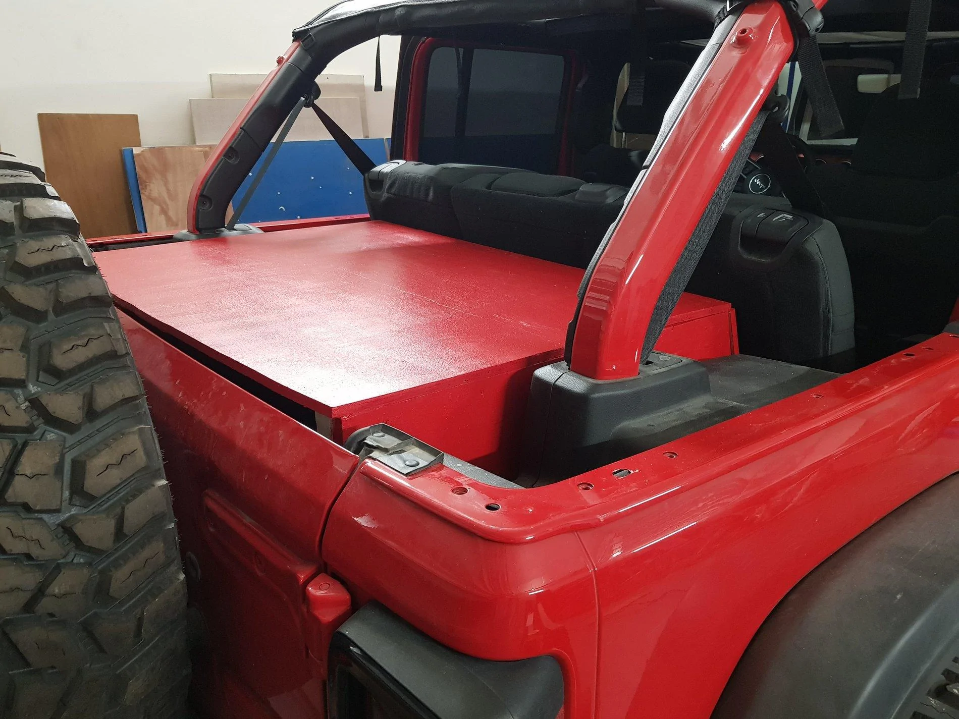

Thank you. I'll definitely post photos when I eventually make the aluminum version. I think when I make a finalized aluminum one, I may sell a few. It depends on how cost effective I can make them, and how time consuming they are to produce. To really blow everyone's minds I could have the aluminum anodized in natural, blue, red, black or pink. I'm sure there's some Rubicon owners who'd like a red enclosure.

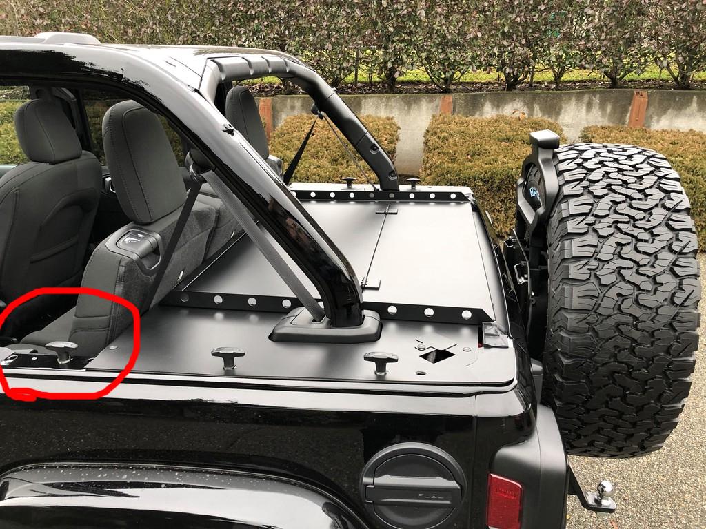

The problem with a box is that it wastes a lot of space unnecessarily. The others, like Slipstream have a solid idea, build a complete cover and a back wall.

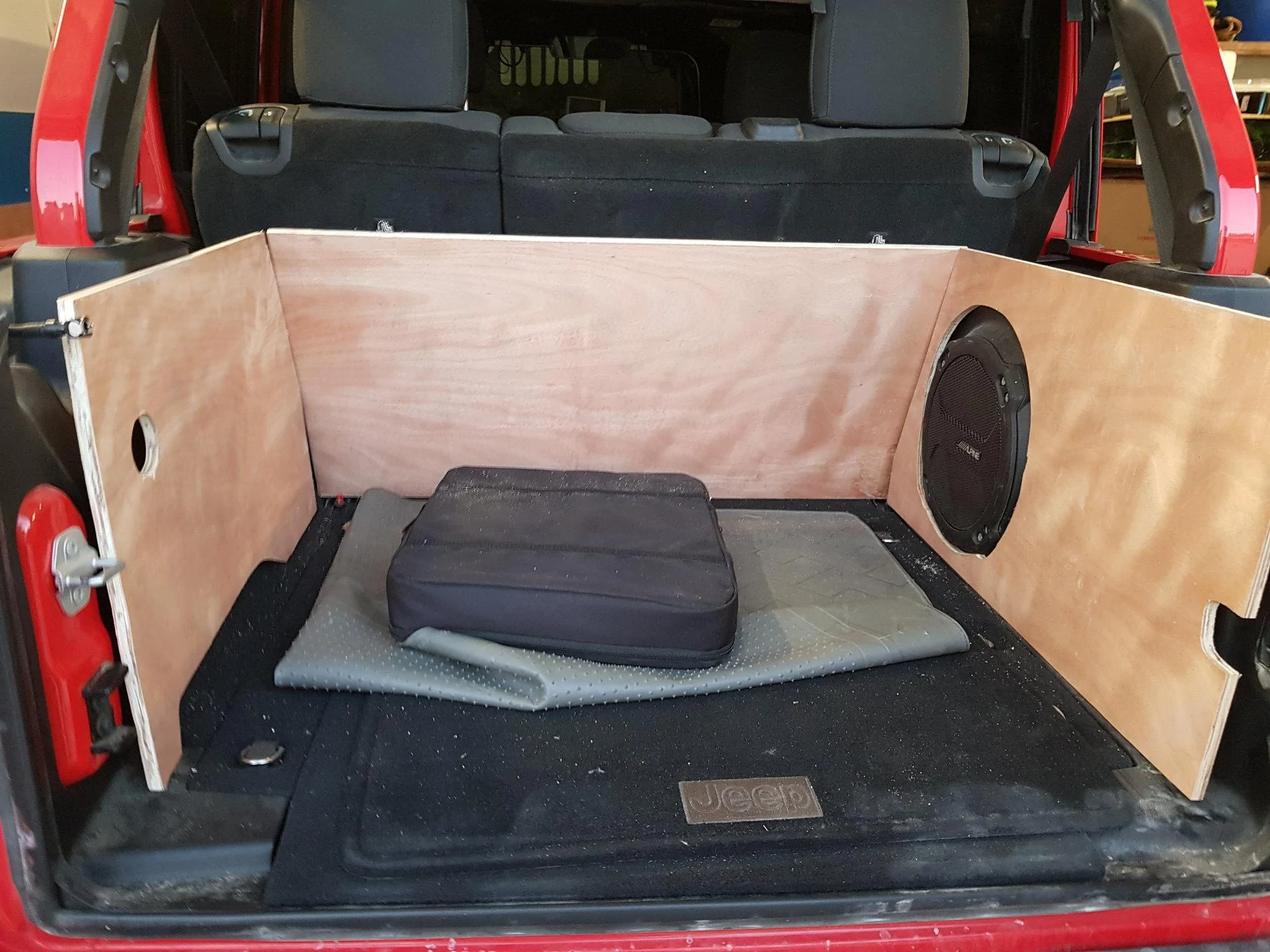

I looked at Slipstream's product. The two main problems I had with it were the price (outrageous), and the gap it leaves at the front of the tub. At a thousand dollars that thing should not have a gap at the front when the hardtop is put back on.
Jeep Wrangler JL Custom cargo "security" enclosure for under $100 gap-
As for wasted space with the box. There's not really much loss if you make it collapsible. The only space I'm giving up is about an inch worth of width where the panels sit against the walls. On an aluminum version the panels could be made thinner, so the lost space would likely be 1/2" at most. So a custom made enclosure, or a Tuffy enclosure don't waste as much room as Diabolical wants you to think it does.

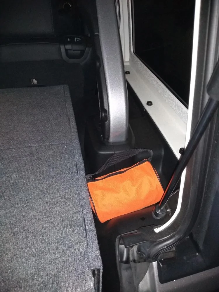

If you're referring to the gaps on the side where you "lose" space between the box walls and Jeep walls (over the wheel arches) I actually find that space MORE usable now. By having the box walls there I can actually put stuff in the created "pockets" rather than just having shelf at the side of the enclosure. Set anything on the arches without a wall and it's never going to stay there. Wasted space.
I keep an old hoodie and a few emergency lights tucked in my wall pockets. Nothing super expensive in case I have the top off and they disappear, but that's no different than anything left on the floor or under the seats with the top off.
That was my problem with it too. When you compare it to Tuffy's enclosure too, which is about $200 less. I just dunno. I think both products have a huge markup on margin there. I bet both are close in cost to manufacture.
And I am unsure about the strength of the top of that thing when carrying a 100lbs + cooler. Might be able to carry some sleeping bags and stuff under a net, but I really wonder about the strength of it. I considered the Slipstream good and hard. But eventually passed on it.
Also, that does seem like an oversight in the design by not going all the way forward. Just looks incomplete.

Yeah, I actually built one similar to the jftops design before my current enclosure. I used it briefly, and designed a rail system to mount UNDER the tub rails so the top could go on/off with it installed. It worked well, but the problem was it couldn't easily be taken on/off to haul anything tall. I considered making it a more modular design that could fold, or come out in more than two pieces, but doing so really weakened the design. If you're a top off all the time kind of Jeeper, it's a great concept.
I'll see if I've still got my CAD designs for the version I made. If so I'll post them up so people can make their own.

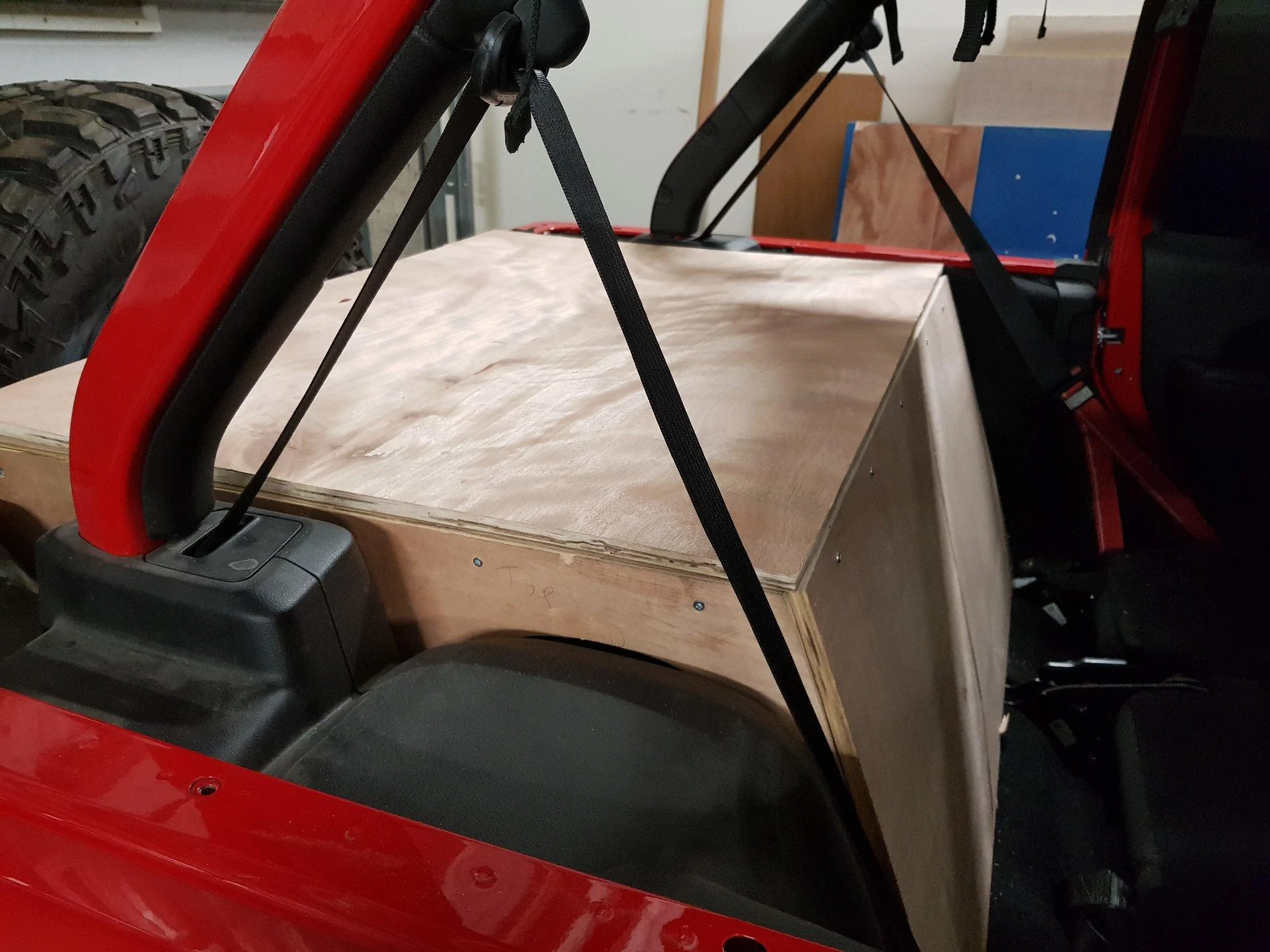

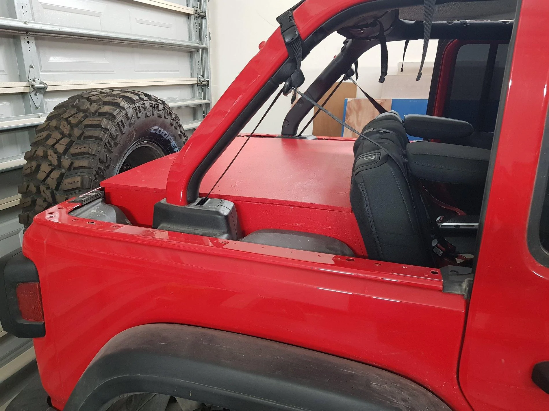

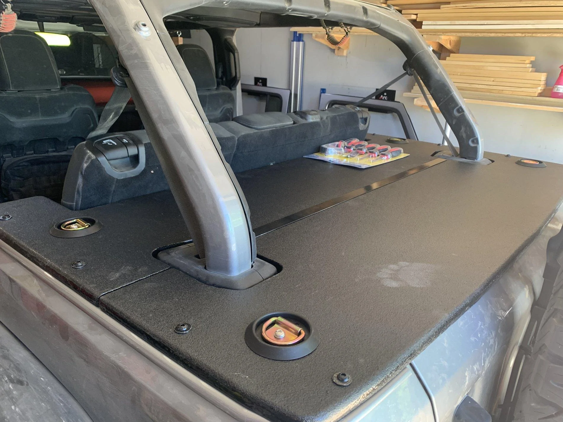

Started my copy. Not as nice but it's a work in progress. Also trying to time lockdowns to find everything isnt fun.
Jeep Wrangler JL Custom cargo "security" enclosure for under $100 20200512_180835
Jeep Wrangler JL Custom cargo "security" enclosure for under $100 20200512_181133
Jeep Wrangler JL Custom cargo "security" enclosure for under $100 20200512_184106
Jeep Wrangler JL Custom cargo "security" enclosure for under $100 20200513_220405
Jeep Wrangler JL Custom cargo "security" enclosure for under $100 20200513_220411

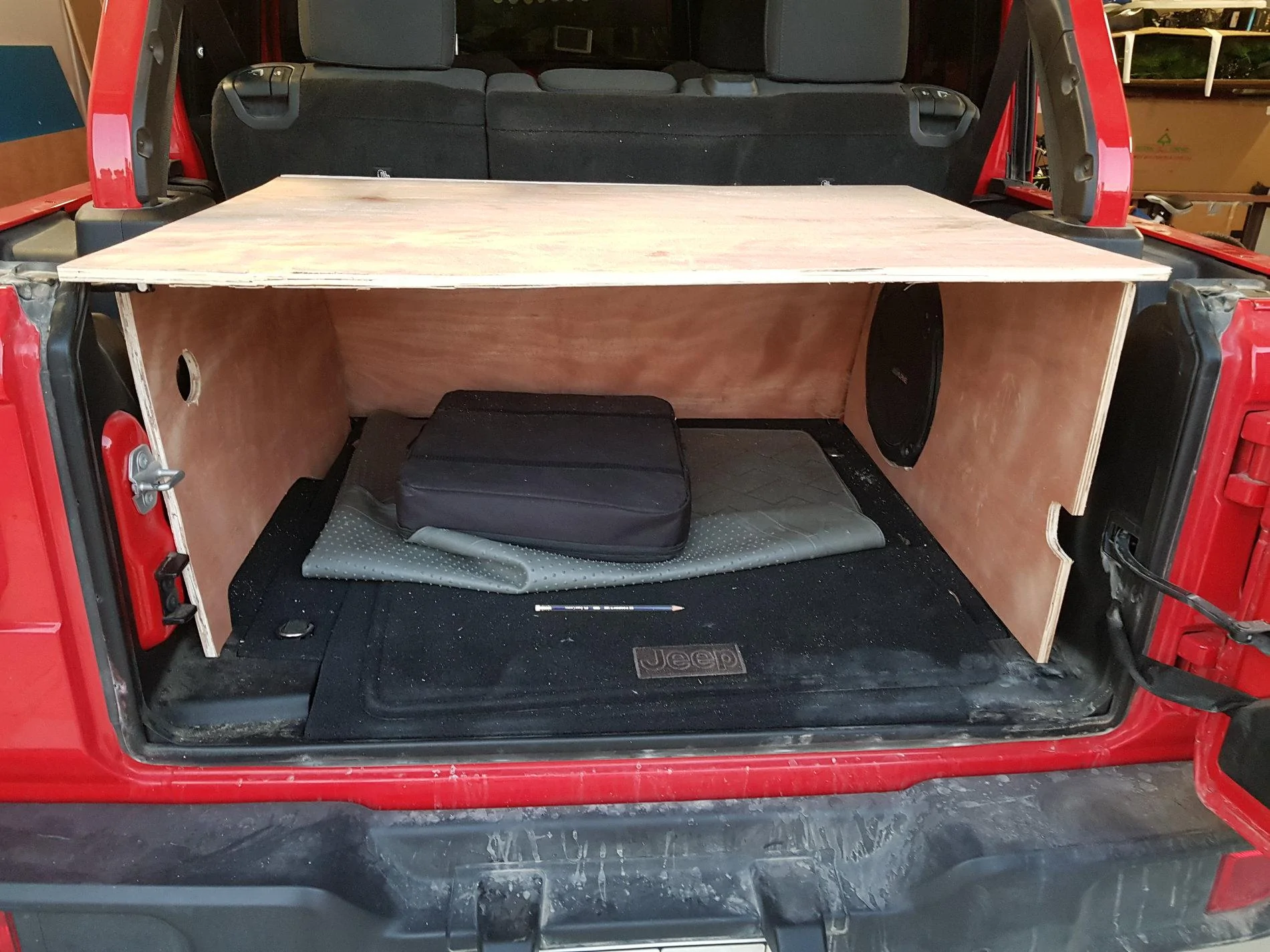

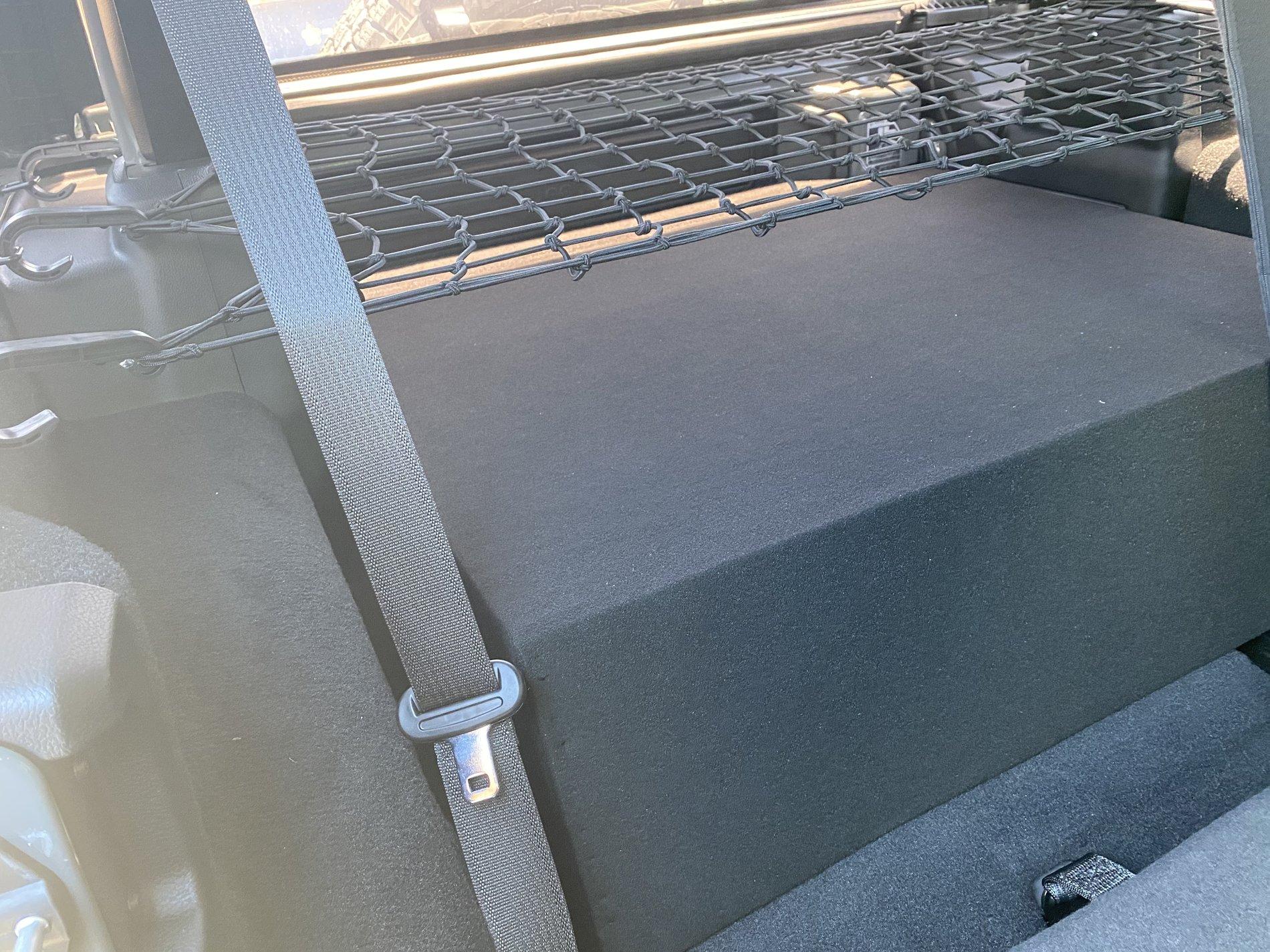

Us soft top owners got the shaft! Hard to find a rear enclosure that sits low enough for the top to sit flush when down but still remain high enough to stuff a couple moving blankets and the computer bag underneath. So made my own. Thanks to others for eye-bolt locking idea works like a champ and with the tint, hard to tell from outside that it's not just the truck. Sits up about 9"
Jeep Wrangler JL Custom cargo "security" enclosure for under $100 IMG_2456
Jeep Wrangler JL Custom cargo "security" enclosure for under $100 IMG_2454
Jeep Wrangler JL Custom cargo "security" enclosure for under $100 IMG_2455
