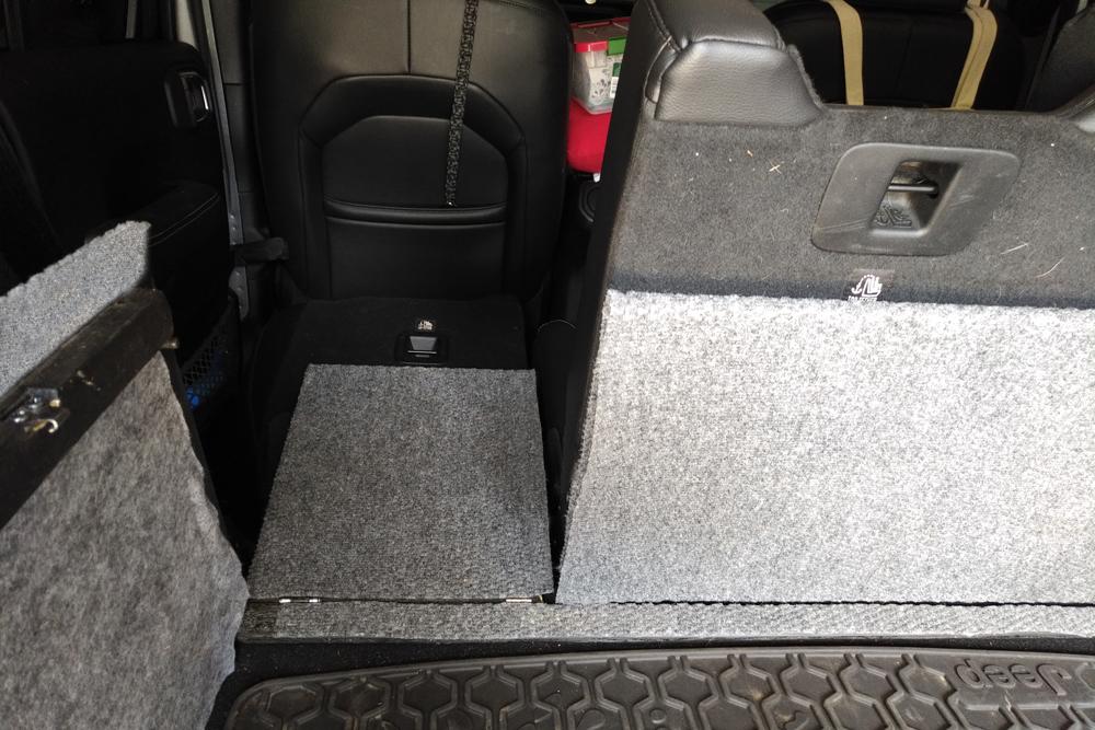

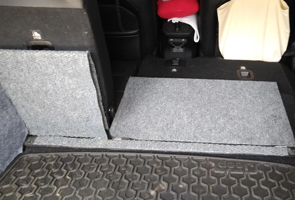

Okay so I went very basic on the process of splitting the front panel. I pulled the carpet back, I added a set of hinges to the medial portion of the panel, and then cut a roughly 3/4" gap at the seam of the seats. I laid the carpet back down with the newly cut edges hanging "loose" to cover the new gap. With both panels up the gap is barely noticeable. With a single panel down it looks a bit sloppy so I may wrap the carpet to give it a more finished look. I'm undecided, because wrapping it then exposes the gap, which may look sloppy too.
In the mean time, here's a few photos of the development of the current revision. Now that I may have a final revision, I'll have to get around to making a production version with PVC or metal.
PS. Please excuse the background clutter I was randomly getting stuff out of the way while I worked.
