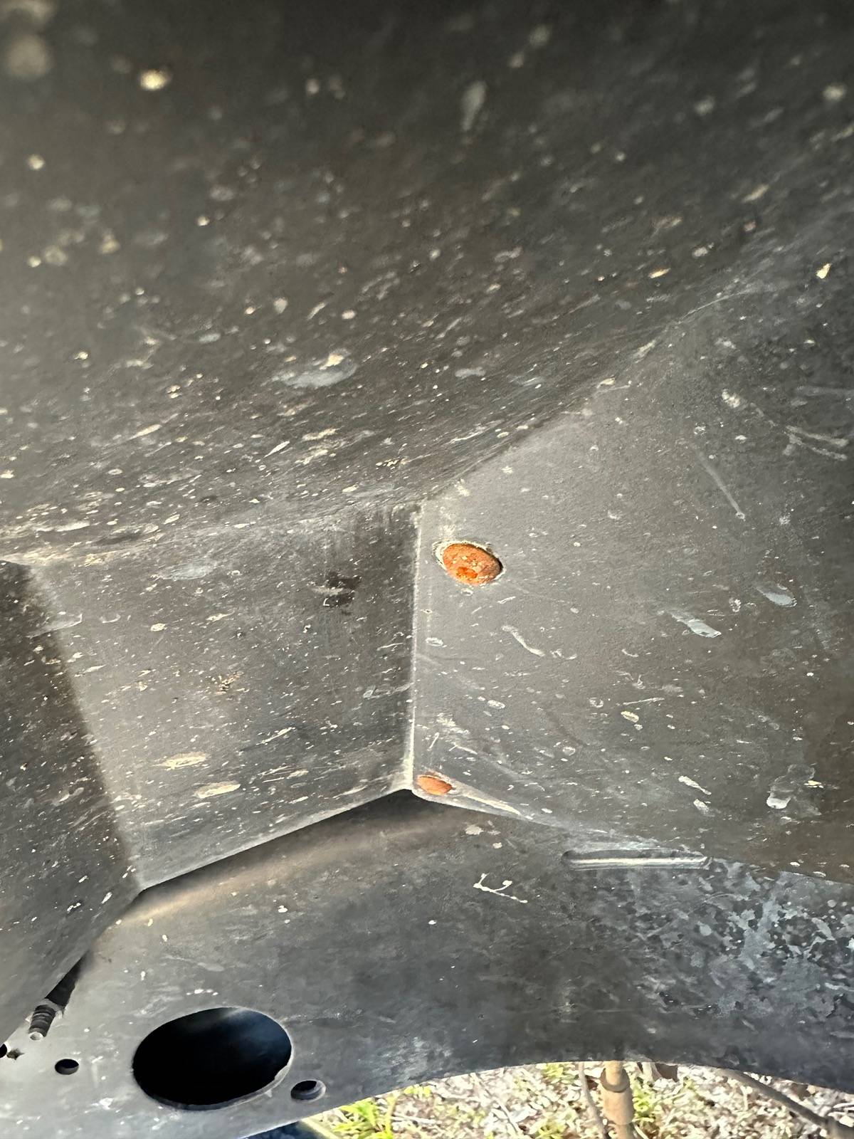

Every once in a while Amazon bites me in the ass….:headbang: …… I ordered some 1/4-20s for my inner fenders. I ordered black stainless and you know how it is, in a hurry, but just scrolled till I seen what I was looking for and swiped buy now…..
Well that’s not what I got…..🤬
Jeep Wrangler JL Crystal Rubi build… IMG_0060

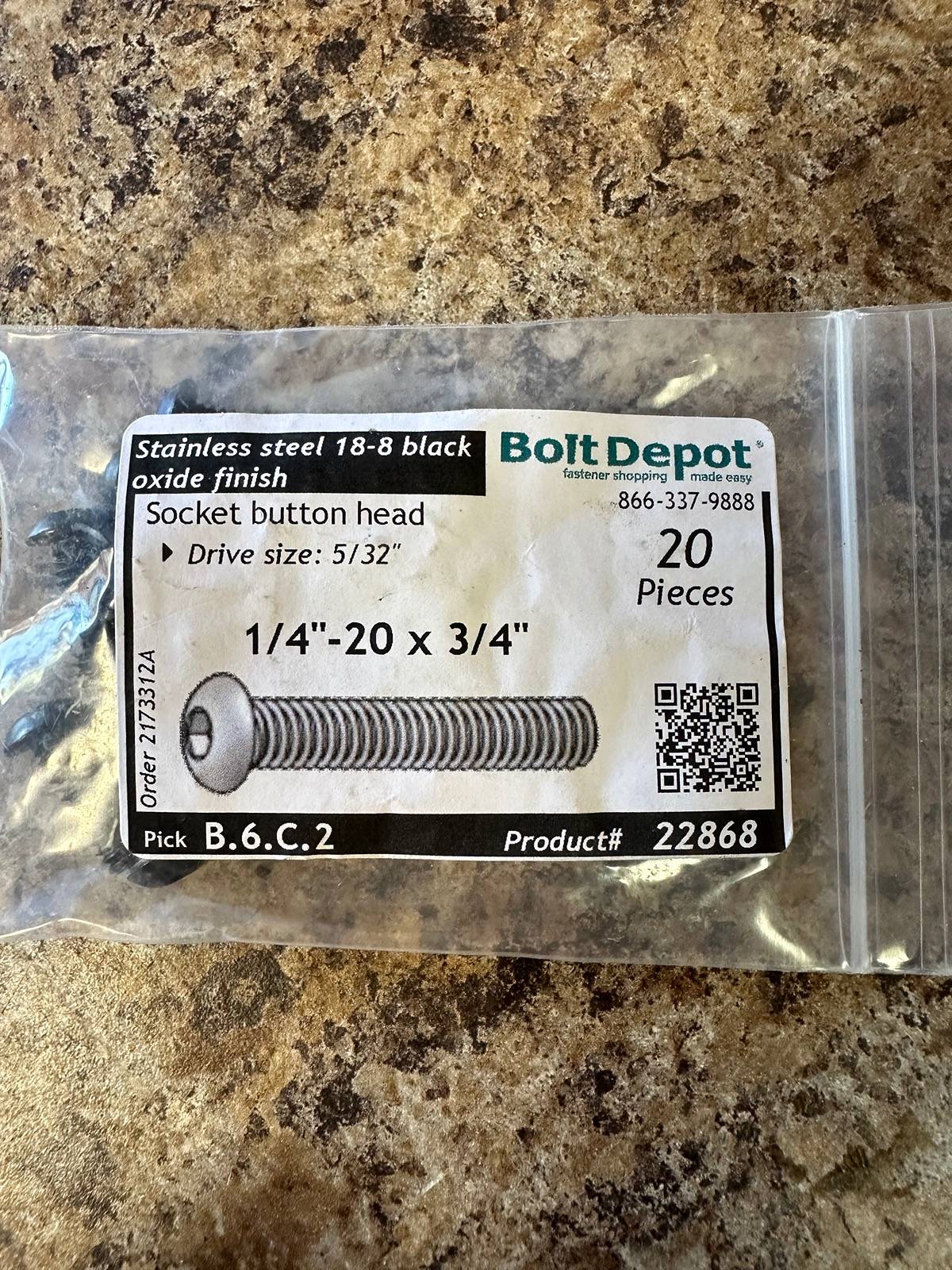

I mean, I don’t keep my rig pristine, mall/starbucks clean all the time, but rust is a different story….. I hate rust, makes it look like I don’t give a shit, when in fact I do ! My rig is spoiled rotten……🤣
Anyway, I’ve decided if I can’t source what I need locally, I’m only gonna use the Bolt Depot….. @hoag4147 turned me on to them when I needed new flat head body mount bolts because my rear lca was contacting the oem’s at full stuff…….Been using them for other bolts ever since, but, in a hurry, to easy to swipe “buy now”, blah blah blah, you know…….😂

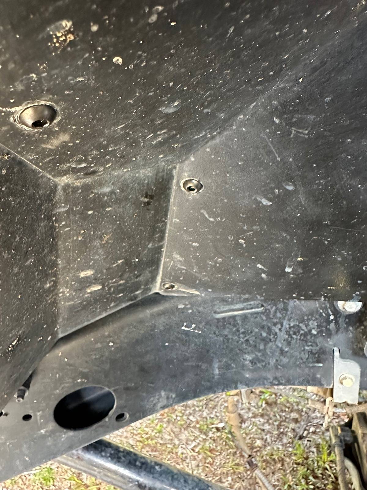

TLDR…. Got new black stainless bolts for my inner fenders……..🤣
Jeep Wrangler JL Crystal Rubi build… IMG_0061
Jeep Wrangler JL Crystal Rubi build… IMG_0062
The main reason for this post was to put up the link…..✌

Got to love bolt depot 👍🏻. When I was searching for a specific bolt for my Fox ATS they seem to have EVERY combination of size/color/thread/material, etc you could want.
looks great brother 👍🏻

Thanks man…. Yeah absolutely, I’ve got an account there now, lol…..

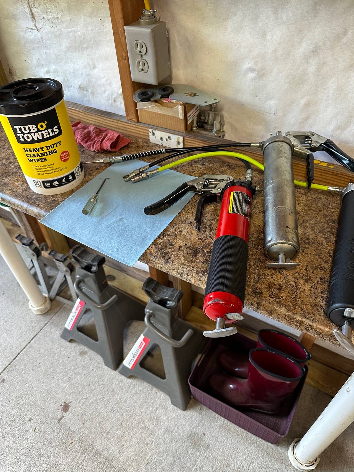

Grease day! 👨‍🔧 …..3 different grease guns, 3 different grease's, 3 different grease fittings….some tub-o-towels, grease rag, and a 90 degree pick……

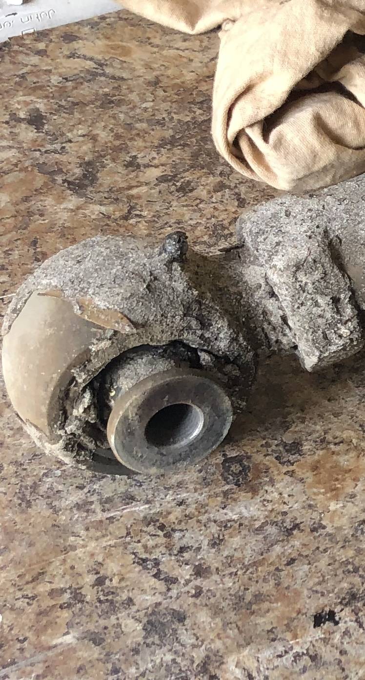

Here in Sand Land sometimes the zerk gets so covered you can’t even see it like this….
Jeep Wrangler JL Crystal Rubi build… IMG_5703
I found it’s best to clean the zerk and use the angle pick to push the ball bearing in a couple times before applying the grease…..
zerk check list….
Lucas green grease:
Ball joints
RCV axle shafts
Driveshaft
Sector-shaft brace
Red & Tacky grease:
Drag link
Tie rod
Mobilux EP1grease:
All 7 control arms
Both track bars
Rear sway bar links
I got it down to 20 minutes, I do this twice a year, easy peasy….✌

Hey brother, I typically just use Lucas Red & Tacky for everything. What’s the advantage to the green one? Maybe I should be changing things up.

Hi Victor,
No need to change anything….. I just started out using the Lucas X-tra heavy duty grease on everything, then when I got my RK Pro X tie rod and drag link they recommended Red and Tacky, thus the 3 different grease’s…. I have to use grade 1 grease in all RK control arms and track bars……

Roky, you might try Mystik JT-6 High Temp Grease as an alternative to R&T. I absolutely hated how every time I picked up the grease gun, red oil ran out. That doesn't happen with Mystik and they are nearly identical looking at the sds.
