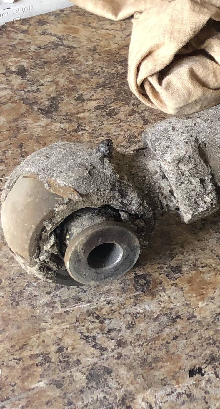

Here in Sand Land sometimes the zerk gets so covered you can’t even see it like this….
Jeep Wrangler JL Crystal Rubi build… img_5703-jpe
Man, I’m not sure how you are not replacing every joint constantly in those conditions 😮
Yeah, I always spray everything off as soon as we get home…. But the sand is a bushing killer if you don’t keep up with it…..

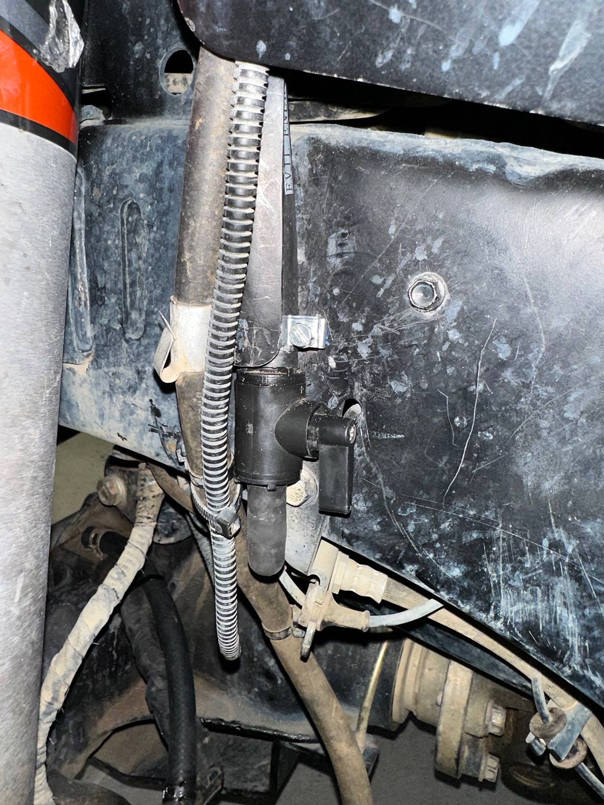

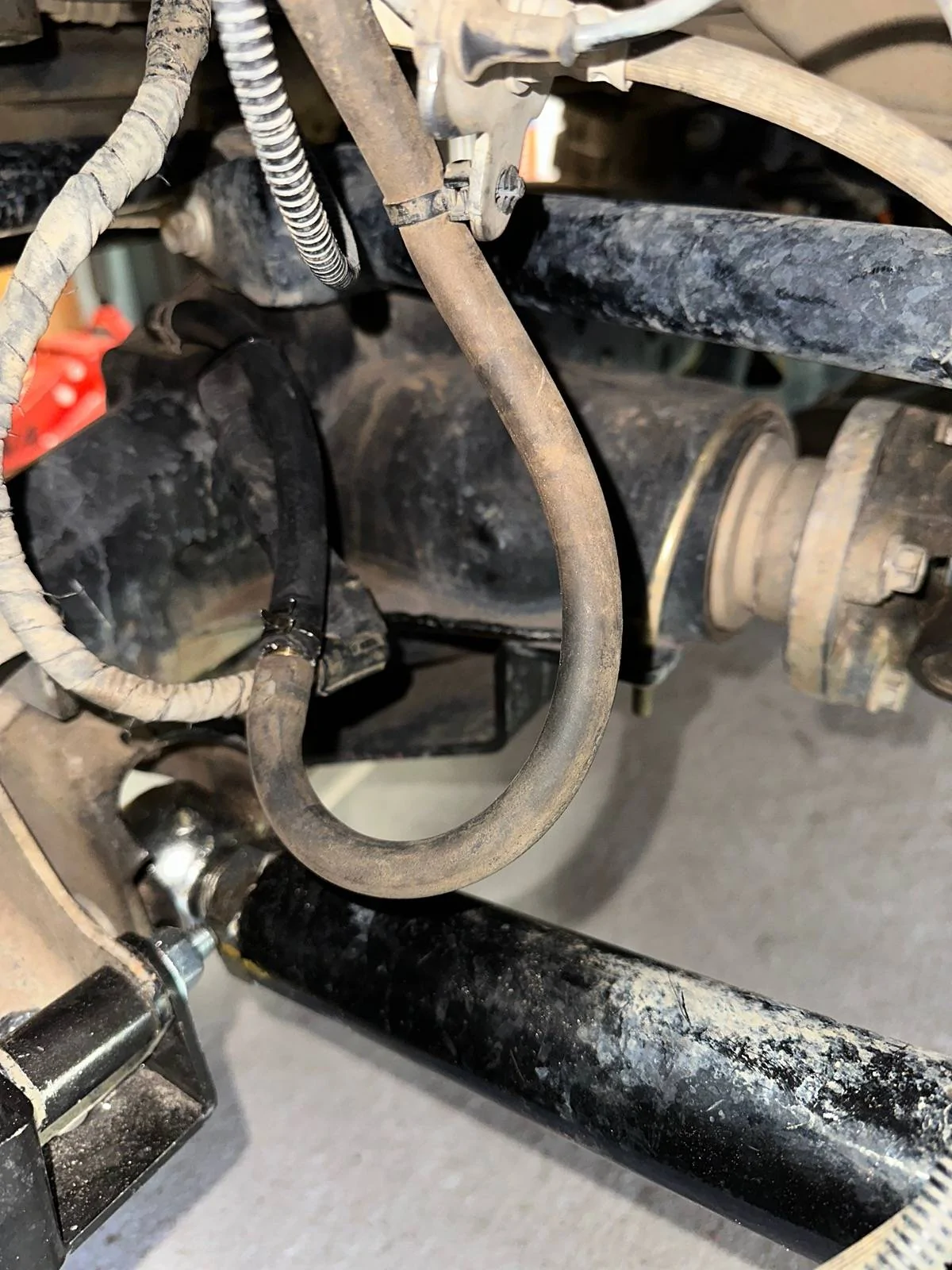

Couple little things been putting off, for no good reason, just seemed to get pushed back, lol….. I extended my drain on my catch can so I don’t have to raise the hood to drain it, also hoping I’ll remember it better, 🤣 …..Also extended my diff breather, it was getting pretty tight at full droop…..

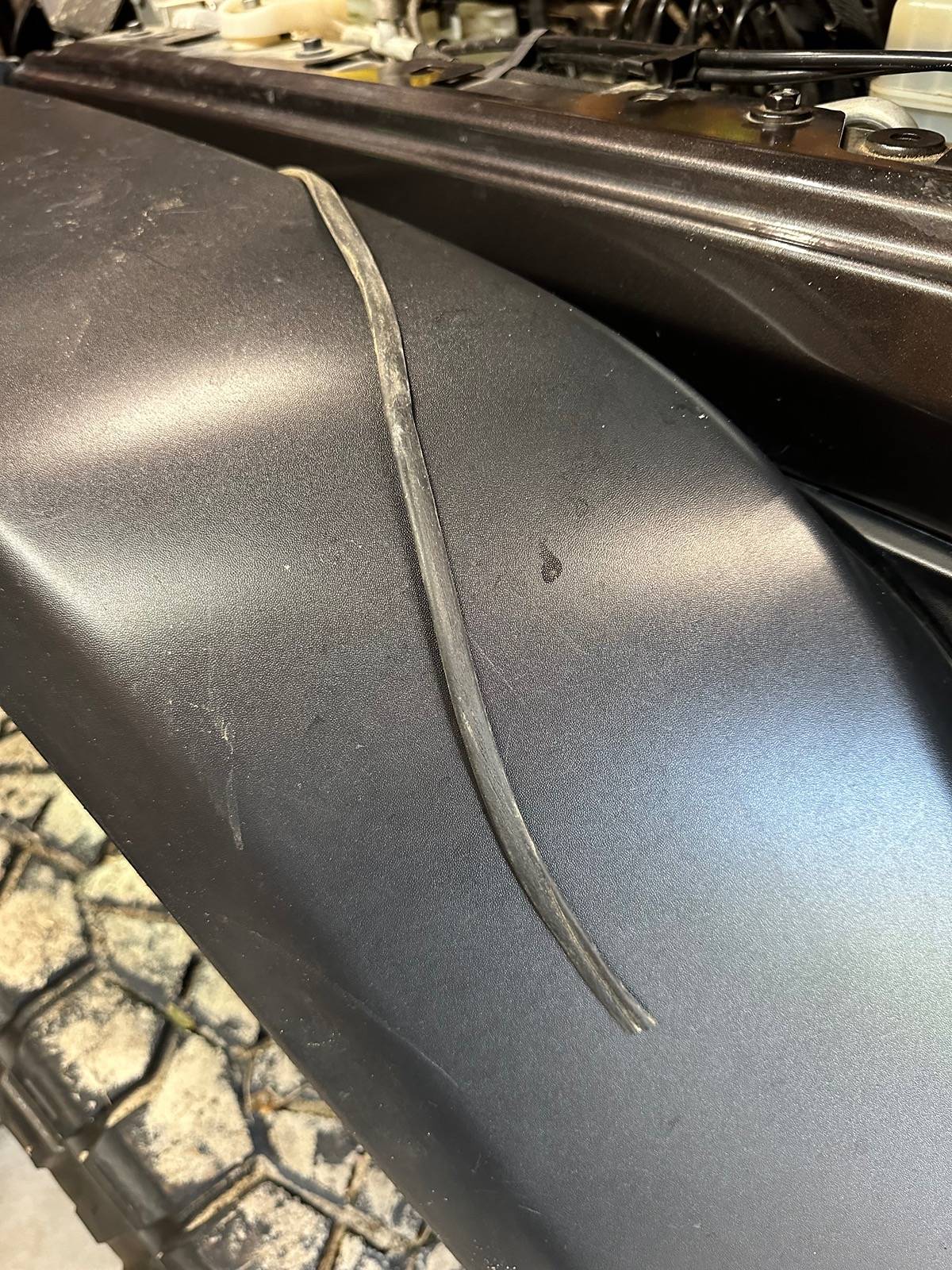

Had to remove the fender flare to get rivtool in and this fell out…I had forgotten all about this being in there… 😂 …For the noobs, this was a must do, all the rage back in the day, rubber tubing to keep debris from between fender and body….Believe me, this was definitely first world problem back then, you just weren’t cool if you didn’t have it………😂 Been in there 6 years, I guess I’ll leave in there…..😂

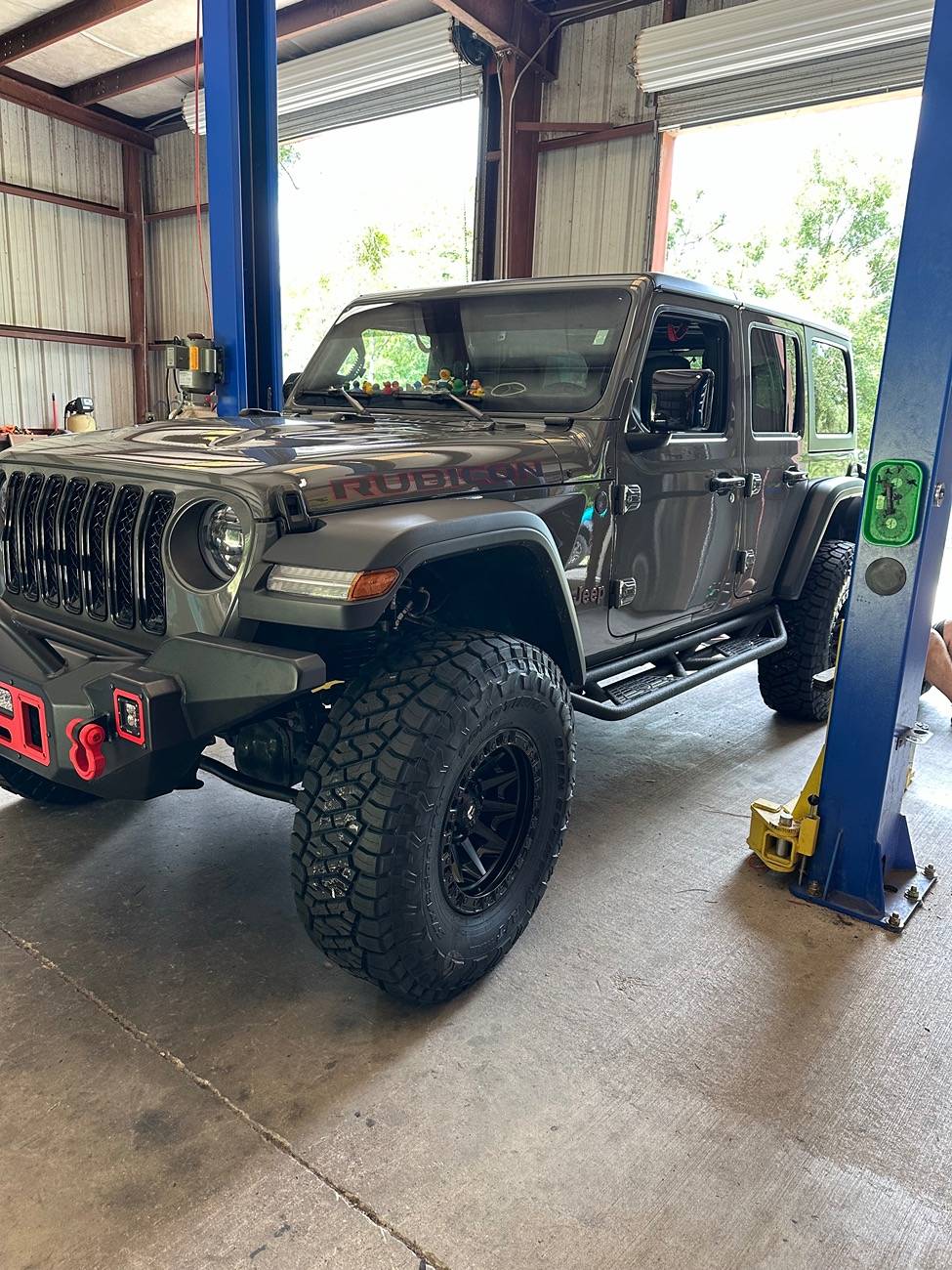

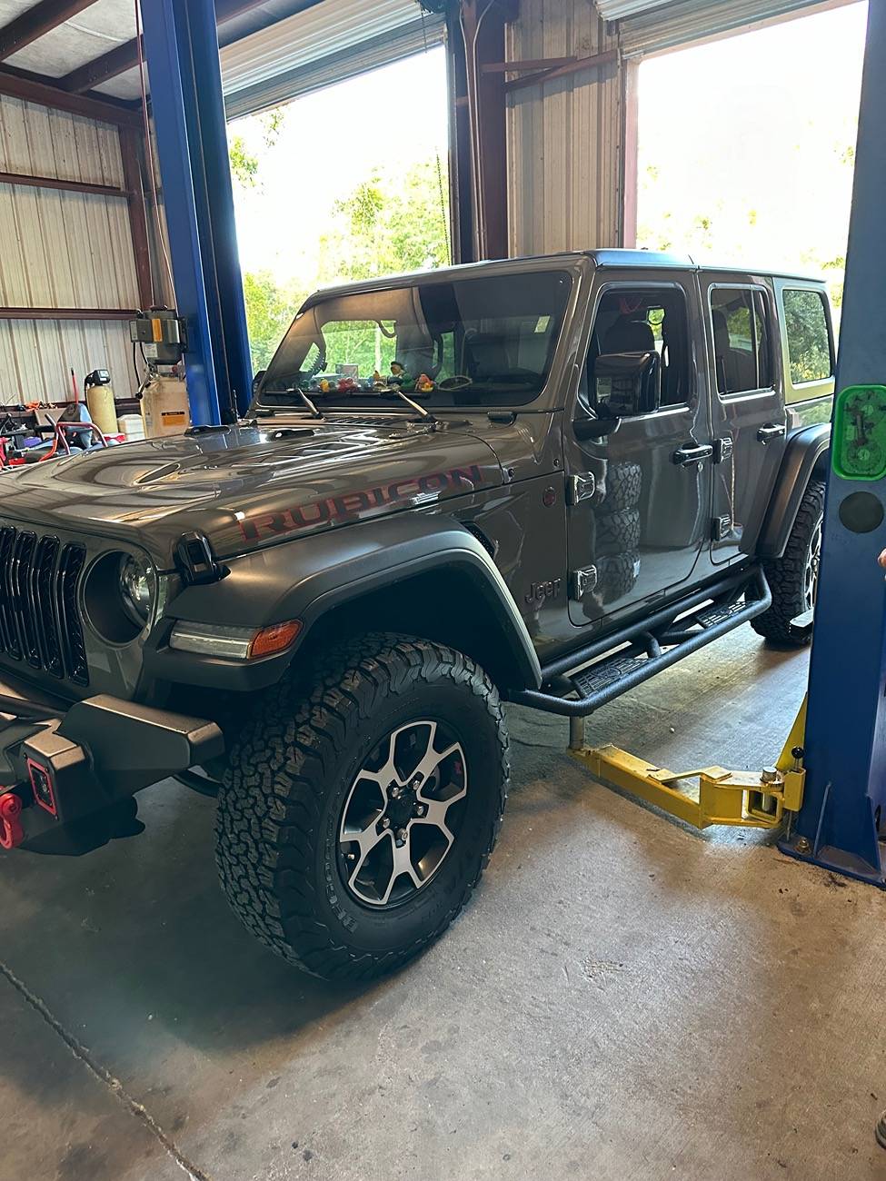

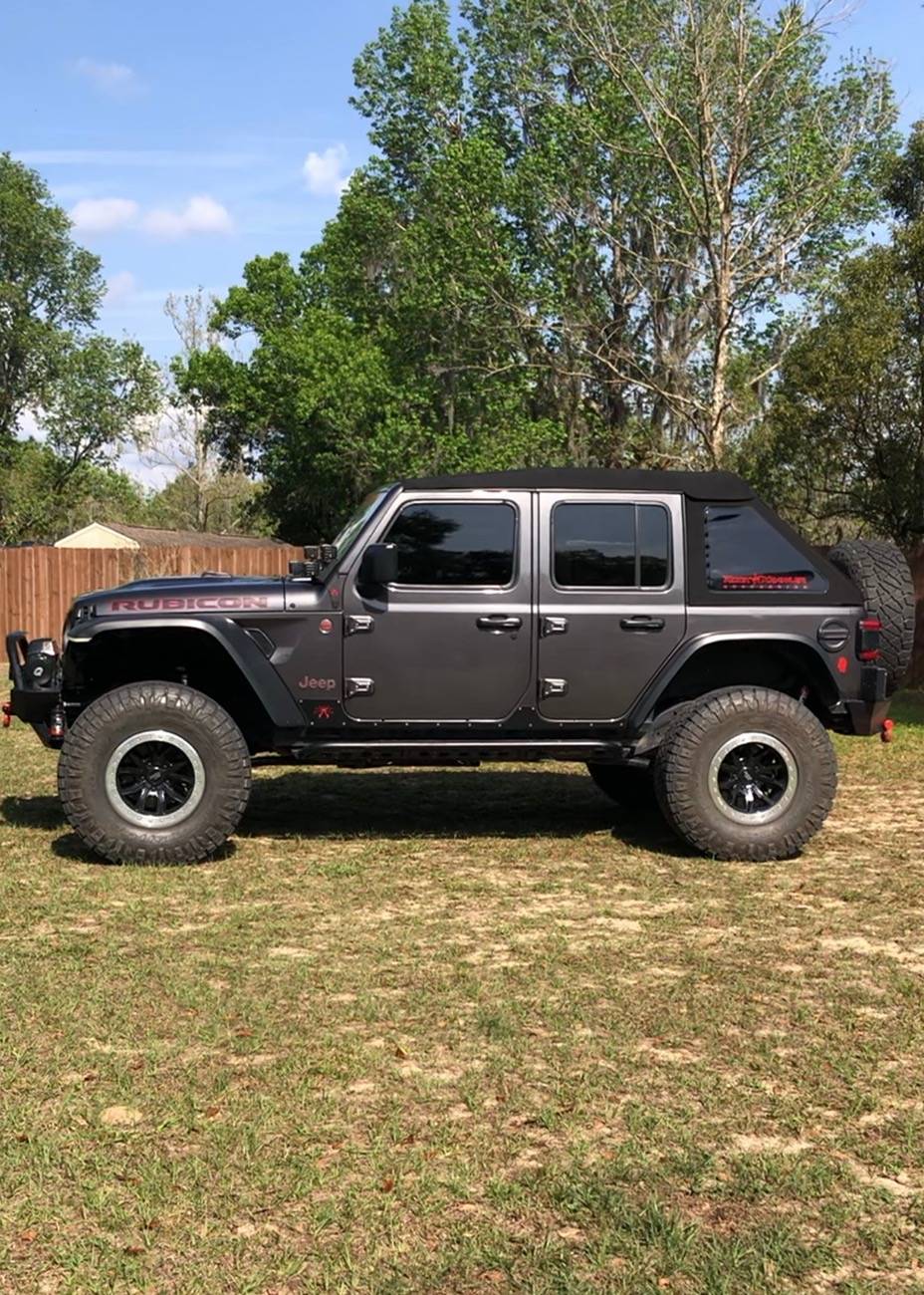

Nothing new with my rig, but had a good day….. put an Icon stage 5 2.5” lift and 37s on a buddy’s 2023 Rubi…. And my other buddy’s 2020 Sport S got Rubi take offs and wheels and tires……
I have to say I was pretty impressed with the Icon lift…. They cover all the bases for geometry and use I/2 “ front/ rear coil spacers for passenger side lean… Adjustable Remote Resi shocks were beefy, and well built…… the actual amount of lift was 3.25” but the front/rear adjustable track bars were preset and were spot on, axles were dead center……longer fixed control arms gave it 6.1 degrees of caster…Pretty sweet…
Super smooth ride on road, off road TBD…. Durability/longevity also TBD……
The Sport S got 2” of lift from the Rubi takeoffs.
I told him to get some Mopar lift lcas coming…Also he experienced DW yesterday, track bar was shot…..I gave him my old RK track bar, which I just rebuilt, and I also gave him my old Fox IFP steering stabilizer, so I freed up some space in the shed, and he got free parts… win win…😎 .

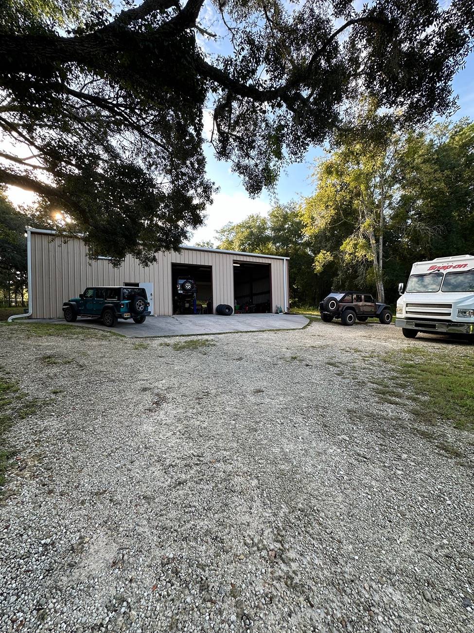

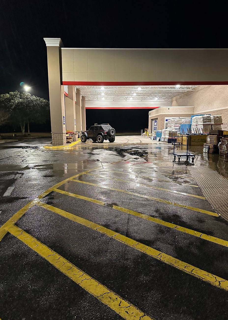

Rough couple days, hurricane Helene decided to trespass through my backyard….🤬 … made it through ok, lot of down trees and debris, house and garage still standing….. times like this makes me appreciate my rig even more…..first at the blue box store waiting for it to open for supplies ……..✌

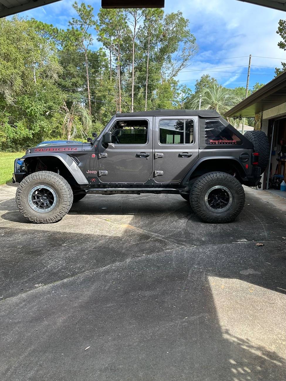

Had some guys ask me how well the RK springs carry extra weight so….Top pic is empty, bottom pic there’s 10-40# bags of salt./400 lbs in the cargo area…..I did this study awhile back but didn’t get a side pic …..I think these 5 year old RK springs carry the weight pretty good…
