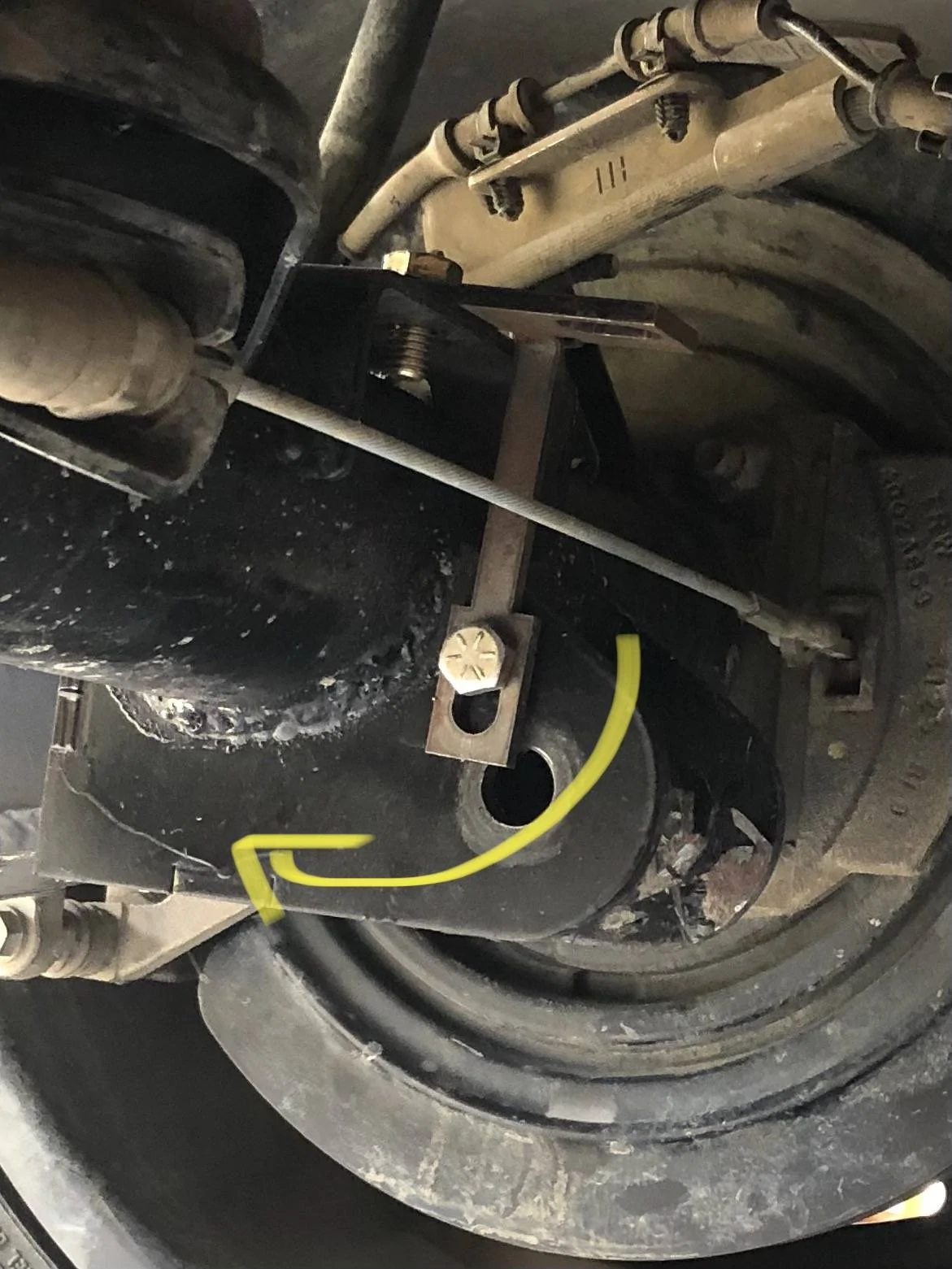

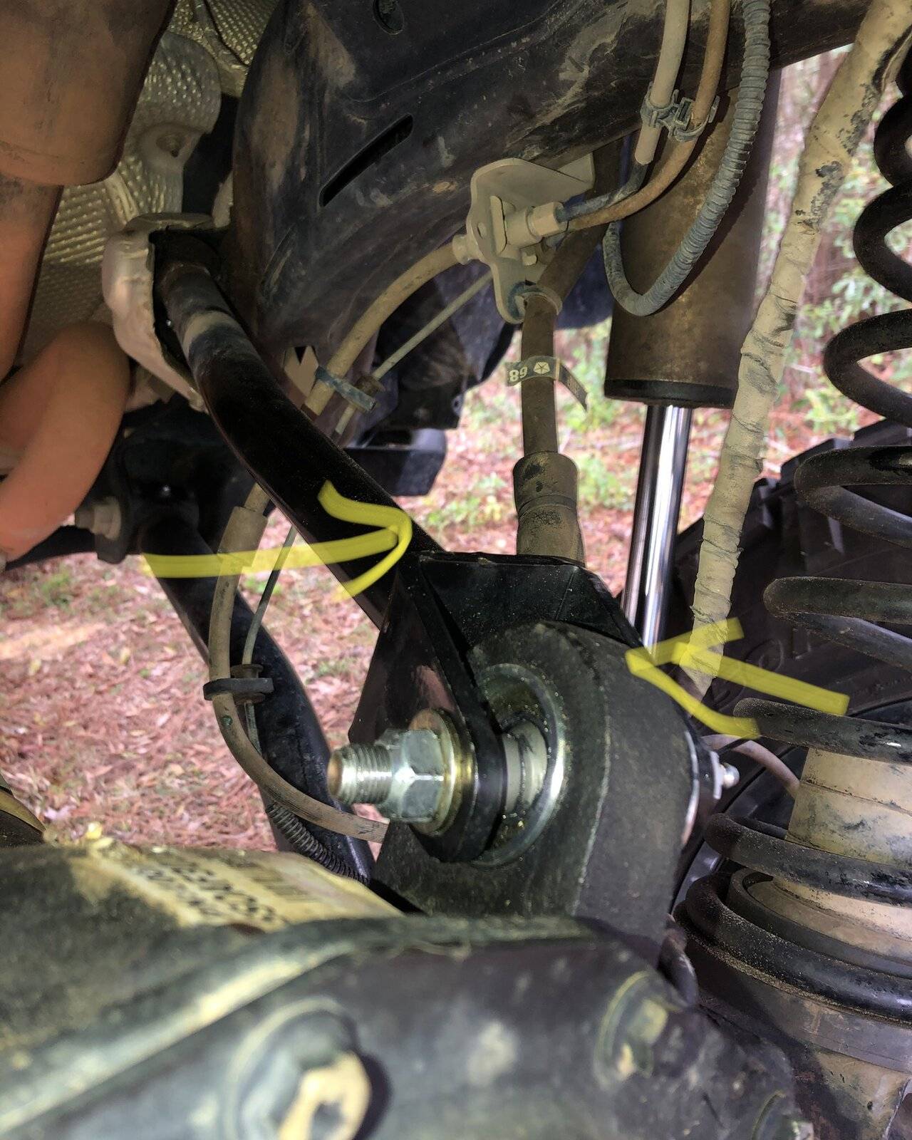

Well after all that drama with the bushings, I’ve decided to go back to oem. Lol.

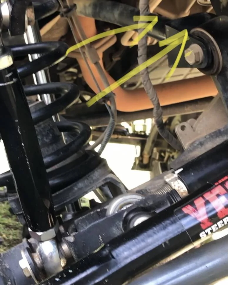

The Rock Jocks are awesome, they really are but through trial and error I’ve decided that they’re not really a good fit with a control arm that already has a krawler joint, Johnny joint, or Heim joint on the frame side. This allows the arm to articulate but doesn’t re-orient the arm back to the original position the arm should be. I’ve had a conversation with RK about it, and they’re in agreement with me that the arm needs to re-center when coming off an obstacle.
In other words, the arm stays where you put it, and with it laid over it bangs against the axle housing. You see in pic with oem bushing, the fork and the axle housing stay parallel with each other……….
Jeep Wrangler JL Crystal Rubi build… F51CD086-7695-4A8E-9166-859B9F593455
And with RJ bushing you see how the arm lays over, now this is ok when on the obstacle, but when I come down the arm stays like that……
Jeep Wrangler JL Crystal Rubi build… 268F3291-1FE9-4271-874E-113ED68BDD7B
When I was on short arms it wasn’t as big a deal, but these long bastards are a lot more involved in the overall articulation and when they stay laid over and bang on the axle housing you hear about it…….…? ……

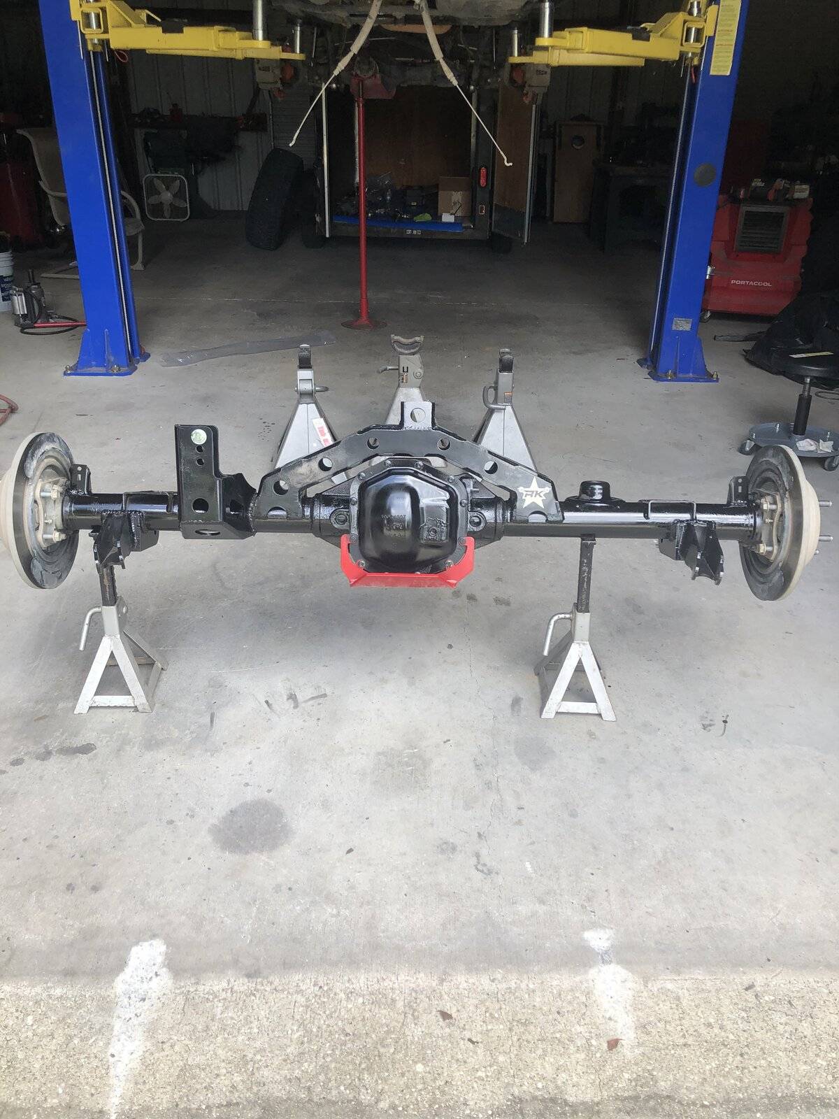

I’ve had a few guys ask about my install of long arm kit so I’m gonna go over it here so I can reference it later……. It’s a bit long winded, so you might want to bring a samich, or make sure your coffee’s topped off……:)
The instructions are really pretty good there’s lots of pics, I like that… the only thing I didn’t like is there’s not instructions for just the long arm upgrade, they’re for the whole lift. I had to skip over some of it to get to what I needed, but sometimes had to read through parts of it to get to the parts I needed. Anyway I read them so many times and watched a couple vids over and over, by the time I got my parts I only had to reference the instructions for suggested control arm lengths, lol.
Im not going to do step by step, because the instructions and videos are readily available. I’m just gonna hit on some things I did, that’s not mentioned or at least I didn’t see it anywhere.

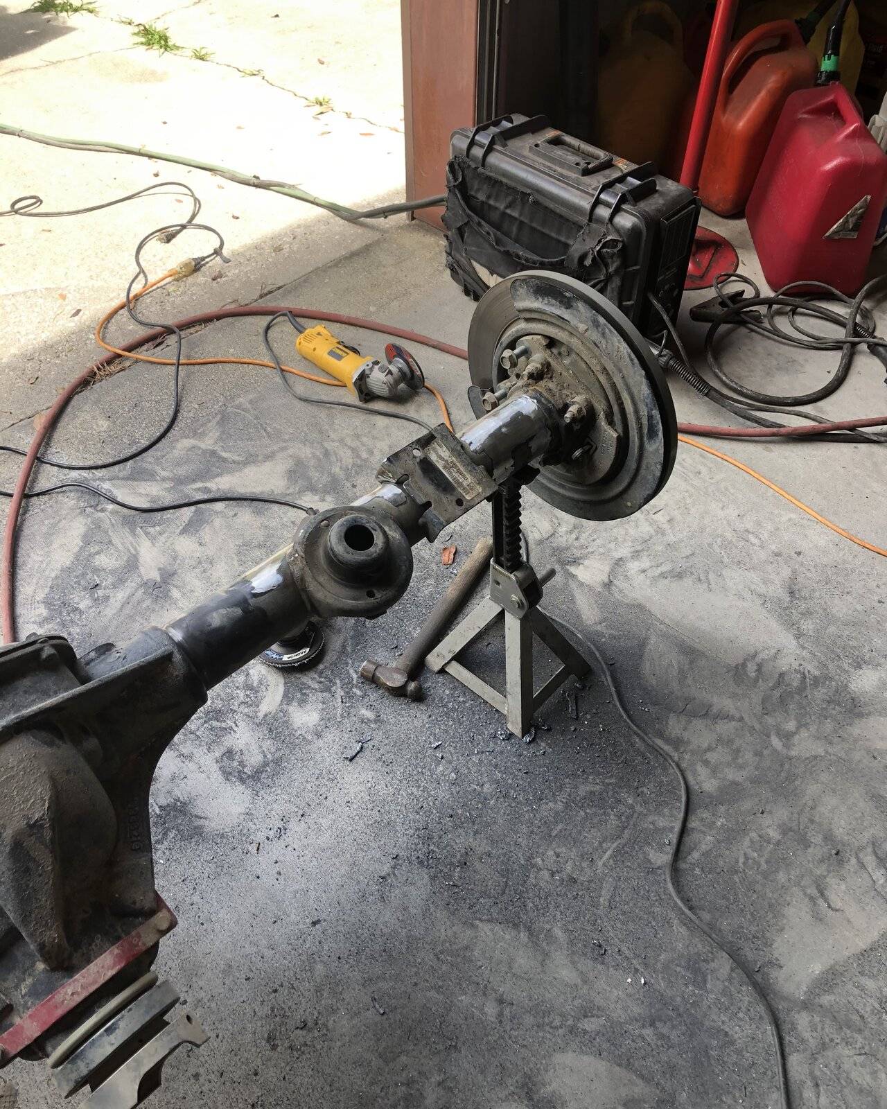

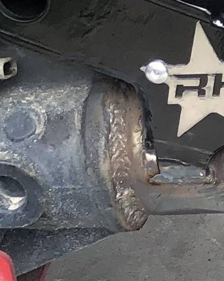

On the rear axle : they give you a tool to locate the lca/shock bracket be sure to rotate it down as far as it will let you, this will help with space between the arm and the body mount bolt. Also it’s not something you have to do but since I was right there, I decided to weld my axle tubes up.

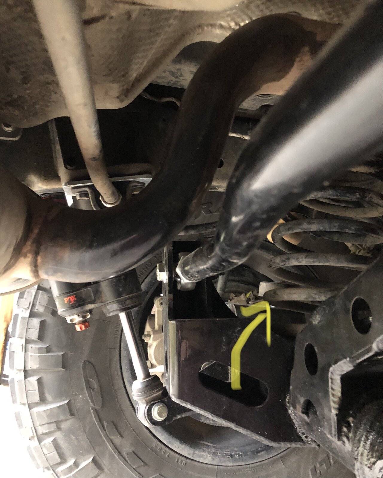

With the track bar bracket they have you put angle finder on the truss and match the reading. If I had it to do over, I would rotate the bracket slightly more forward. With the factory exhaust the track bar is extremely close, and mine makes contact on extreme flex.

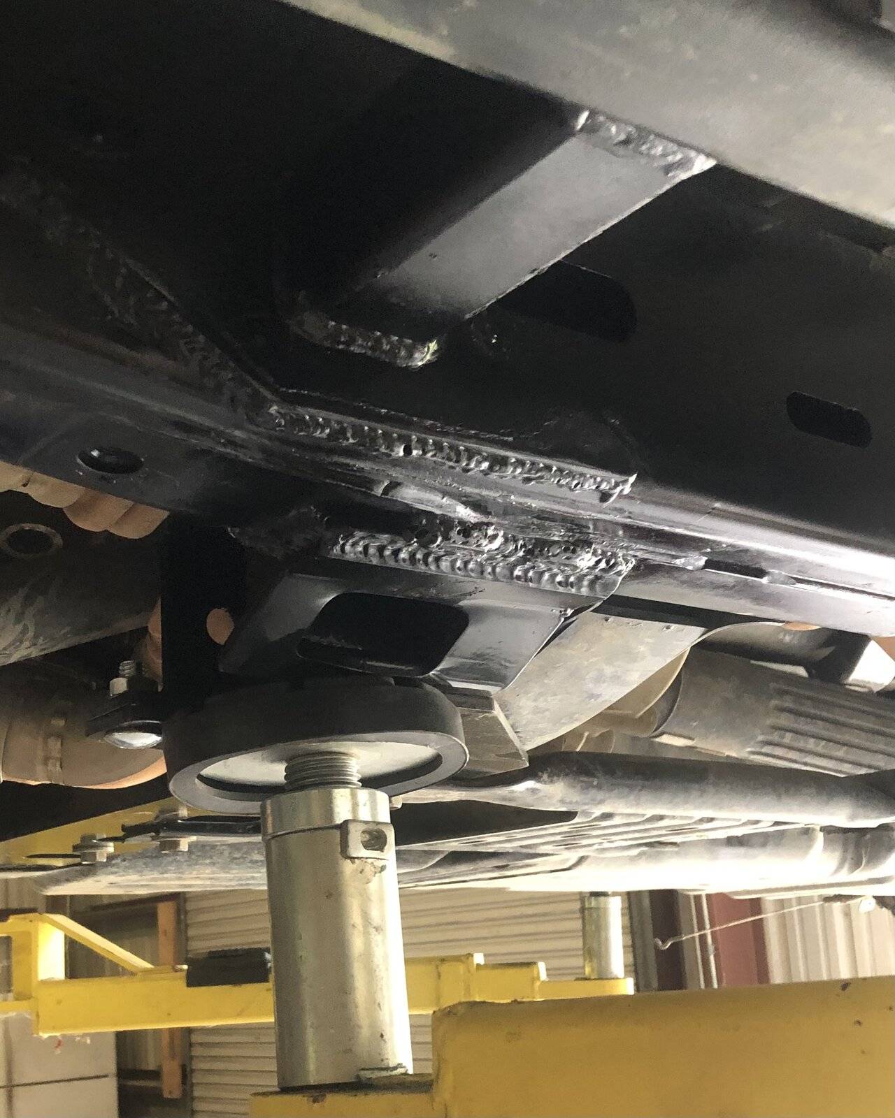

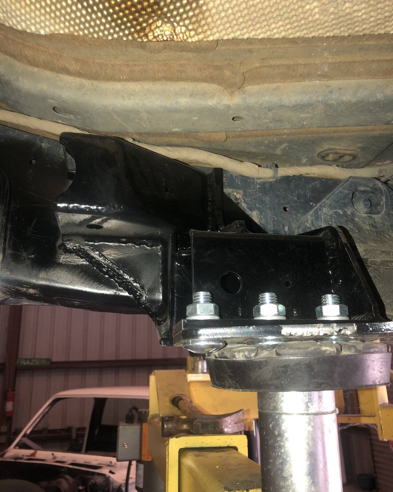

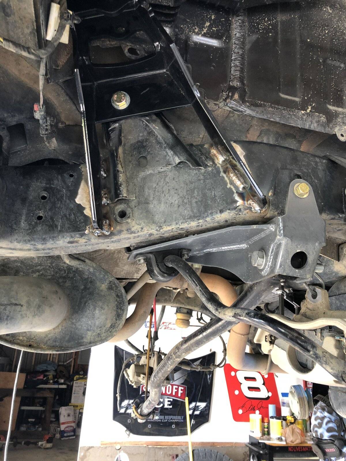

On the rear frame side lca brackets they tell you to drill out one of the existing holes in the frame to 1” in diameter. Well the welded nut on the bracket is bigger than that because of the weld so you need to make the hole bigger. Just be careful not to elongate it because the nut fitting in the hole is what puts the bracket in the right spot. I just used a bigger step bit so to keep the hole round as possible.

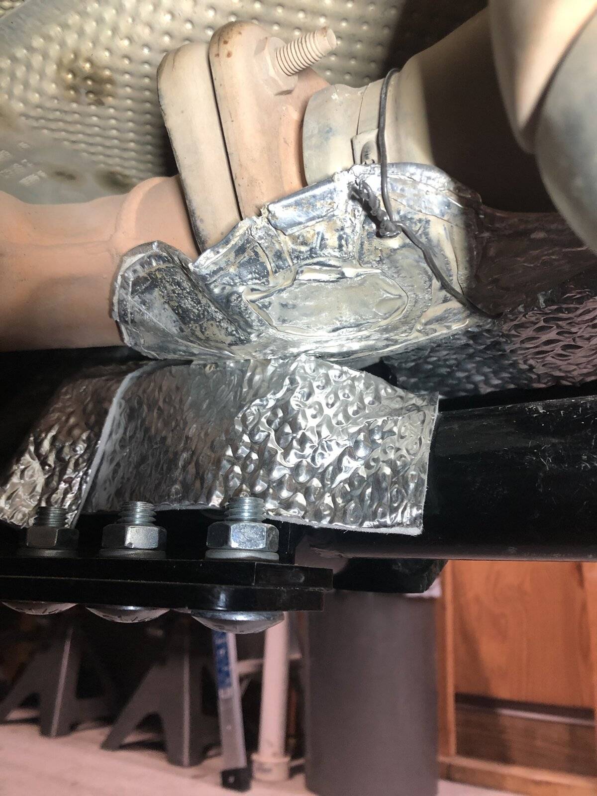

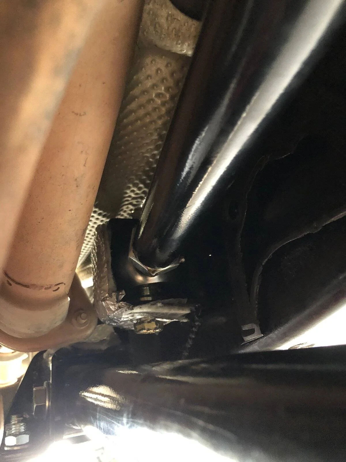

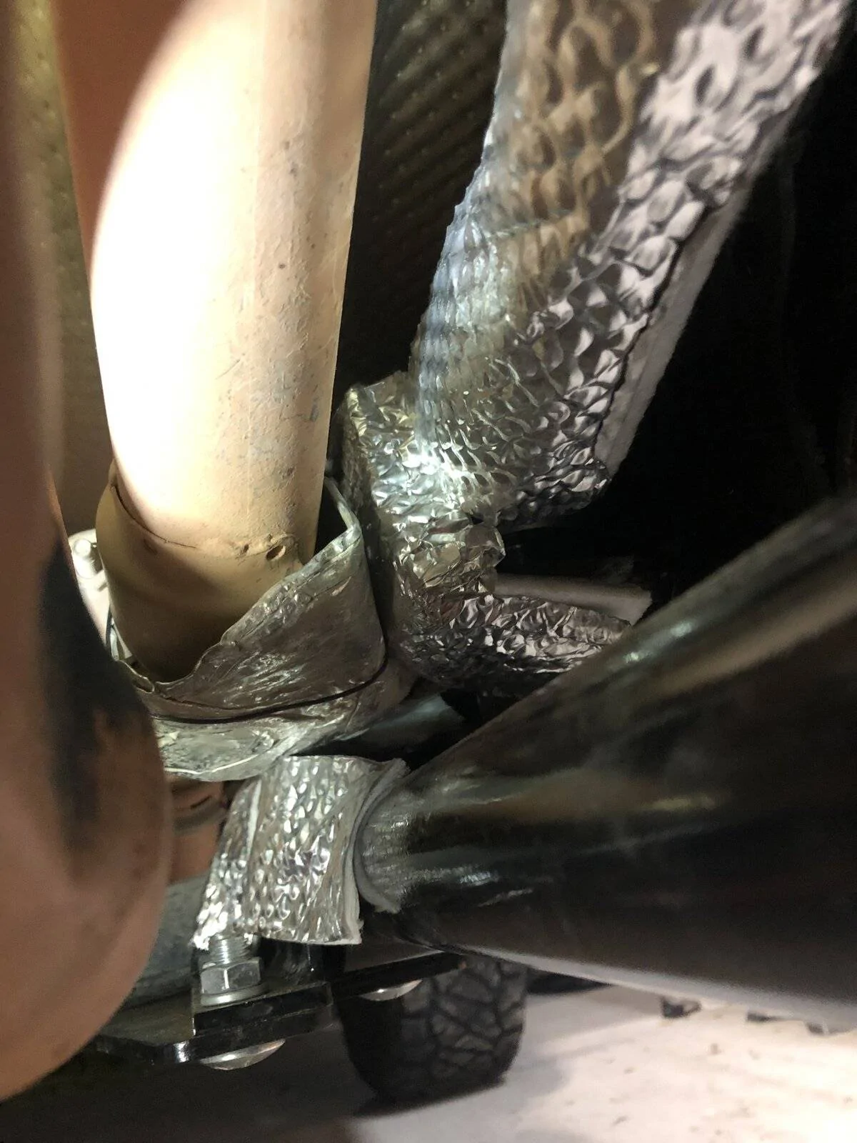

On the front, the only thing is be sure and wrap the drivers side bracket with as much heat shield as you can. I took this step lightly and noticed that my anti seize was leaking out it was that hot. I smashed out my oem aluminum heat shield and used it as well as the heat shield they provide. It’s not pretty, but is working until I can fab something up….
This is how I had it:
Jeep Wrangler JL Crystal Rubi build… 3C3FA5EC-530A-46A0-9402-DB13B302A9FD
This is how it is now, the heat of the exhaust in that spot is no joke, lol. …….
Jeep Wrangler JL Crystal Rubi build… 9767D4E4-9749-41D3-9572-D5236304D5A0
Jeep Wrangler JL Crystal Rubi build… 25E71F69-53E2-4677-A278-4E54A034FAB9

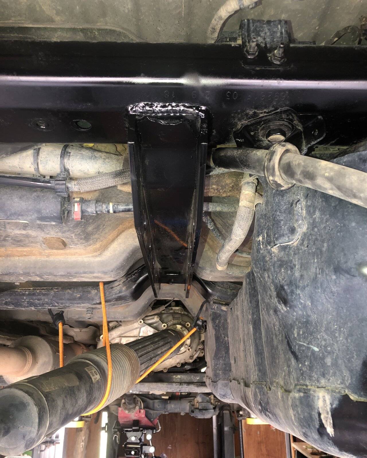

pics of brackets…….
rear shock tower
Jeep Wrangler JL Crystal Rubi build… 65DF902E-6FA5-42DC-AA49-B1071EEE2D8A

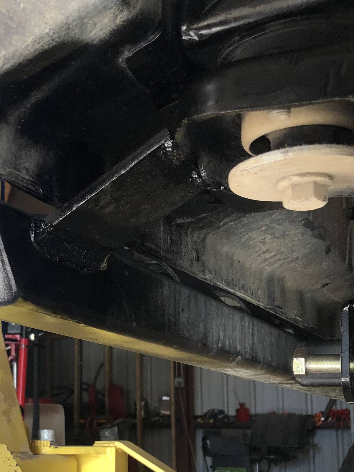

rear lca bracket
Jeep Wrangler JL Crystal Rubi build… 3396C1A2-4D5F-4917-B30F-75763423DAFD
front upper/lower bracket
Jeep Wrangler JL Crystal Rubi build… C82A137F-8987-43CF-B524-E8F7CEE438D5
upper rear control arm bracket
Jeep Wrangler JL Crystal Rubi build… CB7EC648-BB2D-42FC-B733-3B91B78B6DF7

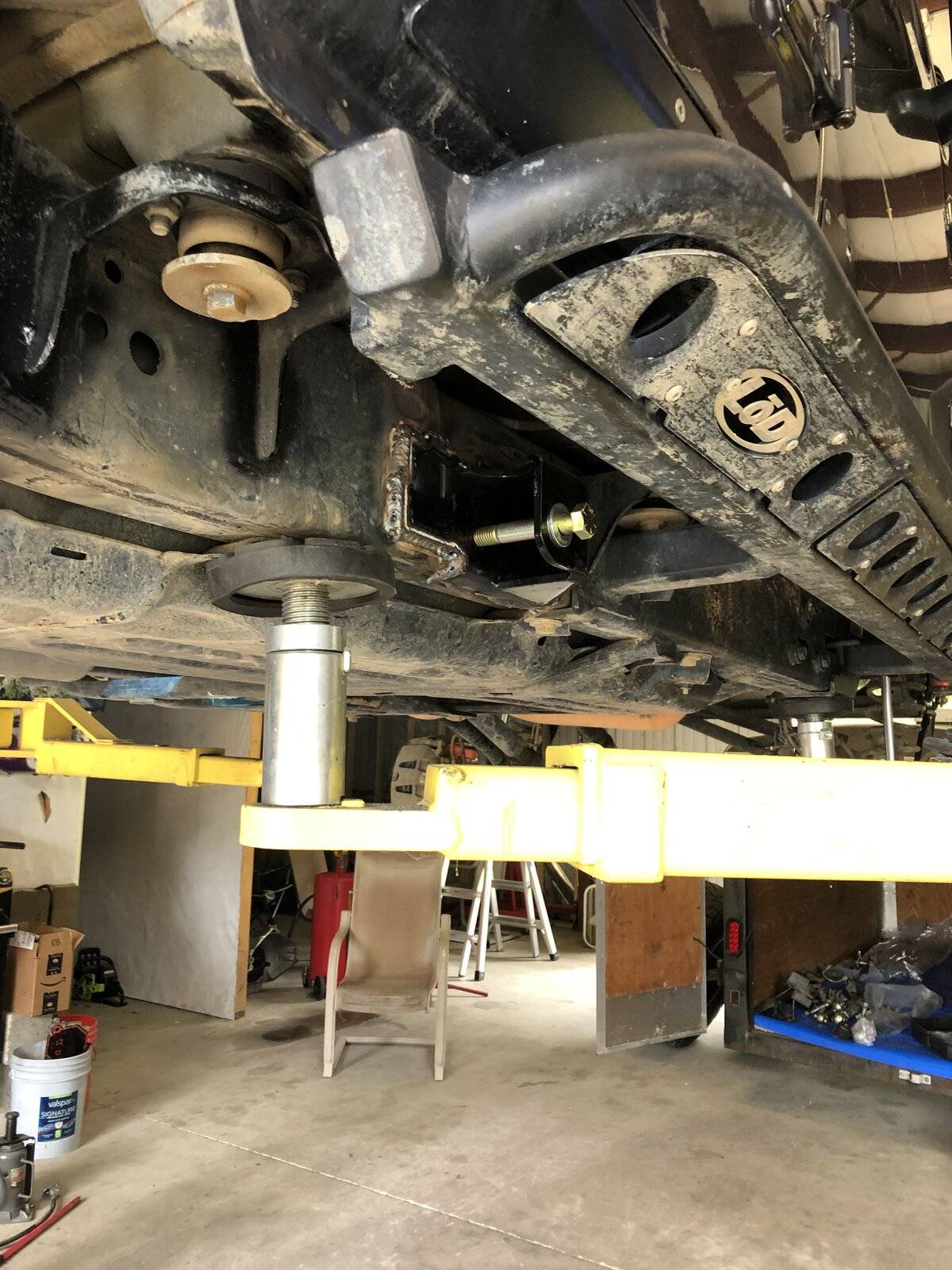

LOD rock sliders will work with this kit, despite LOD and RK both telling me it wouldn’t. You just have to be willing to weld them on……….
Jeep Wrangler JL Crystal Rubi build… ABC7934C-9BBE-4667-8834-6C0CA3641711
Jeep Wrangler JL Crystal Rubi build… 54BD7864-14B1-4DBB-91B2-DD3C3E40BC6A
It’s a bit of work, but definitely worth it.…✌
