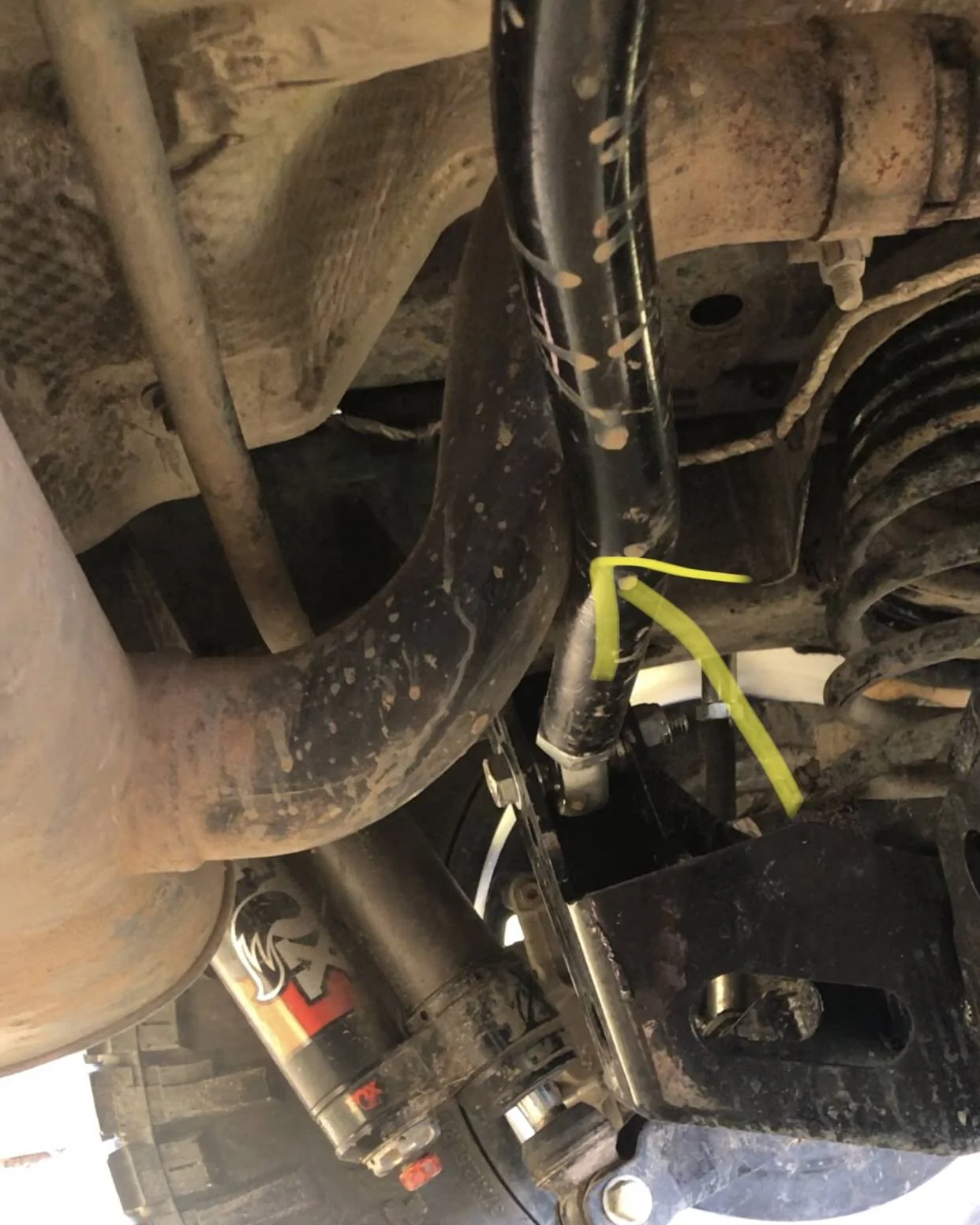

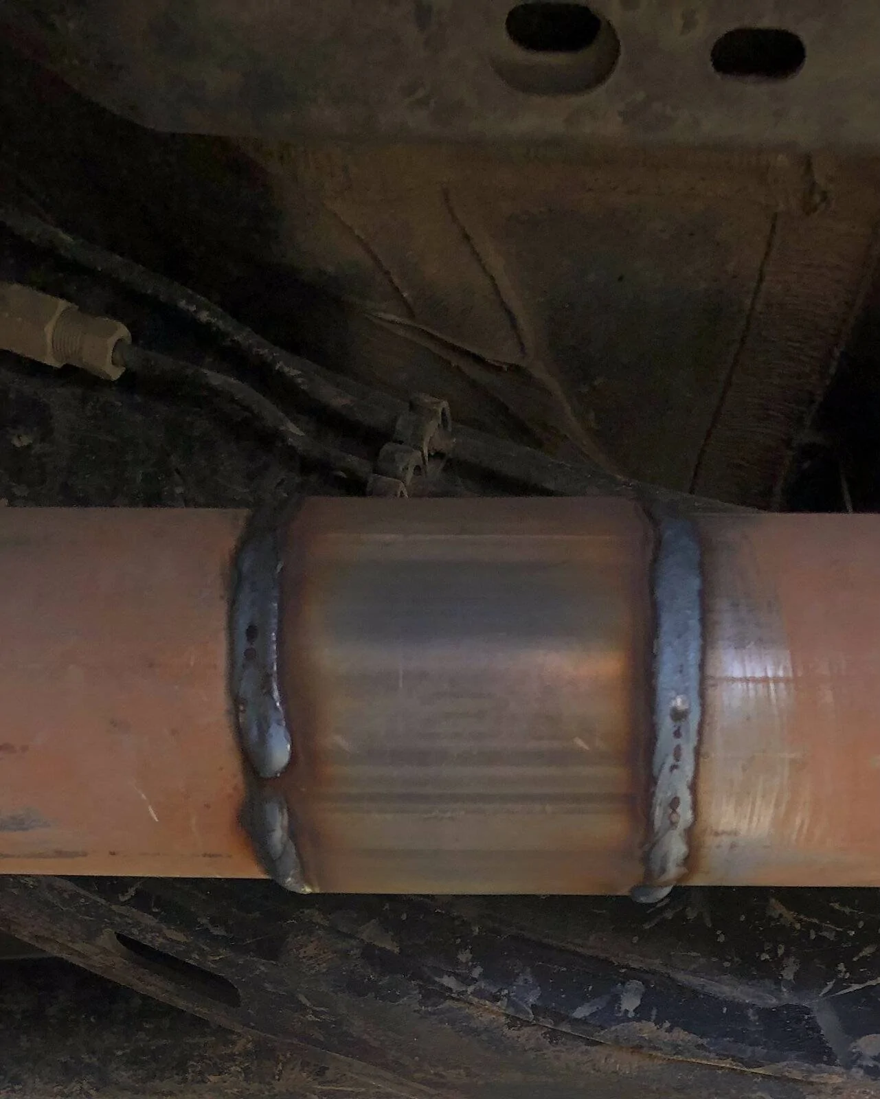

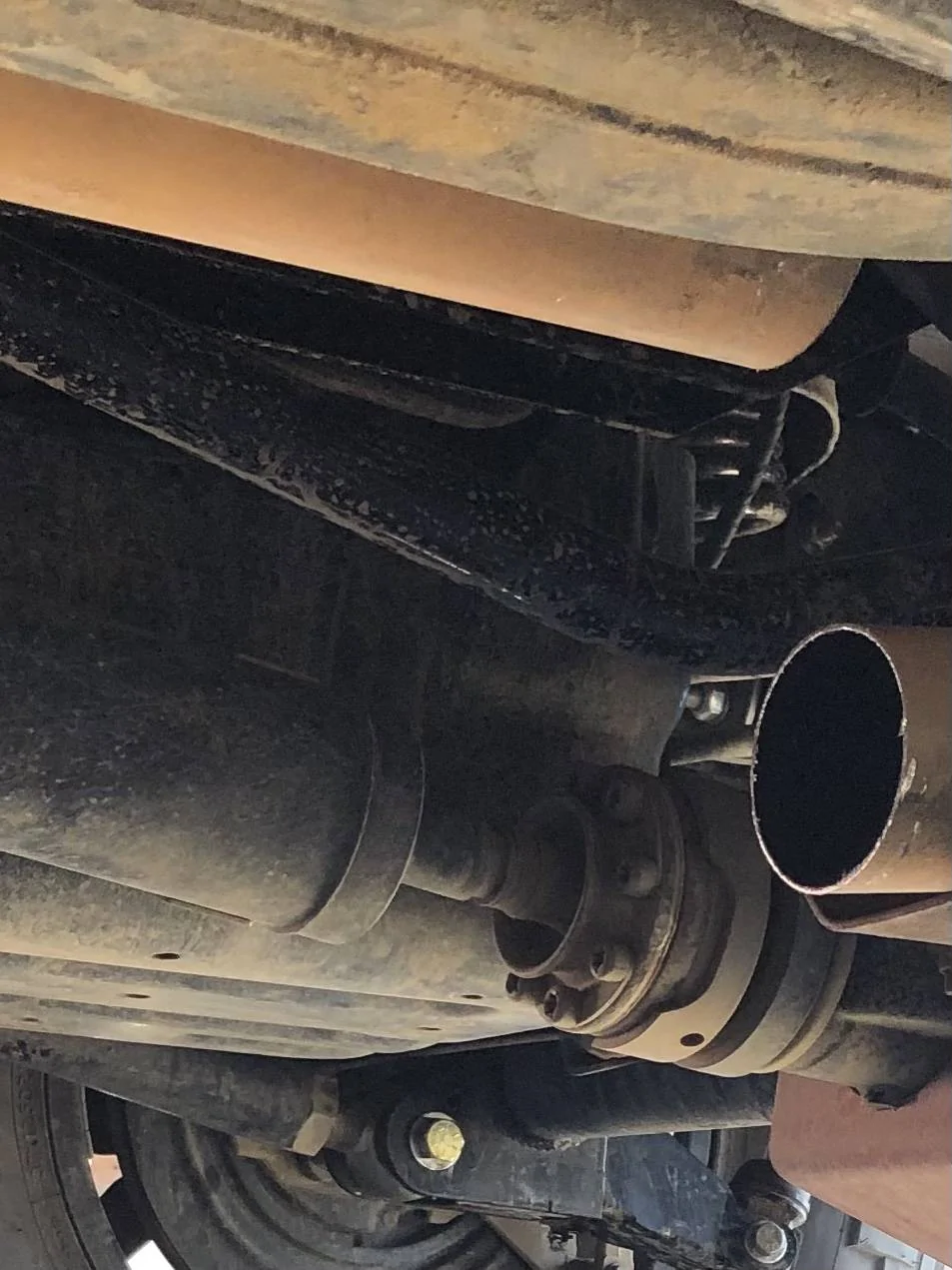

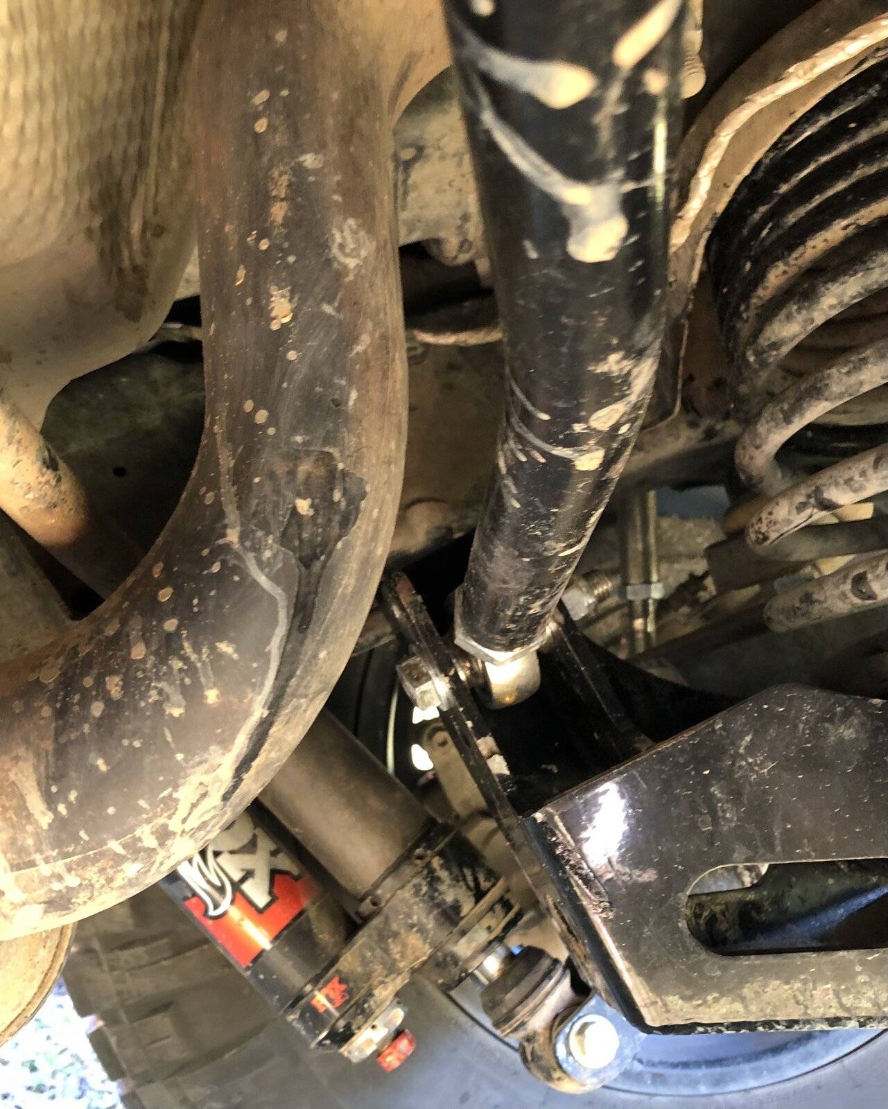

The track bar was contacting the exhaust at full stuff, so I cut the exhaust and added a piece to push the big ass muffler back some. I’m going to do different exhaust, but I’m looking for something quiet, not much louder than stock if any. Any suggestions ?
I have the Borla high clearance in their "touring" (quietest) version. It's a bit loud but does completely clean up the rear end for clearance and such.
I think it will work with your long arm setup.
But it is a bit louder.

Yes it seems all those who want an aftermarket exhaust want louder. Not sure this makes sense on a Jeep....
What’s your take on the exhaust loop under the drivers seat. I’ve researched and all I’ve found is theories and opinions. I understand the premise but not sure I agree with it. But obviously FCA decided it was worth the extra pipe for hundreds of thousands of Jeeps.
I'm a 2.0L so no loop.
The concept is keeping equal length on each of the "Y" helps scavenging somewhat. It can also be done to tune the exhaust note to sound more pleasing.
In my drag racing days this was quite common on V8 setups. Even with dual exhaust a "X" cross over was a benefit to get some scavenging.

Yeah, I get it, I’m just wondering if I get rid of it, what to expect as far as noise, performance etc…. It’s right by the upper/lower control arm bracket. It got hot enough to make the anti seize leak out. Afraid I’m gonna be going through raceways like underwear. I got it a lot better with heat shielding, but it looks like a monkey did it, well.. that’s not to far off but still……
