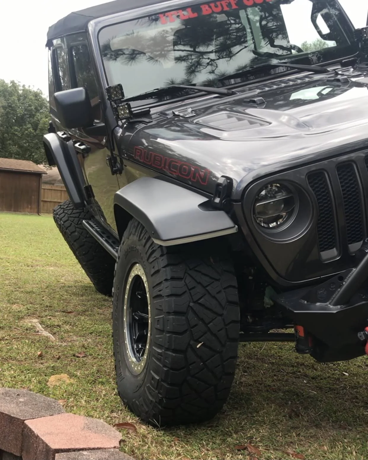

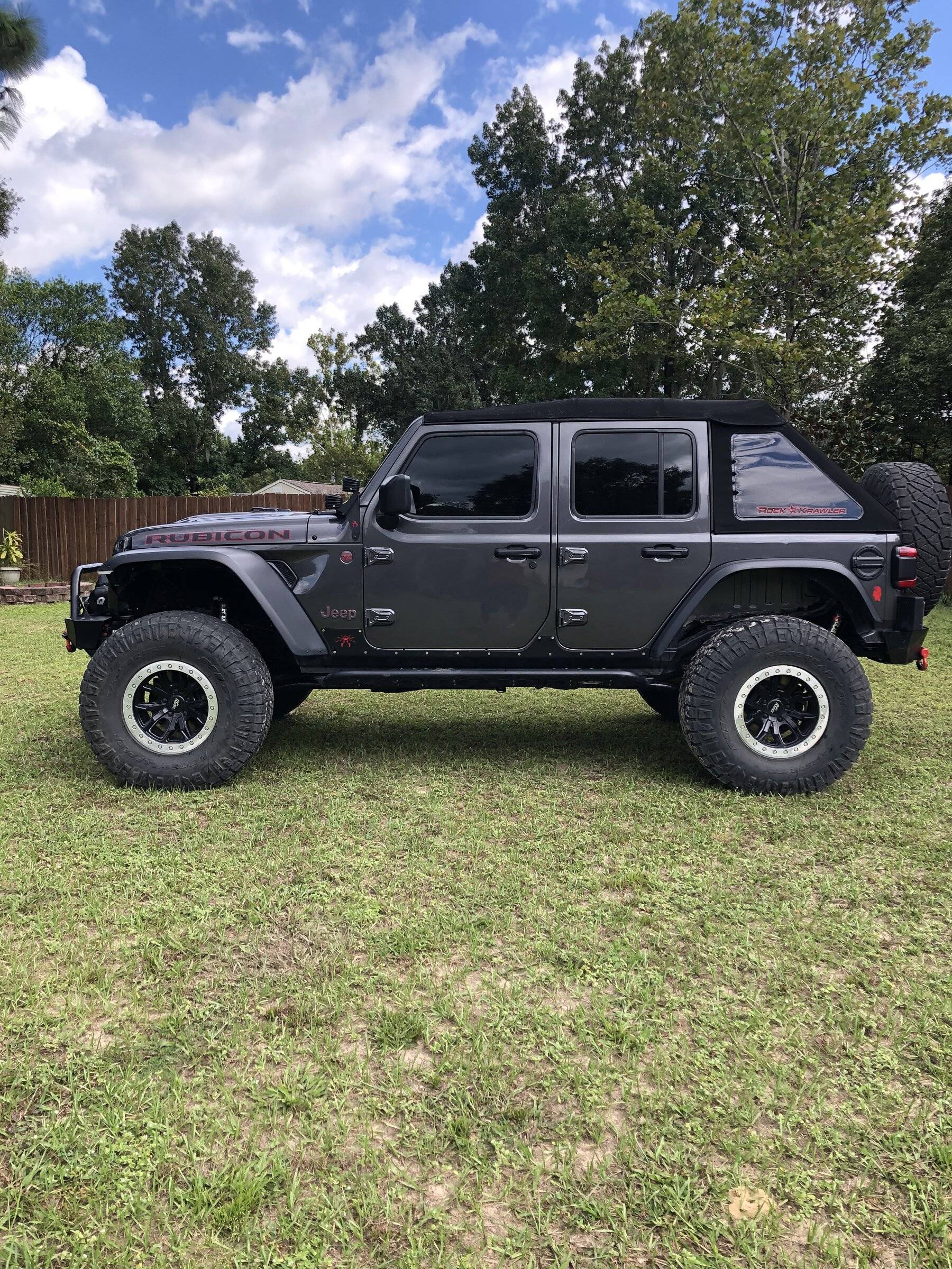

Ok, here are some pics.
Before-Dynomax muffler delete (hard to see)
Jeep Wrangler JL Crystal Rubi build… B7D8DCB6-61ED-4E61-BE98-CE52FA3DB753
Hooker Blackheart:
Jeep Wrangler JL Crystal Rubi build… B6539069-777B-49F5-9DA8-84915238F131
Jeep Wrangler JL Crystal Rubi build… E327D753-D9D1-414D-B175-29746F65AAC9
Jeep Wrangler JL Crystal Rubi build… D3EC9E66-82CB-418B-85B0-07853CC45323
Jeep Wrangler JL Crystal Rubi build… 7C098307-8C8B-4222-A145-5D21776CD9F3

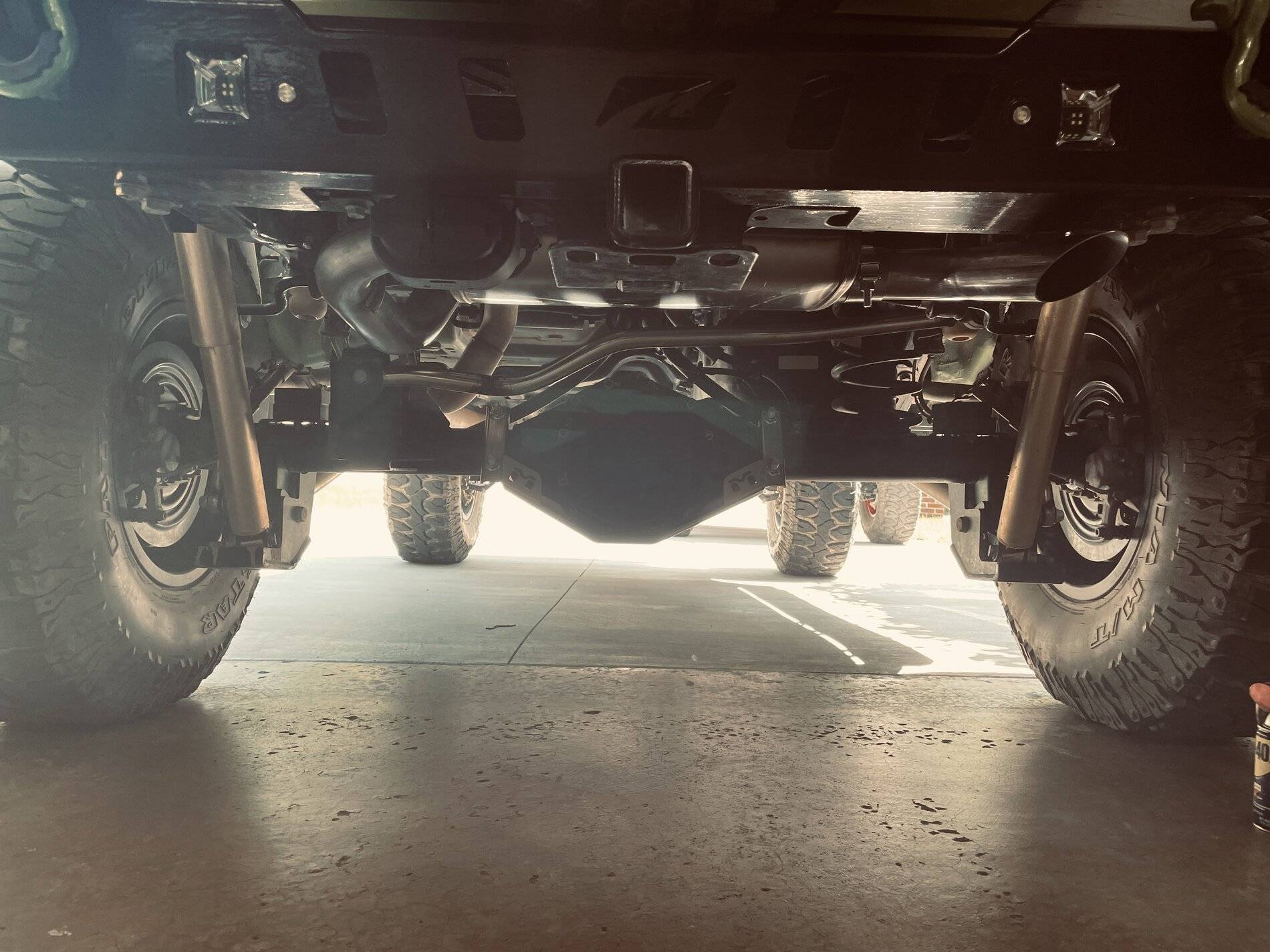

Yeah, I get it, I’m just wondering if I get rid of it, what to expect as far as noise, performance etc…. It’s right by the upper/lower control arm bracket. It got hot enough to make the anti seize leak out. Afraid I’m gonna be going through raceways like underwear. I got it a lot better with heat shielding, but it looks like a monkey did it, well.. that’s not to far off but still……
I'd wrap the exhaust where its close in exhaust wrap with the stainless tie-wraps to secure it and the high temp coating spayed over that to protect it. Will lower the temps in the area and help.
I did this on my 2.0L from the exhaust side of the turbine down to behind the passenger seat just before the Borla muffler.
I used this stuff, worked well. They also have an aluminum heat panel that can be bent that might be good to build a tunnel around the arm mounts to keep them from baking like the factory uppers had?

That’s what I used , I smashed it out flat and wedged it in there, I’ve got it where it’s working, I might do your method for aesthetics. Although this looks pretty sweet… ?
The wrap on the pipe would help to clean it up and gain you some space. Interesting as RK claims "factory quality heat shielding" but that's probably on the "dream" list

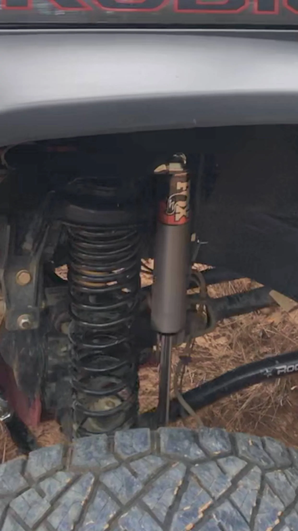

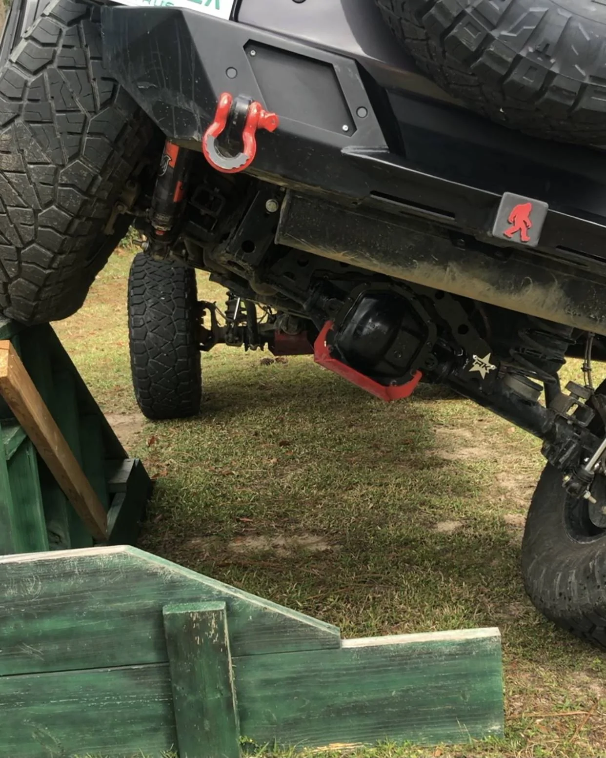

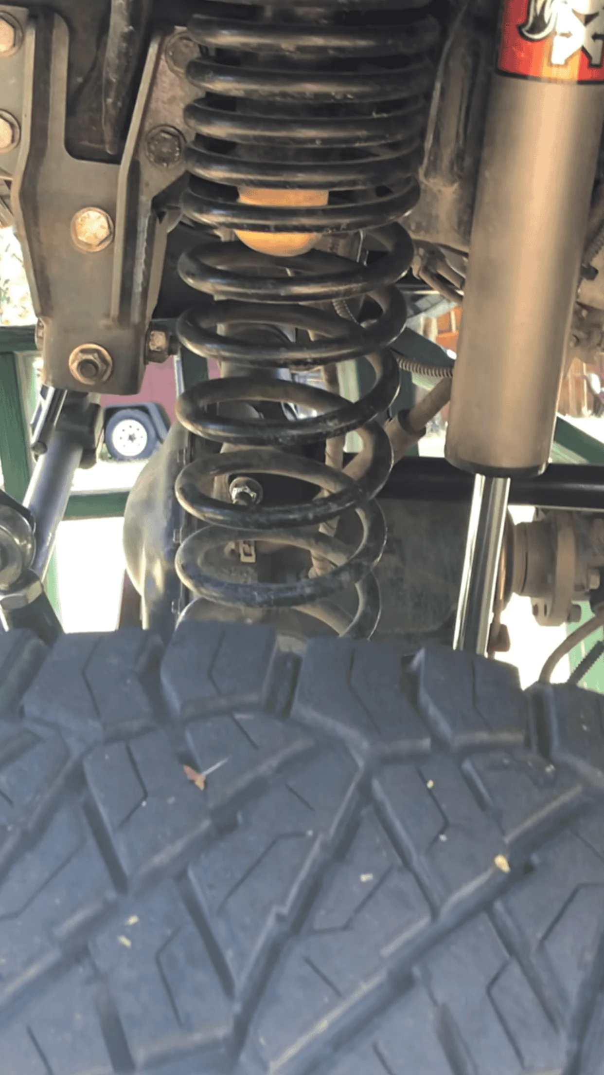

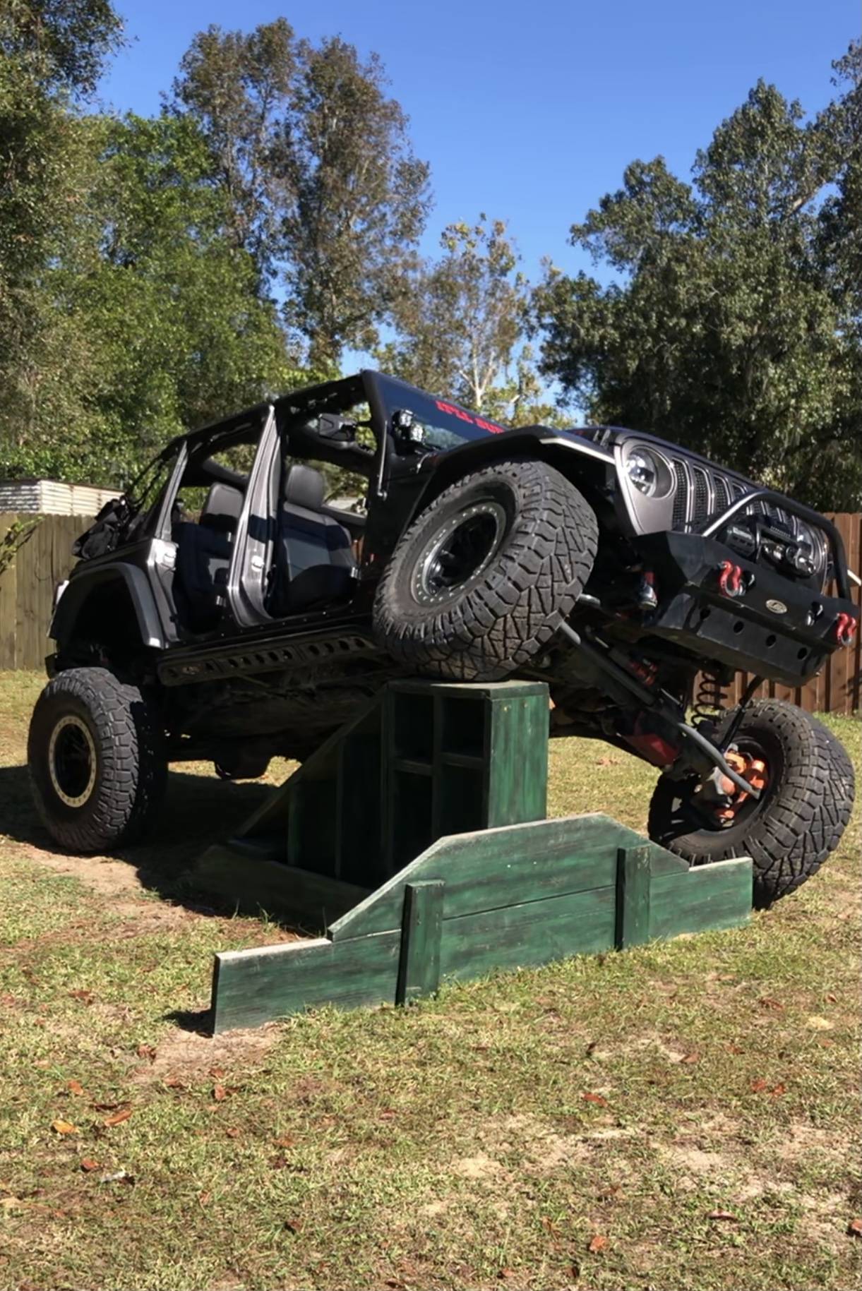

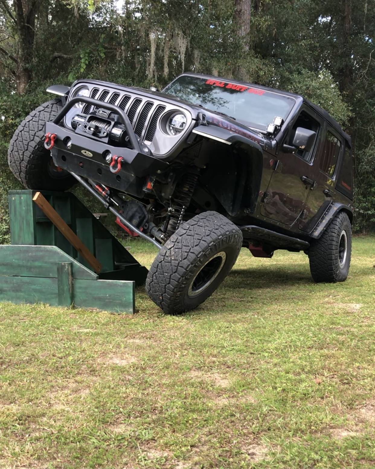

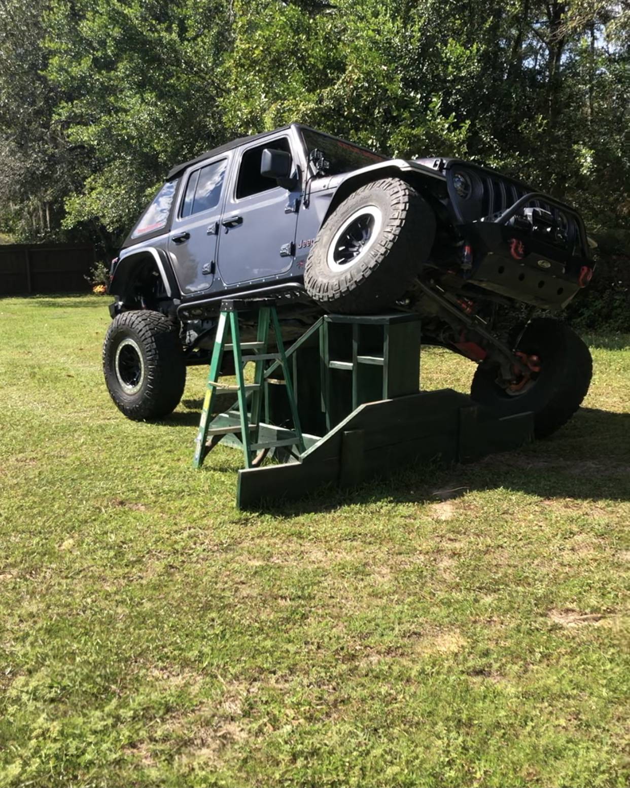

Here’s a good example of short arms vs long arms when drooping. Notice the white upper bump inside the spring, you can see how the axle is pulled back with the short arm and it droops straight down with the long arm…….
short
Jeep Wrangler JL Crystal Rubi build… 87881F63-8910-4F4C-9F29-A0745CAB931C
long
Jeep Wrangler JL Crystal Rubi build… 42F9C2CD-B6E6-4531-849B-3EF3A5F40799
Now this isn’t that big of a deal in the front because of the ability to steer. But in the rear when the wheel droops it’s pulled towards the front and when it comes back up it kinda feels like the rear is steering.
I was out this afternoon and didn’t feel that same side to side kinda jolt through this one obstacle that I normally feel. This is the biggest difference off road I’ve encountered so far. Pretty cool………. I’m easily fascinated…..?
short
long
Very cool.
And for on road driving the front long arms should really soften up bumps and such as the shallower angles means axle goes up and down instead of also transferring a lot of force into the front frame side arm pivots.
I'm really curious about this aspect as a lifted jeep makes this worse with a short arm as the angles get bigger.

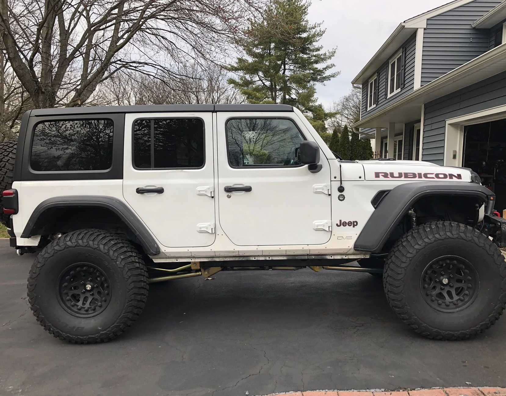

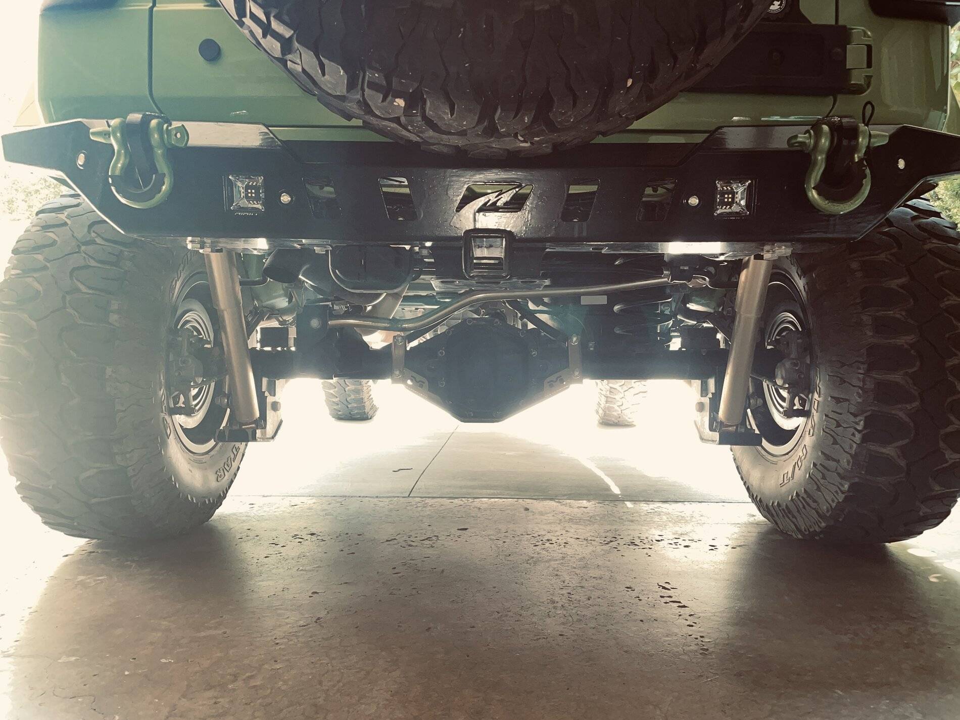

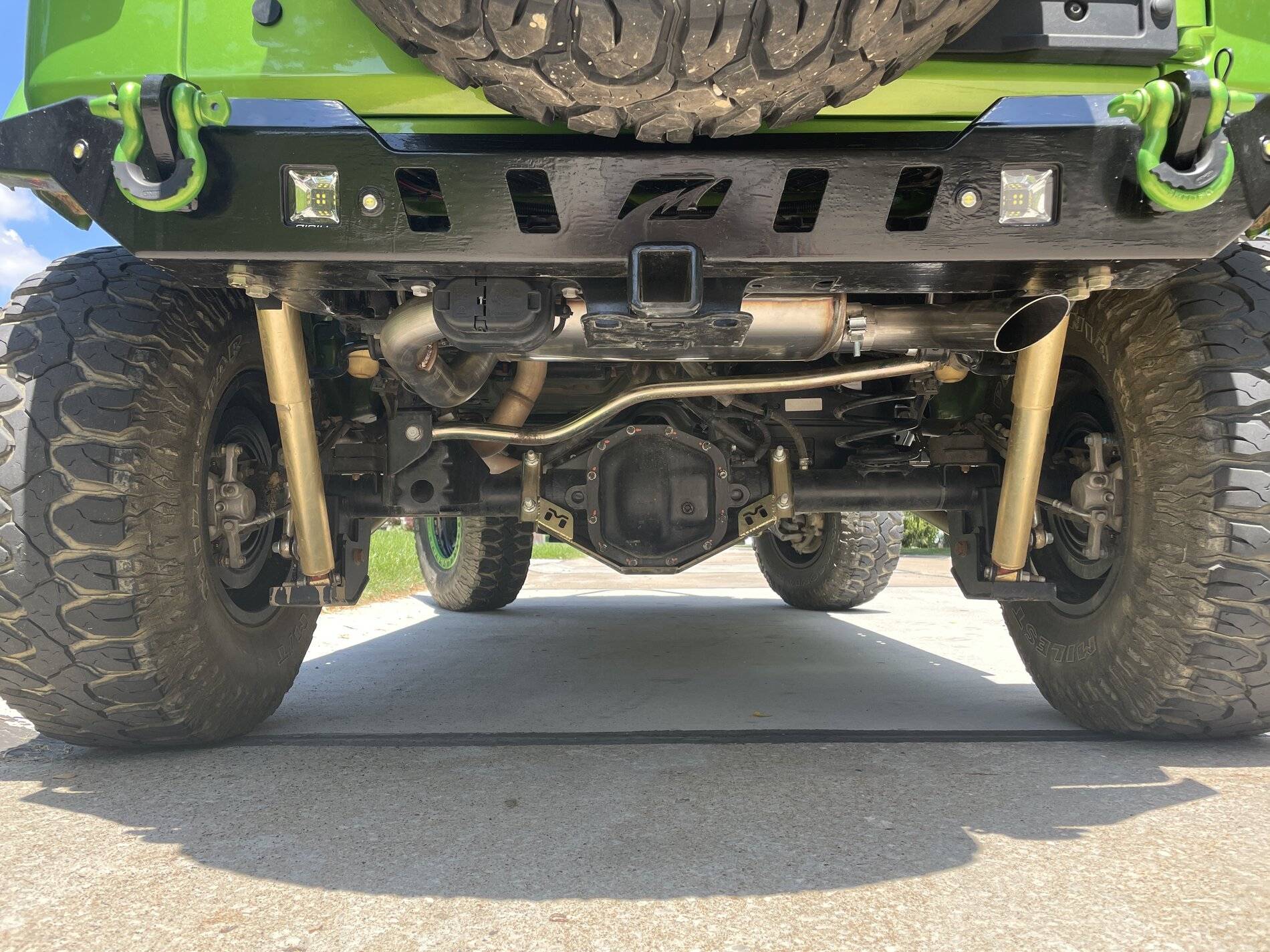

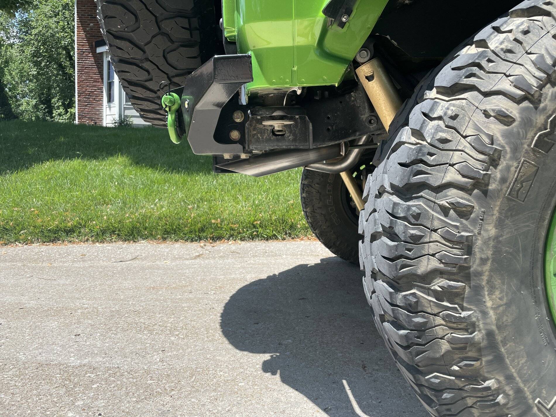

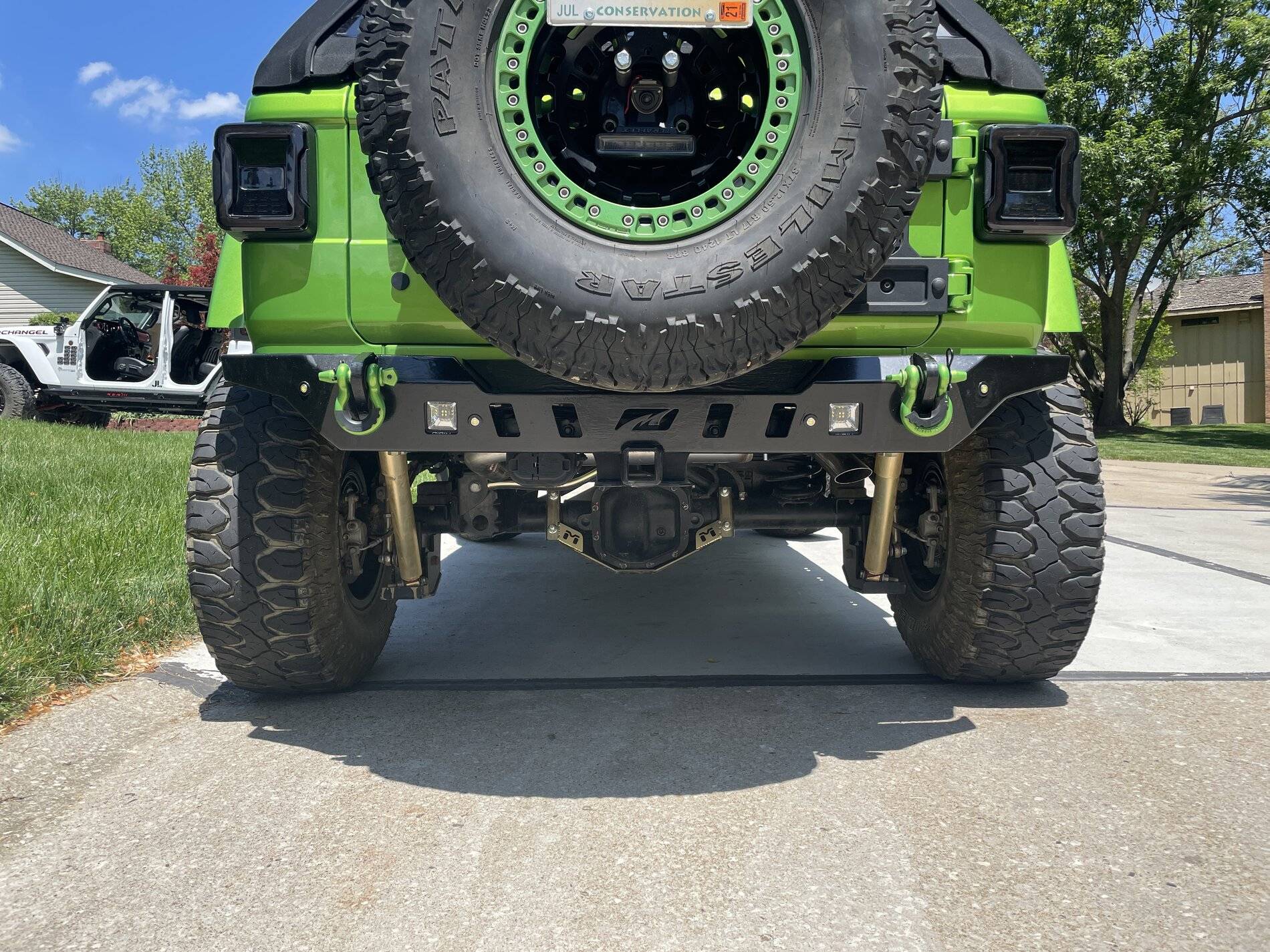

Absolutely the on road ride is what I noticed the most. So much smoother, and feels more stable. Pretty impressive . And the way RK designed this there’s no loss of ground clearance. On most other long arm kits you can see the arms underneath. With these you can’t tell if I have long or short arms.
long
short
Yup, they did a nice job tucking it all up and in.
