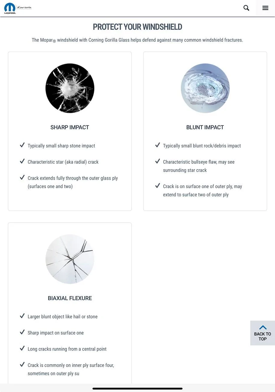

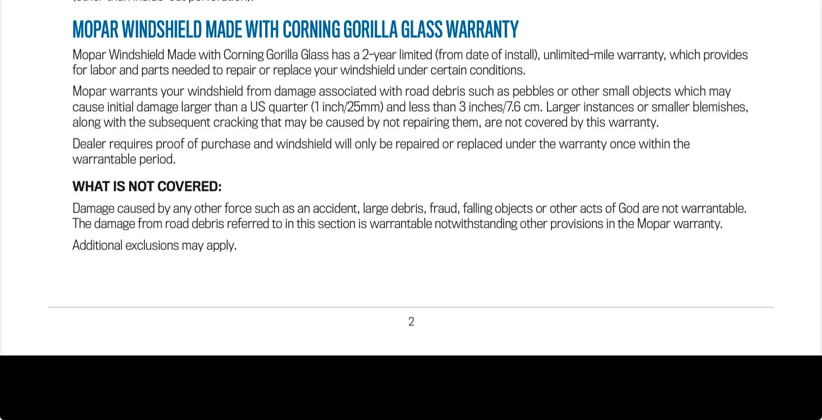

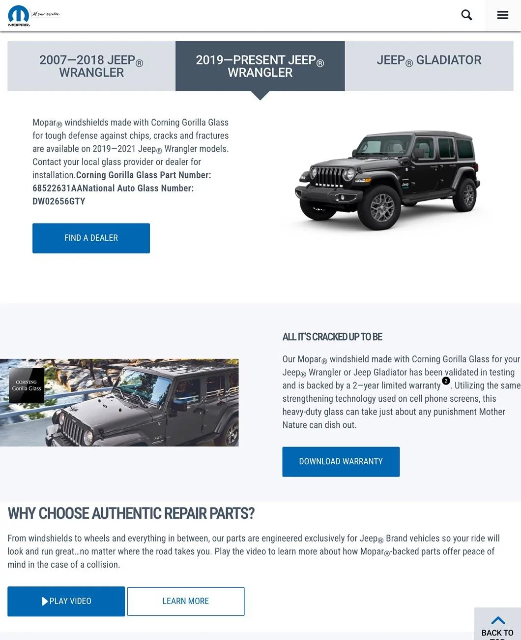

I have a gorilla glass windshield in a 2024. It has a 2 year warranty as shown below. I went to Ancira Jeep in San Antonio. Took 2 days to get it approved.

It still says it's a 2 year warranty. No mileage limits.

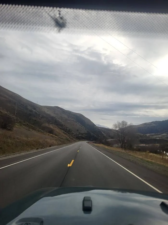

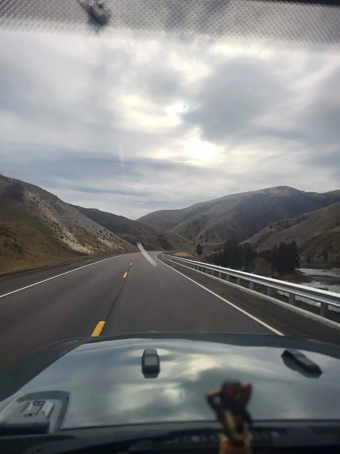

I went on a 3200-mile round trip in my brand new 2024 JLU with 3k miles on it.
112 miles into the trip, a semi kicked up a rock and caused a chip. 15 minutes later, it spread to a J-shaped crack.
When I got to Arizona a couple of days later, the crack went crazy sitting in the driveway in the sun and went all across the windshield and many different directions.
My dad owns two Wranglers and said he'd never seen anything like it. He thought the glass was seriously defective to crack that badly for no reason.
Jeep Wrangler JL Cracked windshield 20250110_122913
Jeep Wrangler JL Cracked windshield 20250110_123132
Jeep Wrangler JL Cracked windshield 20250118_124056
I have a $100 glass deductible, but hoping my warranty will cover this one.
Gorilla glass is apparently a scam, as I have never had a windshield crack this easily or badly in 40 years of driving.

you might need to adjust your expectations; Gorilla Glass windshields have exactly the same Soda Ash glass as their outer layer as any other windshield, and will crack just as easily.
the fact that the Wrangler windshield is nearly straight up and down just makes it more likely.
the bonus feature of Gorilla Glass is supposed to be the additional strength of the inner layer helping to prevent the likelihood of an object coming *through* the windshield (and the fact that they're thinner and weigh a little less).
