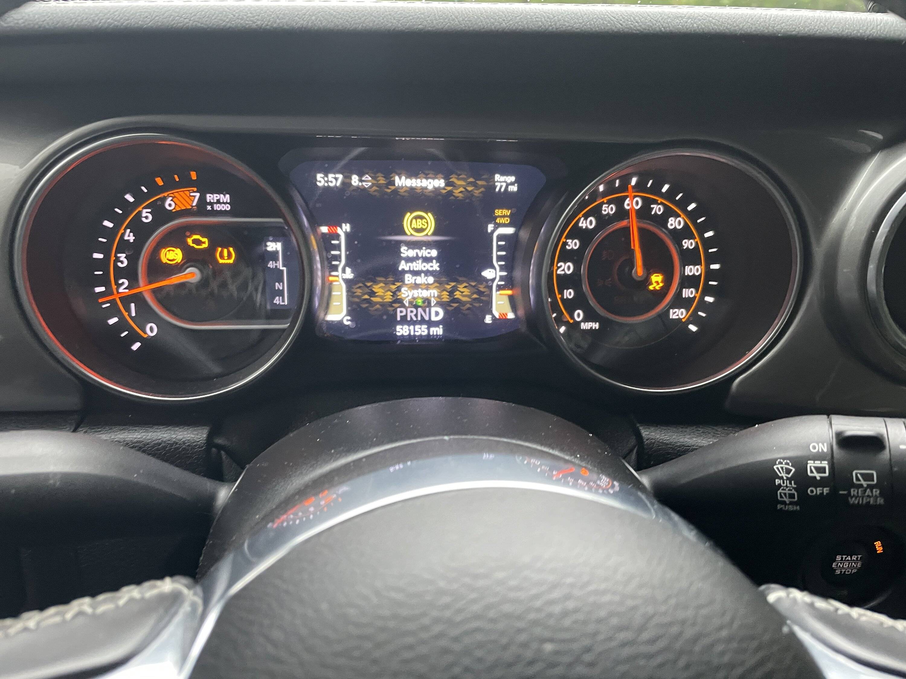

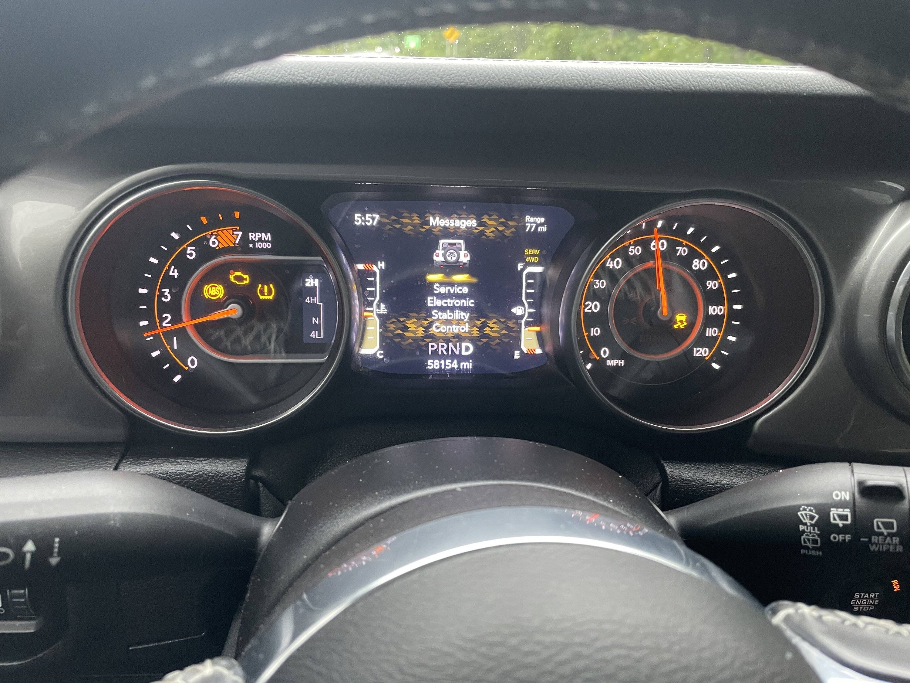

These warning lights came on today while driving home from work. The tire pressure light has been on due to a bad sensor. I will turn off with Tazer until I replace it. Could this be the start of bad batteries that need replacing or should I start else where. Haven’t had any problems this far so it’s strange that both errors popped up same time. Thks?

use the tazer and pull the codes, could be hundreds of things.
when those popped up on mine is was a rear wheel sensor, 5 min fix

Wheel speed sensor shouldn't turn on the engine light. PCM likely set a fault for lost communication with ABS module.
Posting a bunch of dash lights doesn't help diagnose the problem hardly at all. Gotta pull the codes.

Correct The wheel sensor threw a code to the AbS module which then threw a code to the check engine light.
Original poster needs to pull codes so we have a better understanding of what's going on?

So I woke up the morning and lights were off. Only engine light on. Will pull codes when I get off work today. Thks for the responses.

So all lights were off when I started the jeep this morning, except the tire pressure light. I knew sensor was bad. Pulled codes from tazor and found the following codes, c16d7-15, c1403-92, c0503-00, u140c, p0415-00, c003a-62, u1412-00, b16df-15, c003a-62. Jeep runs great and never had a problem until yesterday’s drive on way home. It was raining and that’s when warnings lights appeared. Thanks in advance, I’m going to start looking up the codes. ?
