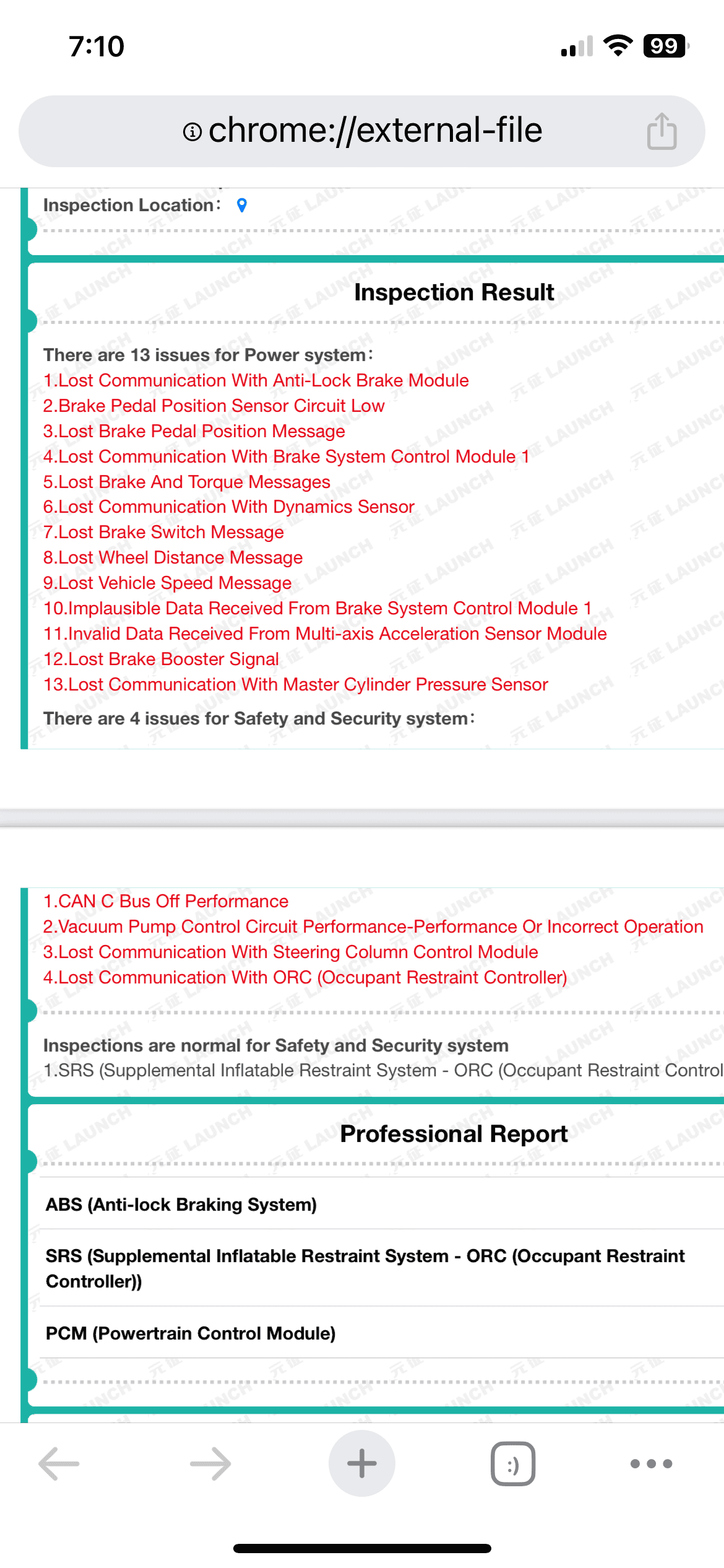

@JeepCares 2019 wrangler jl sport 2 door manual. 68,000miles. started with flashing abs light 2months ago with then start stop not working( given i replaced the aux battery 3 months before this happened) delearship said both batteries needed replaced so i did that. moving forward 2 weeks agos i got all these codes .ran the scanner because i got my dash lit up with every warning you can possibly imagine. every time it happened it wouldnt let me turn it over to off but wound turn over to acc.while making a weird noise(video attached) .finally it will turn over to off…one day on the turnpike the jeep did this but this time i lost my

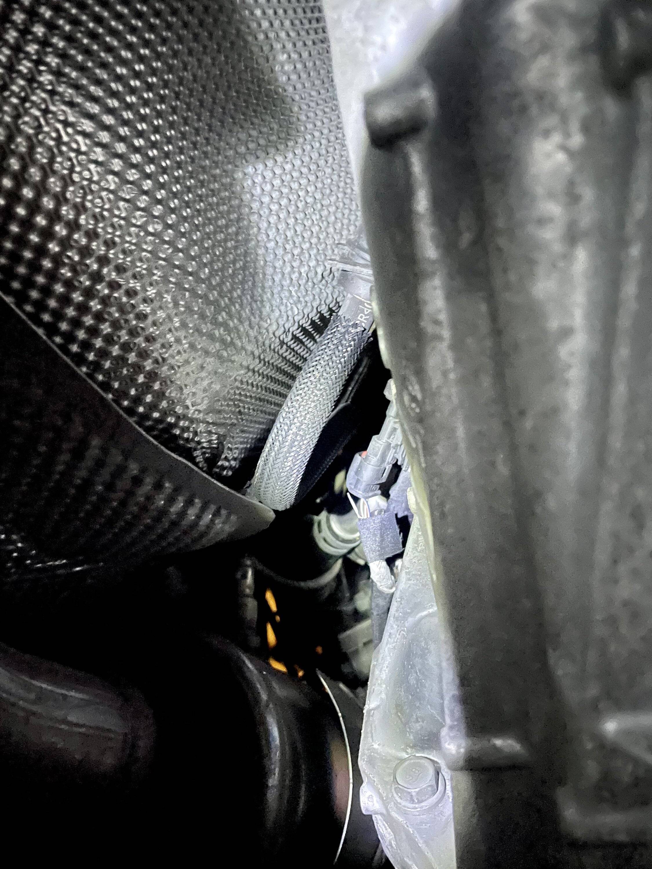

power steering. i called the dealership and they now have the jeep and i have a rental. i also found a sensor with a white wire hanging . any thoughts . i bought the jeep brand new .what a sad story for me

Clear everything and when the issue occurs see what is active. The connector you linked *appears* to be for one of the oxygen sensors, but I can't say for sure from the angle. There aren't any codes indicating it either. It definitely seems there's an issue with the electric vacuum pump/brake pedal sensor based on your symptoms and DTCs, but there's a lot of extra stuff in there that's probably unrelated.
Clear codes, drive until issue happens, and scan the vehicle then. Also, are you driving with a Tazer or anything plugged into the diagnostic port?

no tazer nothing plugged in port…ill pass this on to the dealership when they let me know what they found. ill we keep this forum updated
