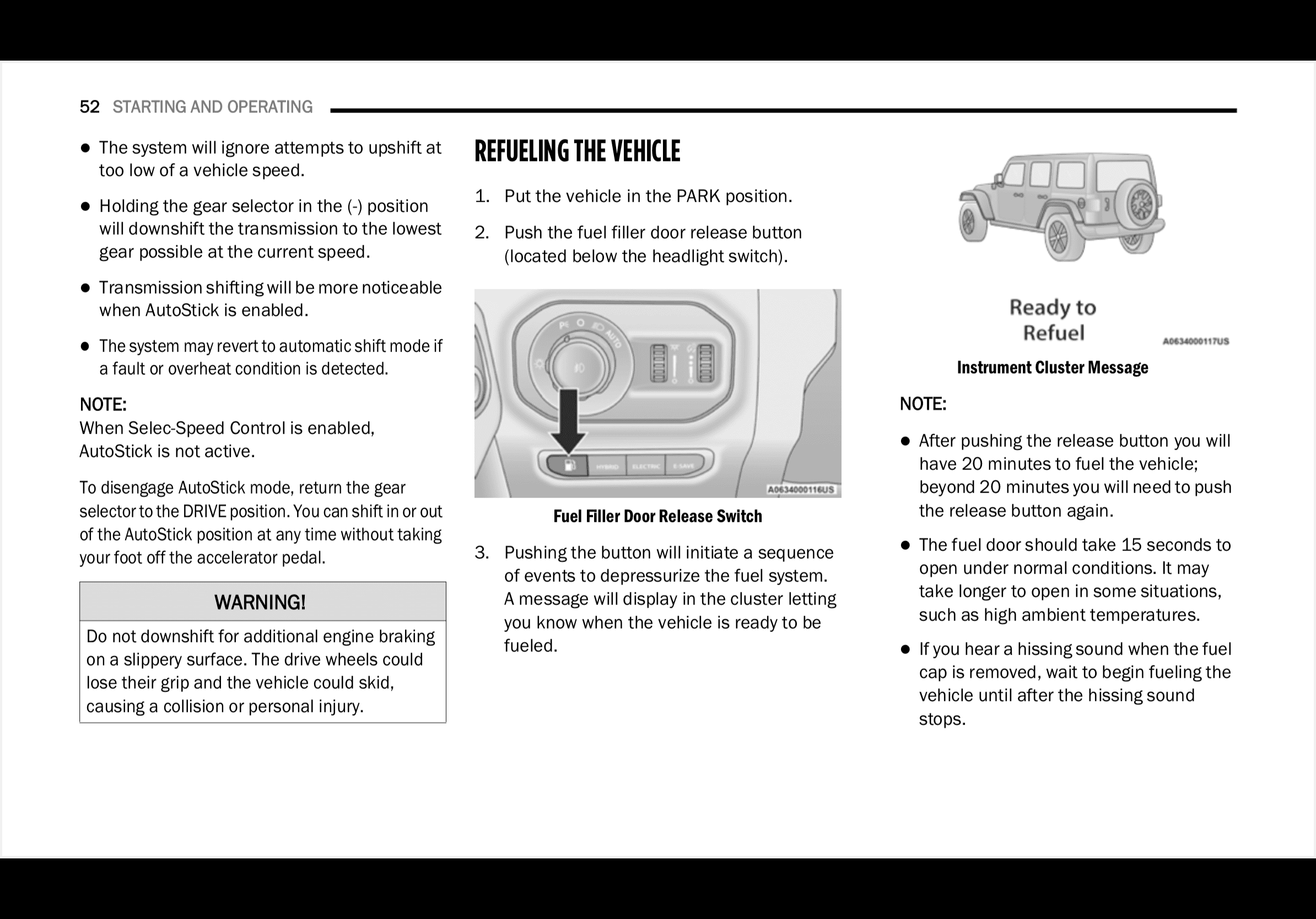

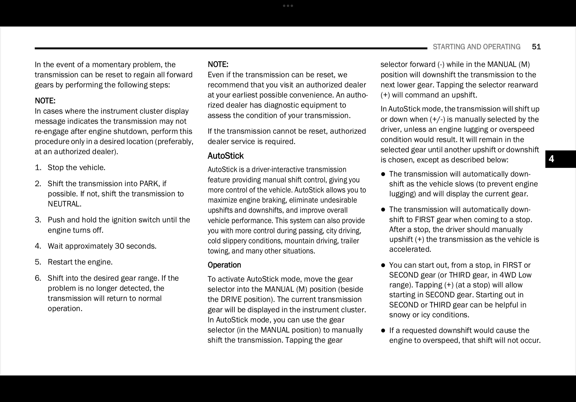

This should probably be it's own thread... but I've been prompted by others mentioning this
No self-respecting thread in this forum can go 20 posts without at least a slight detour, so let’s veer off-road for a bit…
I believe that shifting into manual mode on the transmission is an immediate startup and into service mode, so this isn't good.
I’m not sure that’s correct. Maybe someone else can confirm. I thought shifting into manual mode WAS the magic bullet that quickly and easily forces the ICE to start. I’ve used this method before with no problems, CELs, or error codes. Although, I’ve only done this at low RPMs, so maybe trying to force the ICE on under full throttle would trigger an error?
I actually prefer this method to hitting the E-Save button, since it’s safer, as I can shift into Manual mode without taking my eyes off the road. Are you saying that switching to Manual transmission mode, while the ICE is NOT running causes some kind of error or CEL?
Below are the two pages of the hybrid supplement section of my 2021 4xe owners manual. These are the two pages that discuss Manual transmission (AutoStick mode). I don’t see any warnings about not engaging AutoStick while in electric mode. But if I should NOT be doing this, I’d like to know! Thanks.

I also use the manual mode to get the ICE started... pretty often. It never occurred to me that there was a problem with that. I'd like to see a reference for the comment you're addressing.

e-save/eSave/E-SAVE will graceful warm up the ICE before putting load on it, where as shifting to manual will fire up the ICE and immediately put load on it.
There is no error, but maybe no a best practice.
It's explained in this video, the difference between hitting e-save and chucking it into manual.
---edit
If I know I would be using the ICE anytime in the trip, I hit e-save let it warm up, then put it back into hybrid, until I'm ready to use it on the highway, or race a Civic.
Not at all. What I'm saying is that by shifting to manual mode the engine is started and put into the drivetrain immediately. This is what I'm trying to avoid, at least when it's the first engine start, as the engine is stone cold. I'm simply trying to find the best way to cause the engine to warm up without load on it, before the jeep decides to make use of it.
