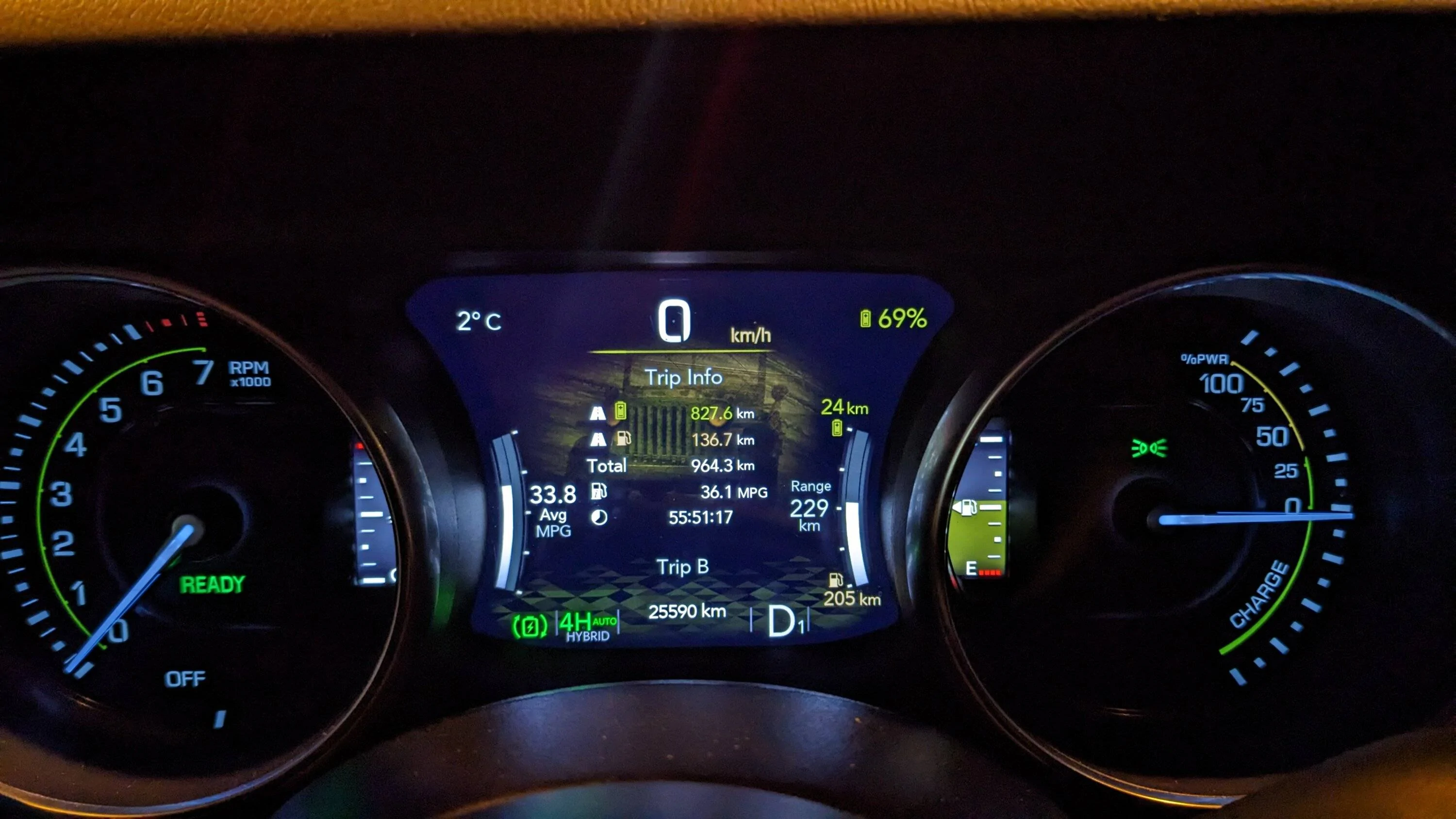

The 4xe is a PHEV, it's intended use is for mostly short trips that will use the battery, Regen(Max) works best in stop and go traffic, if you are always moving, there is nothing to Regen, it's that simple.
In cold weather, right now it's around -3⁰c - 1⁰c in Toronto, I use the heated steering only, I don't put the HVAC on, when it rains or get damp the Wrangler will fog up requiring the defroster, when I turn it on the battery melts away fairly quickly, if your trip is very short it's a non issue, I don't have a home charger, so depending on the distance I'm going, I'll decide if to hit e-save and run the gas, depending on the temperature, turning on the HVAC will keep the ICE on and sip the battery, some people including myself like this mode, some refer to it as blended hybrid.
The vast majority of my trips are short local so I rarely run the ICE, but I really like it when the ICE is fired up, one of the reasons I like how the 4xe behaves in sub zero temps like around -15⁰c.
This is what my January looks like so far. My ⛽ km is kind of high because I did a couple of highway trips. Usually my ⛽ km is around 100 or less. 25,000 km is also nuts in 14 months, I usually do about 16,000 a year, but this Wrangler is cheap to run on battery, so I just joy ride aimlessly.

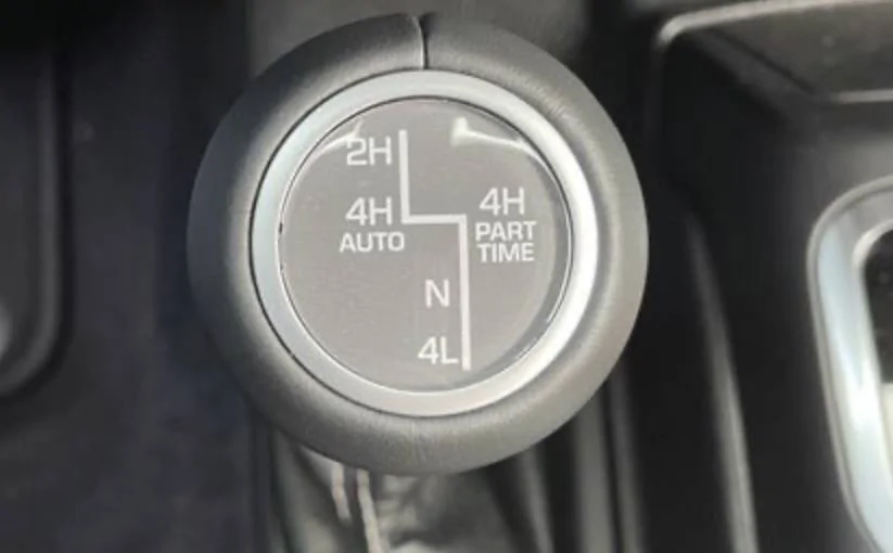

That kinda sucks about needing to be an n 4H to access all the power. Not sure Wranglers are designed to be run in 4H most of the time on road and I suspect it also reduces gas mileage.
Just to be clear, this is not part-time 4H. You are absolutely correct that you would not want to use part-time 4H 24/7, or on dry pavement. I’m referring to “4H Auto”. It’s more of a software controlled AWD that only sends power to front axle as/when needed. Perfectly fine to use it all the time. There may be a very small MPG penalty. Not certain on that. Here’s a pic showing the different drive modes:

That helps a ton. Thank you. That kinda sucks about needing to be an n 4H to access all the power. Not sure Wranglers are designed to be run in 4H most of the time on road and I suspect it also reduces gas mileage.
The 4xe can be run in 4H Auto all the time. I have had mine set since day 1 and never looked back. If you look at some of the 4xe Fans videos on YouTube, a lot of work was done testing the mpg difference and it’s negligible. From what I recall, Jeep engineers were going to eliminate 2h altogether because of how little a difference it was.
