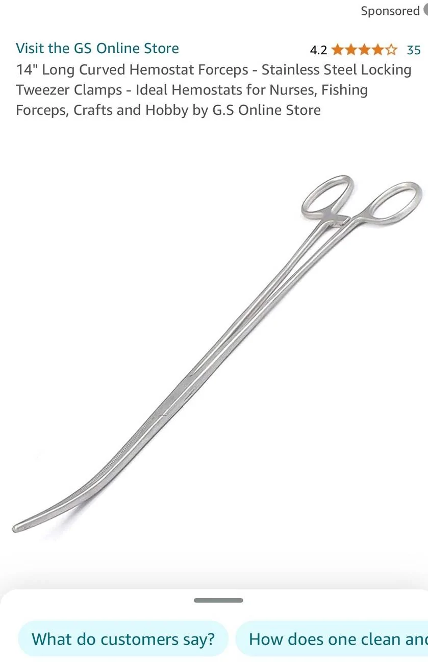

This is what I used the first time. They come in handy for multiple situations. But like everyone said, get the extension and make your life easier.

Get a set of 18" forceps from Harbor Freight. Make it so much easier...
