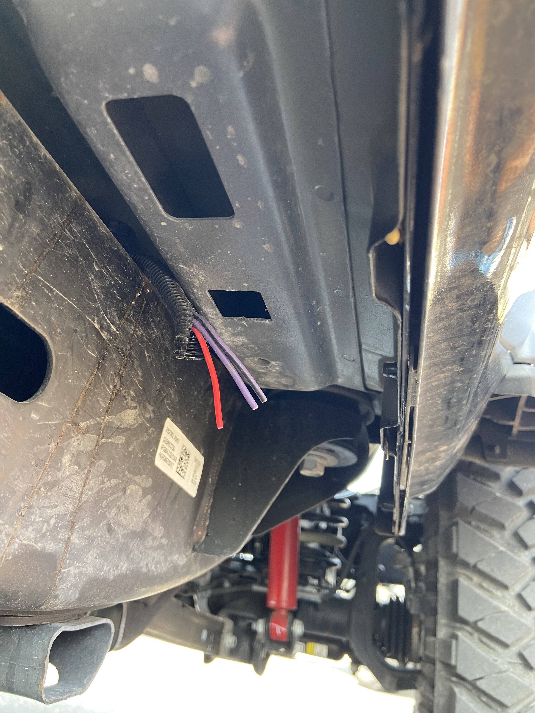

Here's a pic of the wires.

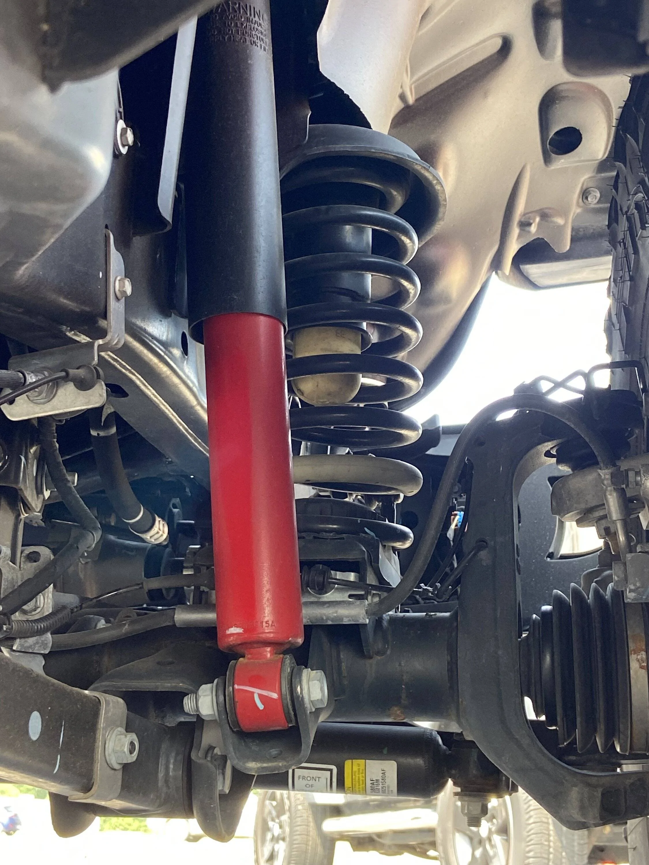

Here's a pic of one shock with oil residue.
Jeep Wrangler JL Concerns with a 4xe, need advice! F8190D1F-2C25-41D6-9451-4EE92A8E1509

Looks like you've got a good eye. bad shock, for sure. I don' t know what those wires are for - that looks like consumer split-loom rather than something factory, but the color-striped wires aren't often used with add-on accessories - so that needs to be traced to determine what it is. Maybe for lights or power steps or maybe run in through the floor drain plug to the interior.

Double purple wire is for AMP Research powersteps. They use that wiring harness for all their steps. They should route near your ODB port, they likely removed the steps and said to hell with the wiring.

Hi BigMaCro, thanks for the response and information! I think that's a good call regarding the power steps. In the dealer website pictures there are rock rails that actually look like power steps however when I went to test drive it, they were mysteriously missing. Also seems a bit strange for a CPO vehicle that supposedly went through a 125+ point inspection, one or more bad shocks were overlooked but in all fairness, that's not to say they didn't fail after the inspection... Anyway thanks again for the info, I'm learning as I go like most beginners but greatly appreciate this forum and the Jeep community!

If its been sitting for 4 months I'd worry about the 12v battery. I'd factor in replacing that after purchasing. Also those look like the stock rubicon shocks. Did they listed what kind of lift was installed?
Hi ZR2to392, thanks for the detailed info that's good to know! I just messaged the salesman also as I'm sure those aren't cheap. Who knows if they were stolen off or what but I'll definitely use that info for negotiation if the Jeeps checks out otherwise.
Hi sconrad24, thanks for the response and advice! So should I ask the dealership about the 12v battery and if they will replace it or best to do it myself or elsewhere?
They didn't know the brand of lift or everything involved but seemed quite confident it was a 3" lift somehow. I'm skeptical at this point and I agree about the shocks, I was expecting to see something not red after hearing about the lift.

Do you have any more suspension pics. No way it's 3". Those tags are stock springs and you'd be riding the tops of the shocks without extensions. My guess from what you posted it's stock with some wheels/tires slapped on it.
I assume your getting a killer deal to not look at new?

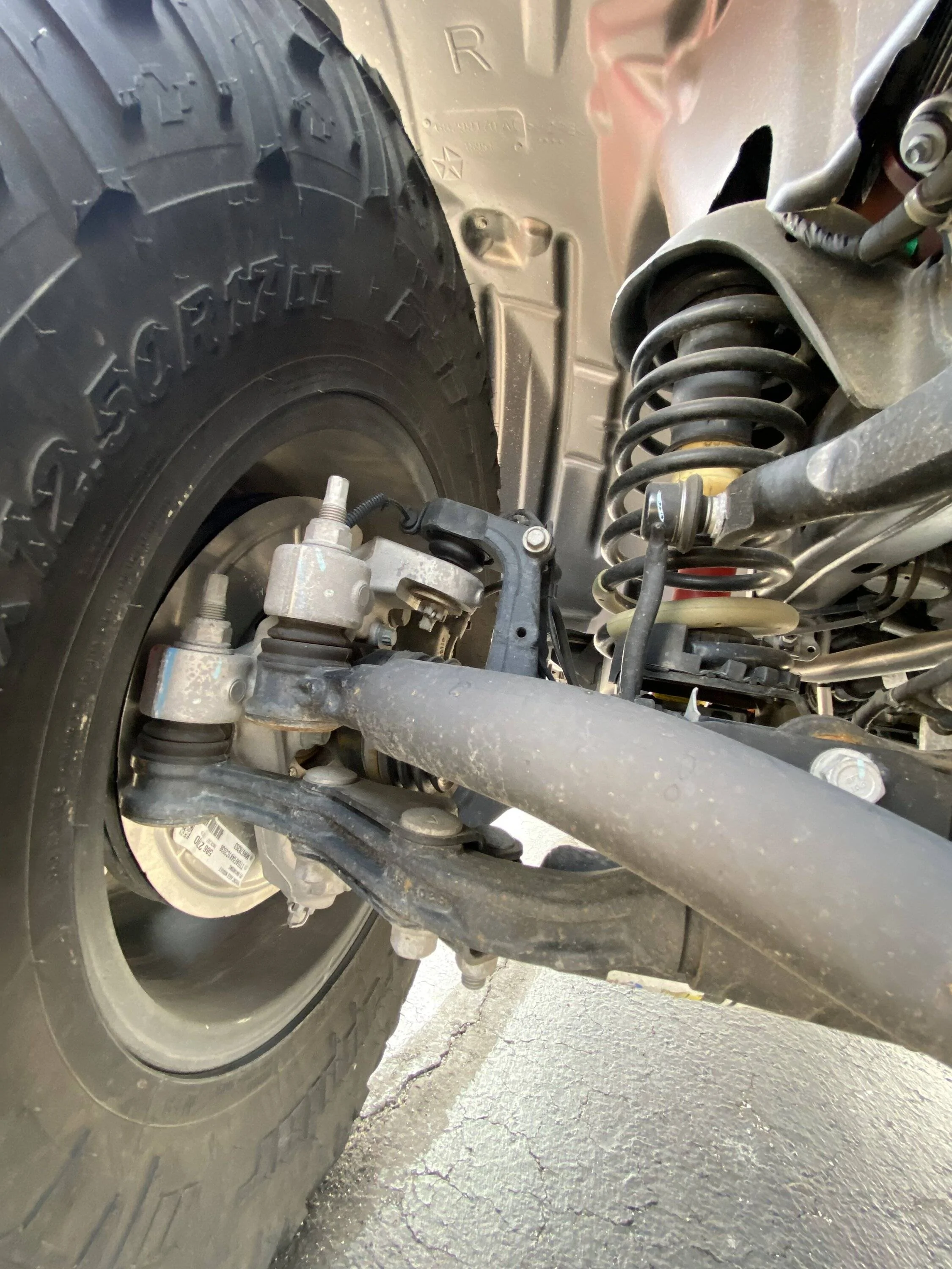

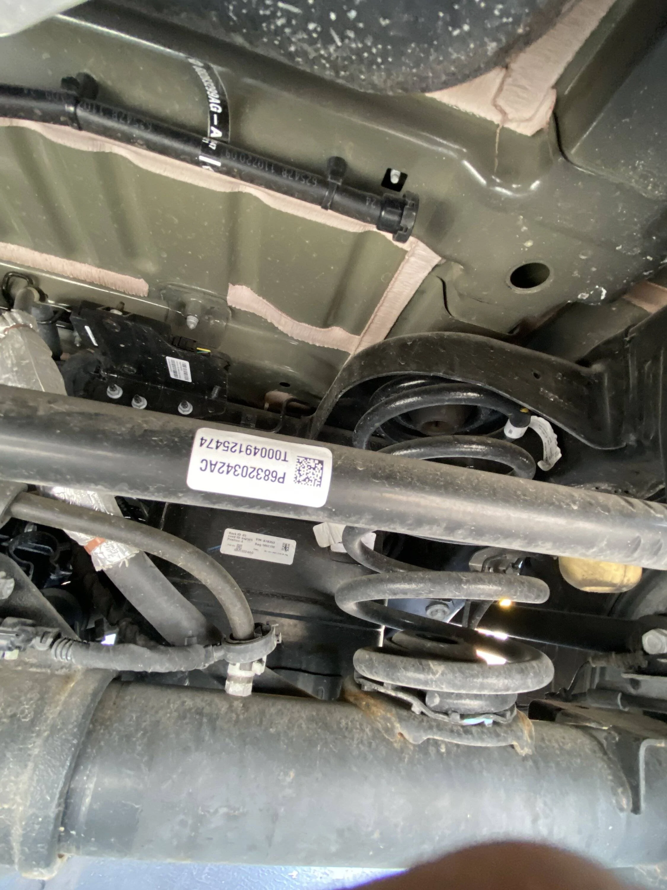

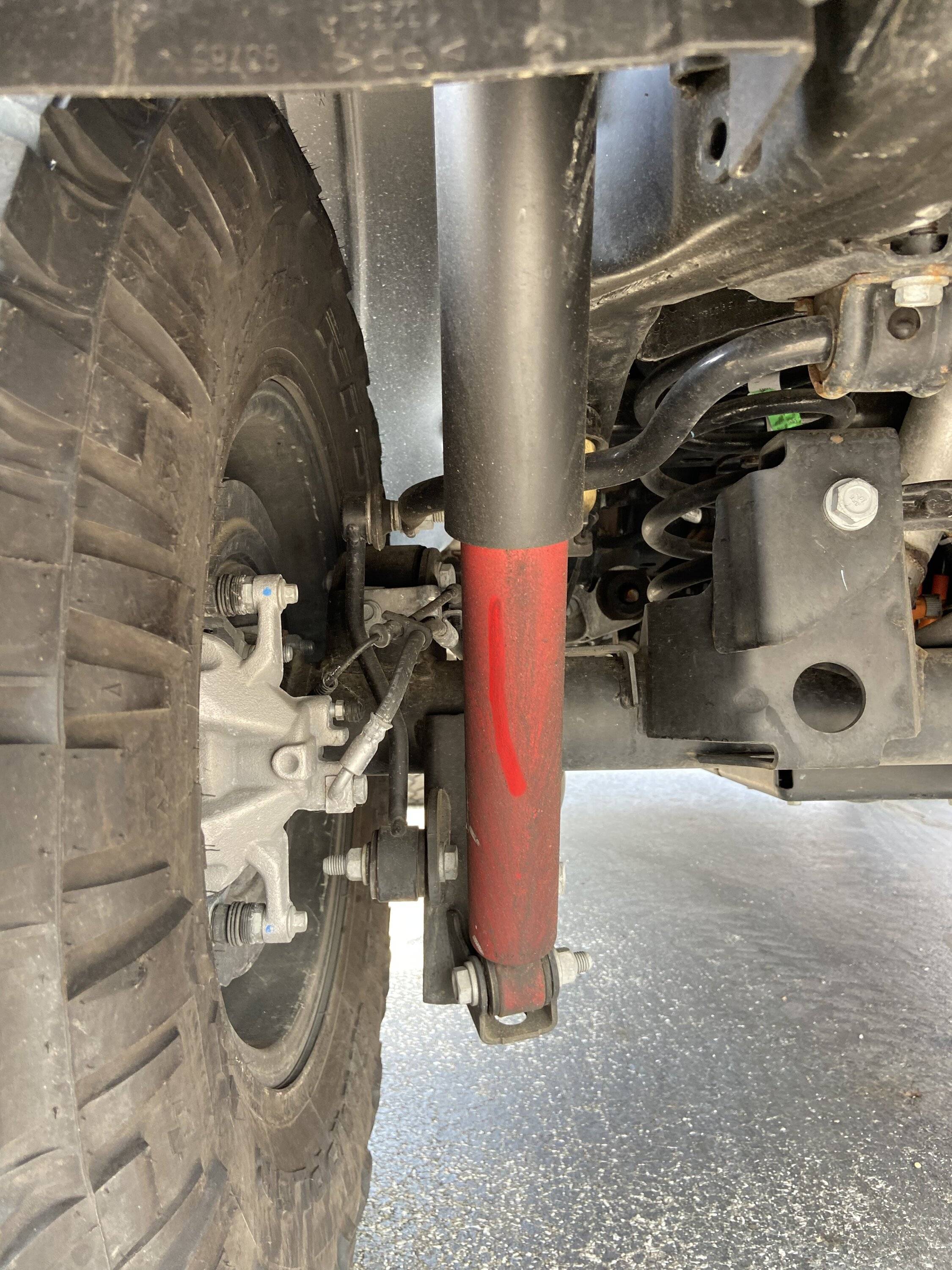

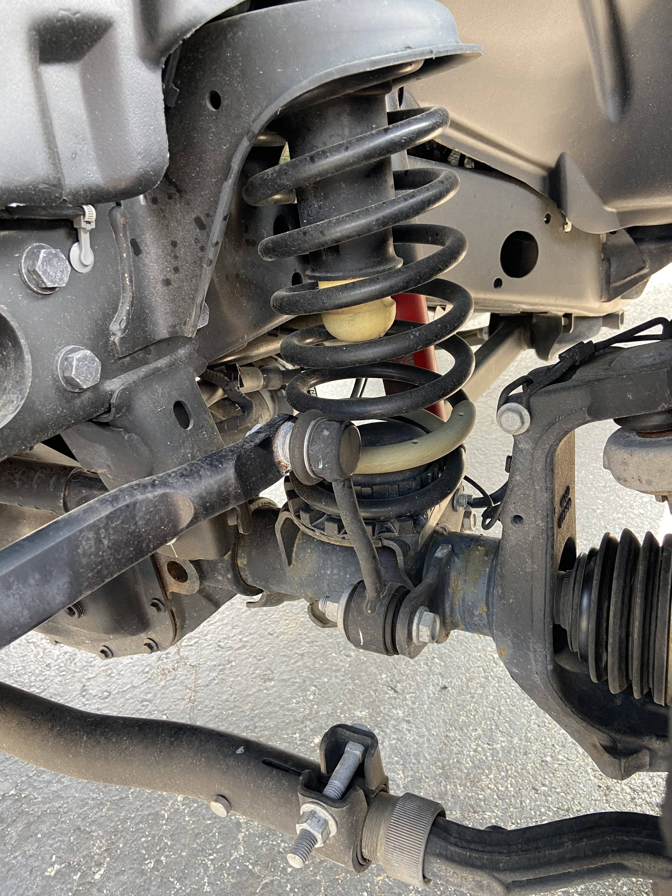

Hey GATORB8, thanks for the response and info. I think I have a few more suspension pics, not great ones, but I'll add those and greatly appreciate any insight, cheers!
Jeep Wrangler JL Concerns with a 4xe, need advice! 84F8AA7E-FE84-414F-A0AB-6C73813026D3
Jeep Wrangler JL Concerns with a 4xe, need advice! 86F95F5A-F20D-42E0-8EC0-EC445D01AAB5
Jeep Wrangler JL Concerns with a 4xe, need advice! 5E2A387B-DB68-4359-8FEE-35F988E7A4D3
Jeep Wrangler JL Concerns with a 4xe, need advice! EC441A98-8651-4820-A971-AE4FAE09F50A
GATORB8
May 30, 2021
8,833
11,733
CLT NC
21 JLURe, 06 LJ, 25 HDZR2
Hey GA
Bone stock.
