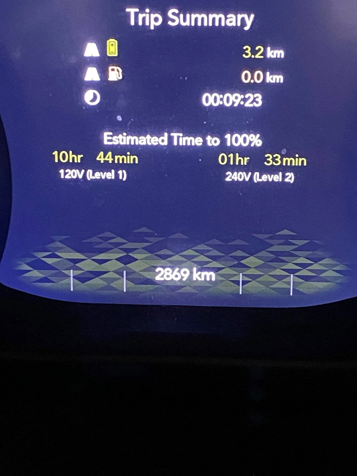

PS - My advice -> get a level 2 charger. See below. I just came home around 16:00 local time with 35% battery life remaining. If I want to go out for dinner, below are my charging options:
I think I'll go with option 2!

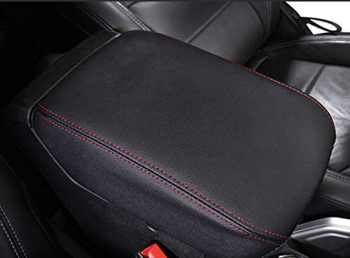

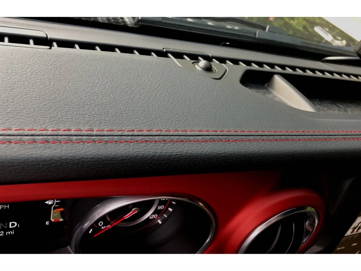

Question, I have a 4XE ordered but with the cloth seats (not a fan of the leather as it can hit 117 in the summer here) but I would love to upgrade a few parts from the leather option. Would any know the part number for the following?
Top Pad Trim Kit Rubicon In Blue Stitching
Center Console Armrest In Blue Stitching
These are the part from the Rubicon in Red Stitching just need it in Blue.
