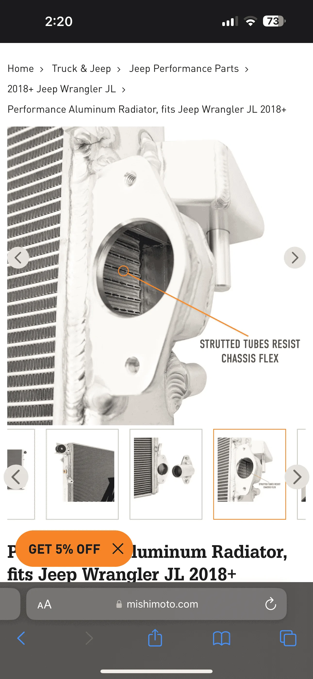

Wonder if the mishimoto is prone to cracking like the cold case then cause my plan was always to swap the radiator around 80,000 miles as preventative maintenance to avoid being stranded.
Jeep Wrangler JL Cold Case or Mishimoto radiator? IMG_5887
