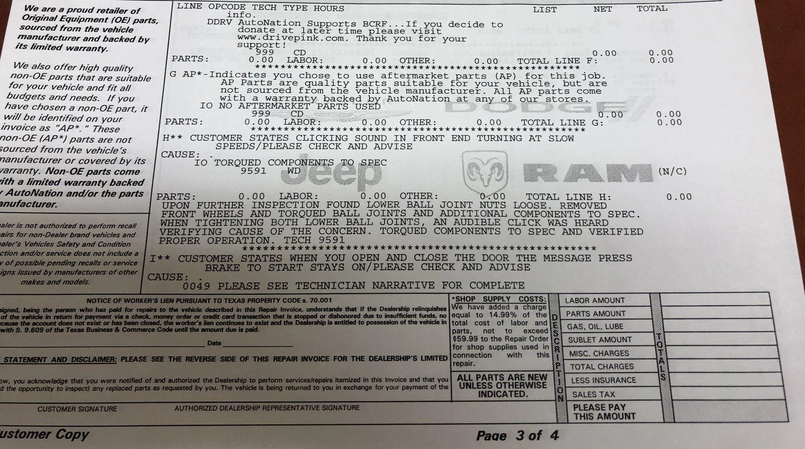

Well just picked up my JLU after several days of service work, I think it sat a lot but I need to move on.
I want to thank all the guys here that did a lot of the leg work for me, here is one of several pages for service but according to the tech notes he found the ball joints not torqued to spec, I actually showed the service manger the vid that @Jason posted ( see post 31) and he said he would show the tech, well after checking all the front end stuff they reported the castle nuts not torqued to spec or I was at least told that and it’s listed on the ticket, I did look at the cotter pins when I got home and they appear to be new and only bent once so they either used new cotter pins or told me a bedtime story but I don’t here the clicking so I am going to say it’s fixed for now.
Thanks guys and especially Jason for posting the vid, I am hoping this problem is solved.
Jeep Wrangler JL Clicking noise when turning. F73214C5-29D9-4937-87F2-3EEF1208298B

My Rubicon is doing the exact same thing, that clicking is driving me insane. Mine is 100% stock does at low speed left or right turning. What was your fix from the dealer??
As you can see from my service ticket the tech advised the wheels were removed and then the cotter pins removed and castle nuts were torqued to spec and then all put back, I did inspect the cotter pins after service and they appear new as it they don’t appear to be the old ones removed and reinstalled.
I washed it last night so when backing out of the garage and pulling forward I turned the wheel slowly as well was going backwards/forwards and did not hear the clicking so I am hopeing it’s been corrected.
Eldyn
Jul 13, 2018
Columbia, MO
2018 JLU Rubicon
I had this same issue. When rolling or moving slowly there was a loud clicking if I turned left. I saw on an earlier post someone mentioned the ball joints so I let the dealership know when I dropped it off for service. Sure enough that's exactly what it was. I've included a picture from the ticket. Hope this helps!
