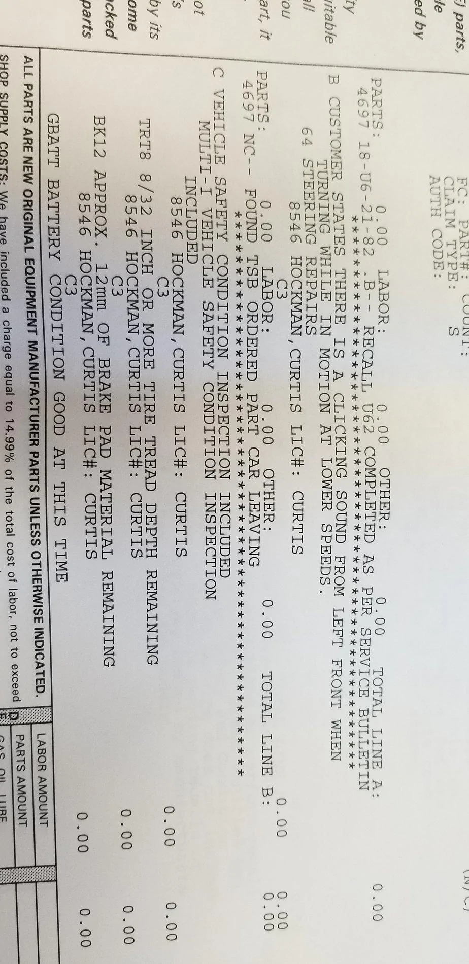

Any word on what this issue is from your dealer?
I need to look on the sheet again but something to do with the coil or mount. He said he had to order a part so I go back July 12th.

I tried looking and couldn't find a part no. but I'm taking my Jeep in next week for the same thing so hopefully its not too long of a lead time
Yea it didn't really say exactly what and the service writer I talked to mentioned something with the coil. So not sure.

Took mine jeep in friday for the same clicking sound they are going to replace the u joints will go back next friday to get them replaced.
