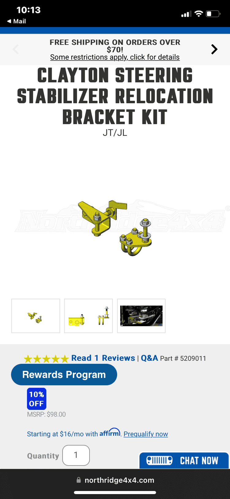

Anyone install a Clayton stabilizer relocation bracket with a TS stabilizer like teraflex? Hard to tell from pics or videos if they are compatible? Thanks

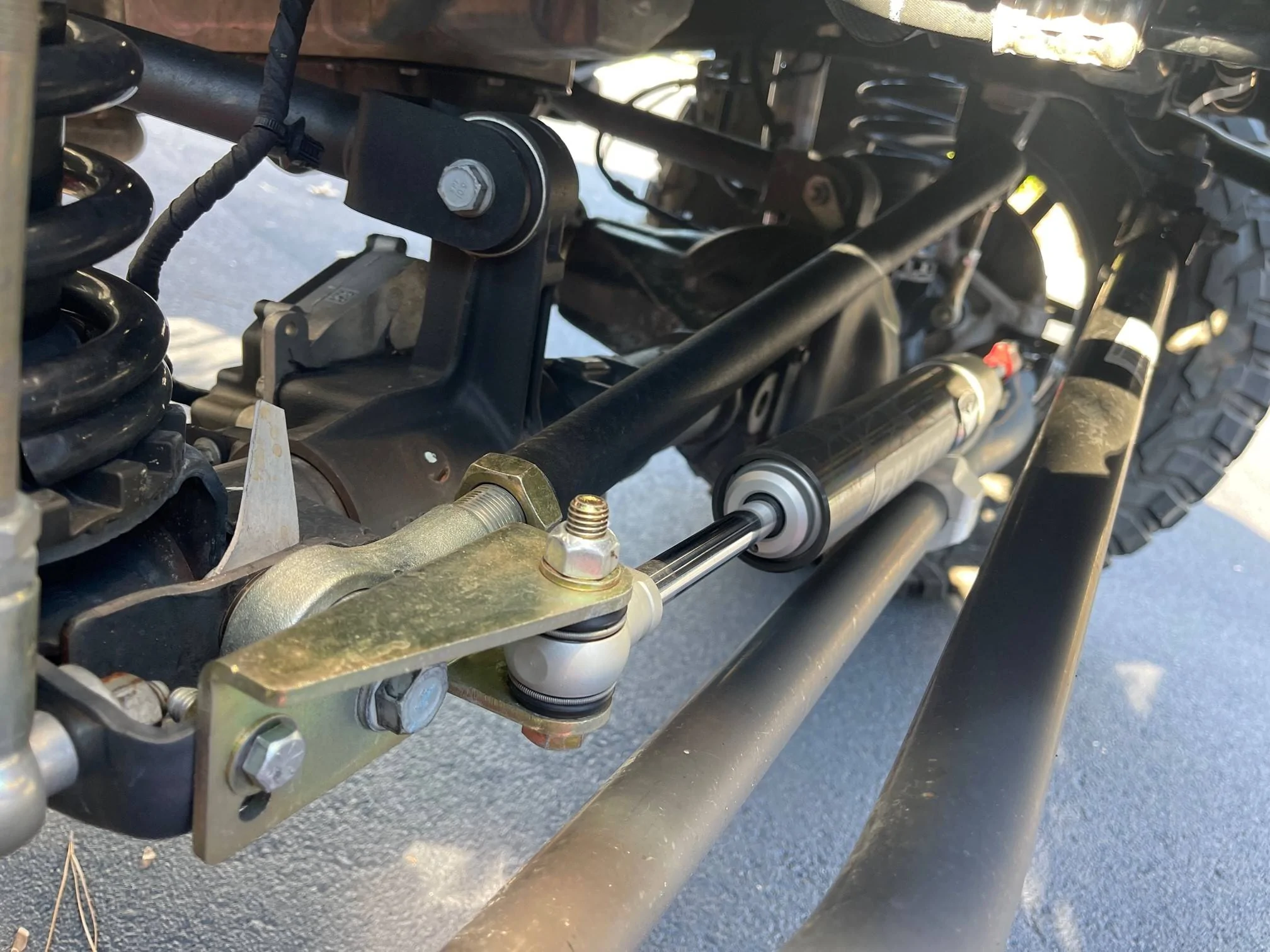

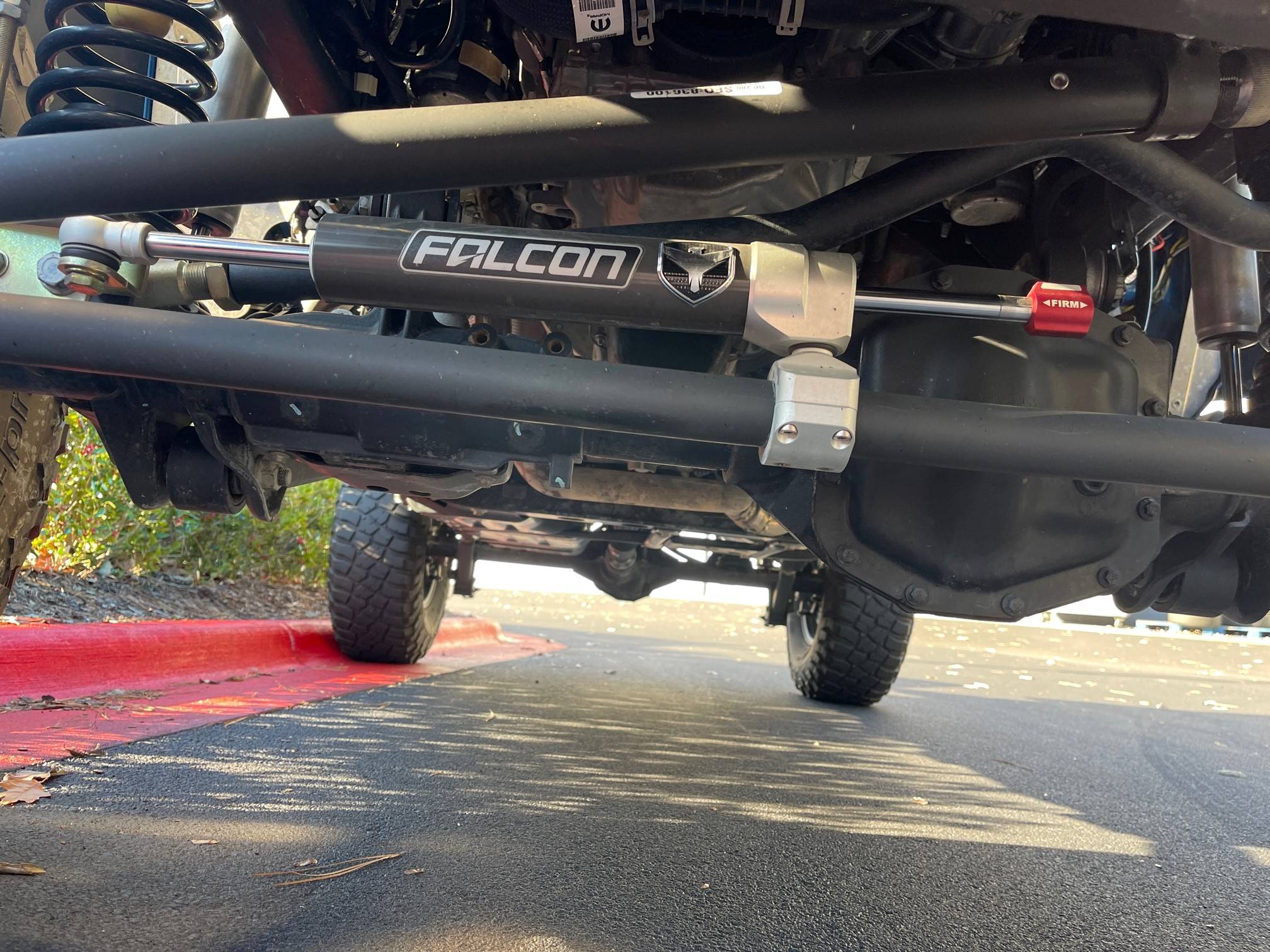

I'm running the Clayton's relocation bracket with a Falcon SS.

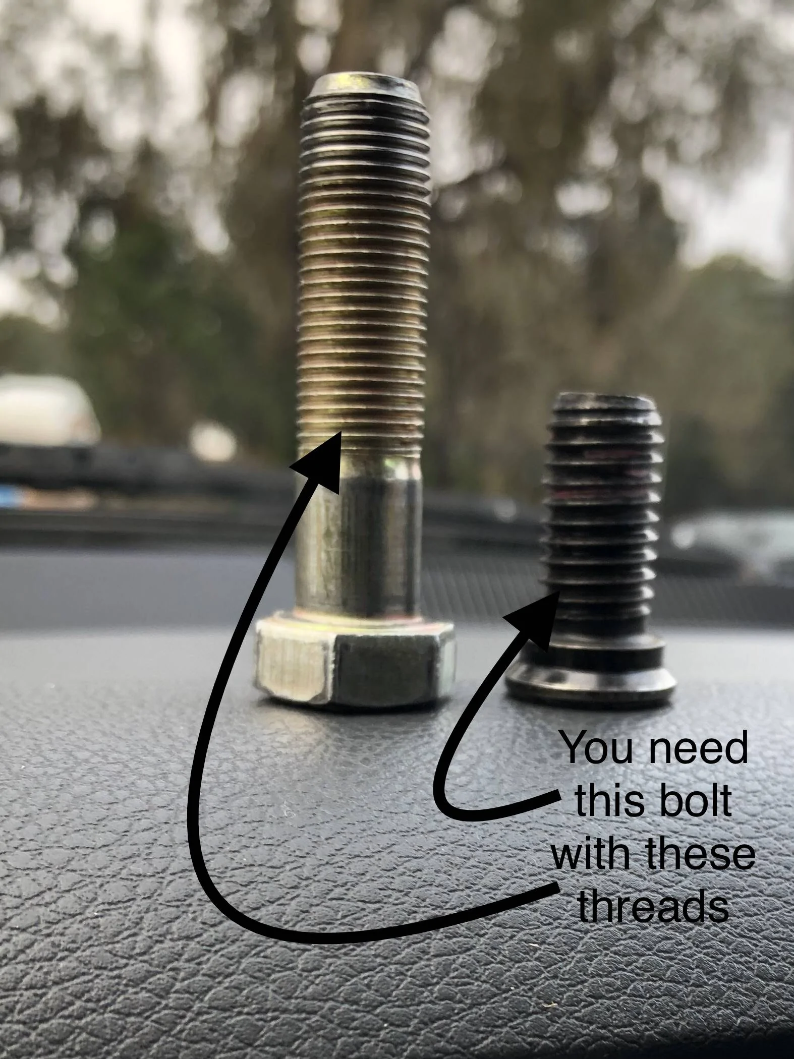

If you would order one for JK then it will come with its own tie rod clamp like @beast40 pic….. the Clayton clamp in your pic won’t work on the tie rod because of the stud sticking up,….. if you ordered a ss for JL you’ll have to modify it and source a tie rod clamp and a flat head bolt….a clamp like synergy and a bolt like in pic…..
