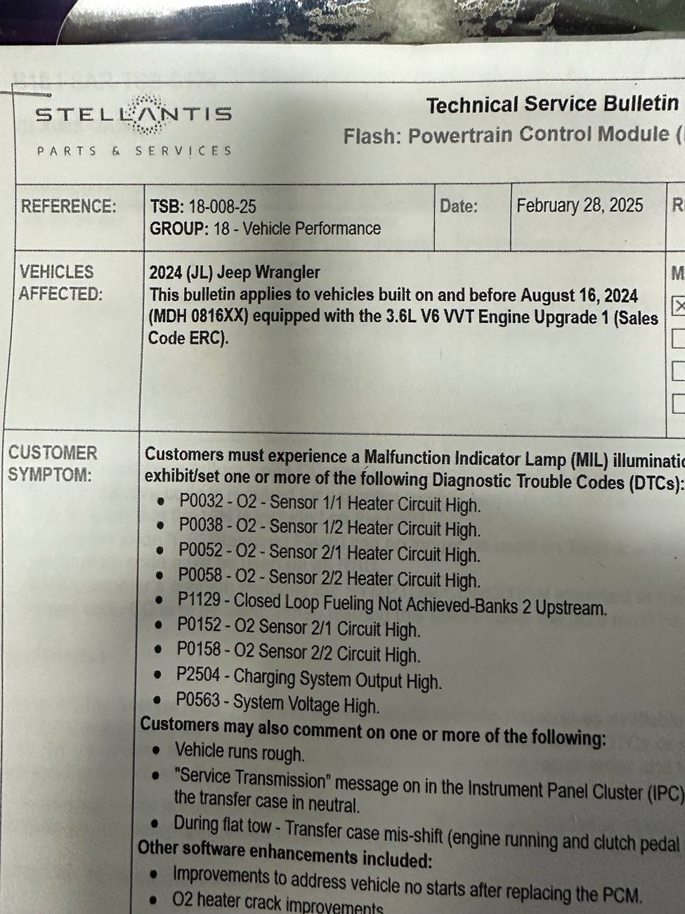

Any ideas or updates on what it was?

lots of 24 3.6's had O2 sensor issues...mine included
