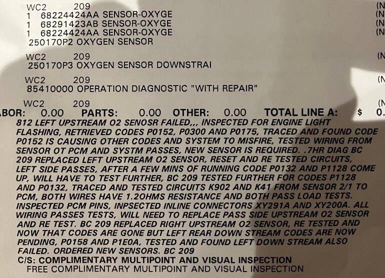

UPDATE: Dealer ended up replacing the 3 o2 sensors, and did extensive testing through driving, scope and other tests. Everything tested fine and consistently within spec. No explanation for the 3 failed sensors other than it could be a manufacturing issue as some others seem to have experienced. Jeep runs like a gem again. Pic is of the diagnosis and engine codes for reference.
Jeep Wrangler JL UPDATE - check engine blinking on 2024 JL 1718373151421-uv

We’re living in a time where even freaking O2 sensors are on back order. 🤦🏻‍♂️
A significant amount of parts are on back order. We haven't been able to get thermostats for the 3.6L for nearly 2 years now.
A bunch of suppliers have started to refuse dealing with Stellantis due to them freezing pay. Usually when these parts fail the vehicle is well outside of lemon territory so they don't care if the part takes 6 months to come on. They'll wait until a large enough quantity are needed, pay to make a batch in bulk, then not order any more until that supply is completely depleted.
