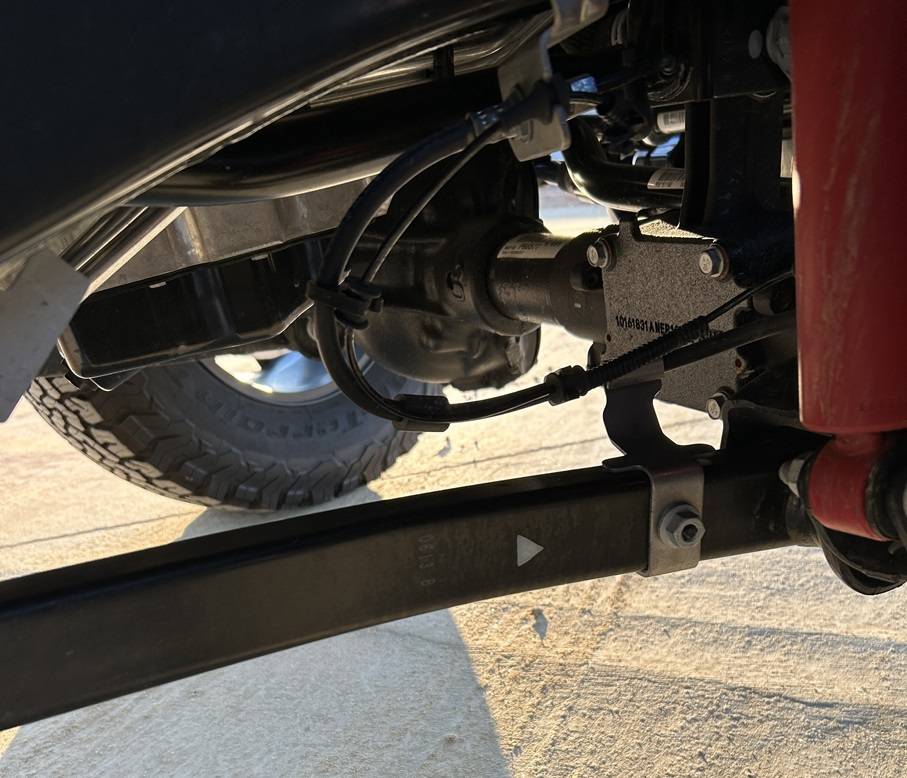

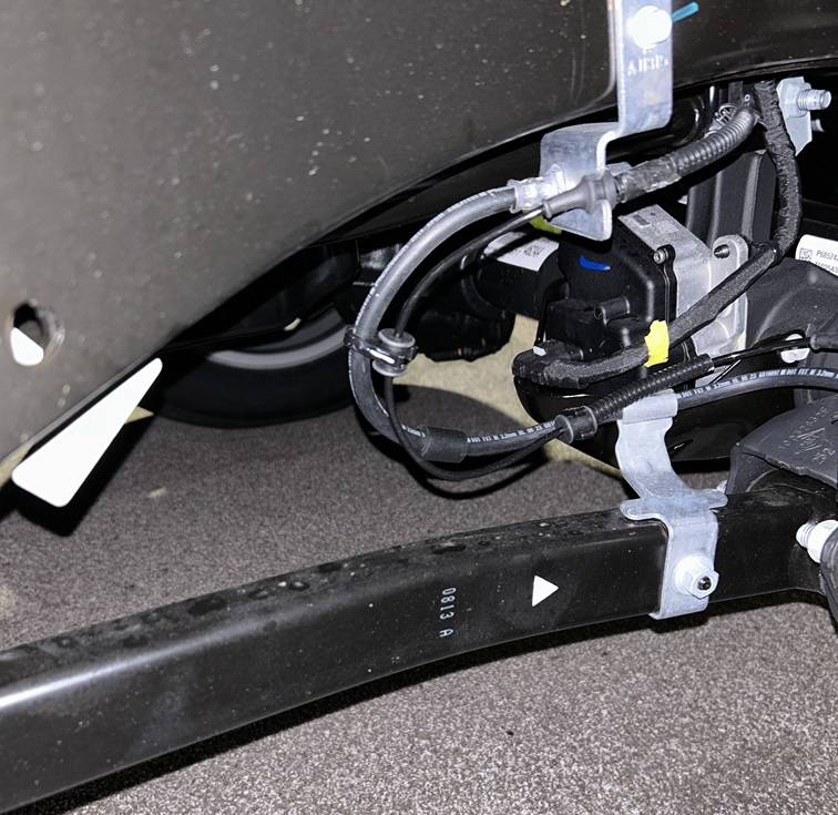

I noticed the LCA has a different part number on my 2024 Rubicon but the length is still 24".
Jeep Wrangler JL "Changes" to 2024+ Wrangler 2024RedRubicon_LCA_FAD
The 2024 Sport has the FAD still but the part number for the LCA is different than a Rubicons.
