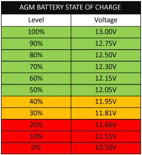

Think a failing battery can also cause a bunch of random check engine lights, so that might be something to test and/or replace.
Not 100% sure how reliable the voltage read-out on the center cluster is, especially for the eTorque, but for my '23 v6 eTorque, after letting it sit overnight, then pressing the "run" button once (without foot on brake) has recently been showing ~12.2 to 12.5V. Really no idea if that's an accurate reading from the 12V battery by itself or just a reading from the 48-to-12V converter.
The OEM 12V AGM batteries are known to not last very long and probably more so if not driven regularly.
Came home about two hours ago after driving around for about 2 hours. Battery is sitting at 12.2 volts. It will be interesting to see where it’s at in the morning.

Sunday morning the gauge was showing the battery at 11.8 after sitting overnight. I’ll probably replace the battery just to rule that out. However that seems like the most likely culprit.

Yep, Zack. I'm pretty sure no good battery should be showing 11.8 after sitting overnight. Put in a high quality H7, and you'll be good.
