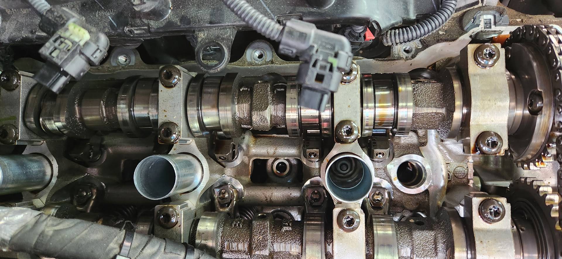

Do you happen to have the camshaft or a picture of it by any chance? It would be nice to know if it was exhaust or intake that failed, for trend analysis.

Jeep Wrangler JL CEL & engine knock - and $746 hasn't fixed it 20230105_144402
Did get a shot...I am far from a car guy especially when it comes to the new-fangled contraptions so hopefully this will show what you're looking for

Good god that’s bad. I hope they flushed a few gallons of oil or solvent through the block. Interesting that the newer type intake rocker is what failed, clearly on the primary roller bearing. Absolutely wrecked that cam lobe.
