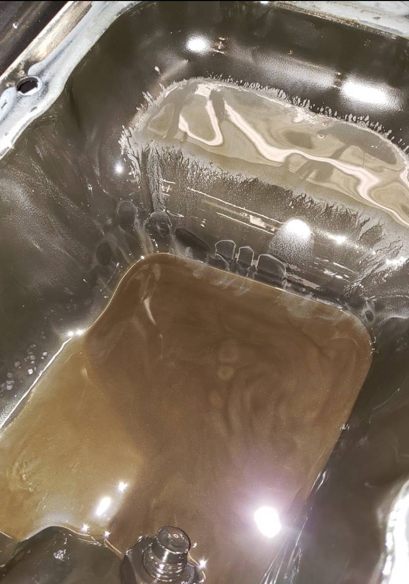

Have them drop engine oil pan and look for sparkles..Kinda like Granet Chrystal. Mine has air fuel codes as well as O2 sensor code when the cam washed out. Good luck hope this is not what your dealing with. Picture of what mine looked like.
Jeep Wrangler JL CEL & engine knock - and $746 hasn't fixed it Screenshot_20221215_134640_Photos
