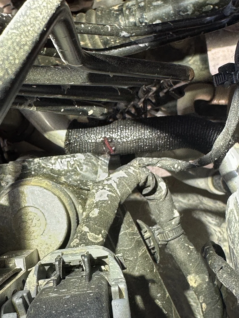

Coolent for the 48v system was very low. Going to add some coolant tomorrow and see if that resolves the issue.
It will resolve that fault, yes, but now you have a leak that needs fixing.
Found it.
it appears the line was rubbing on the corner of the factory bracket/mount.
