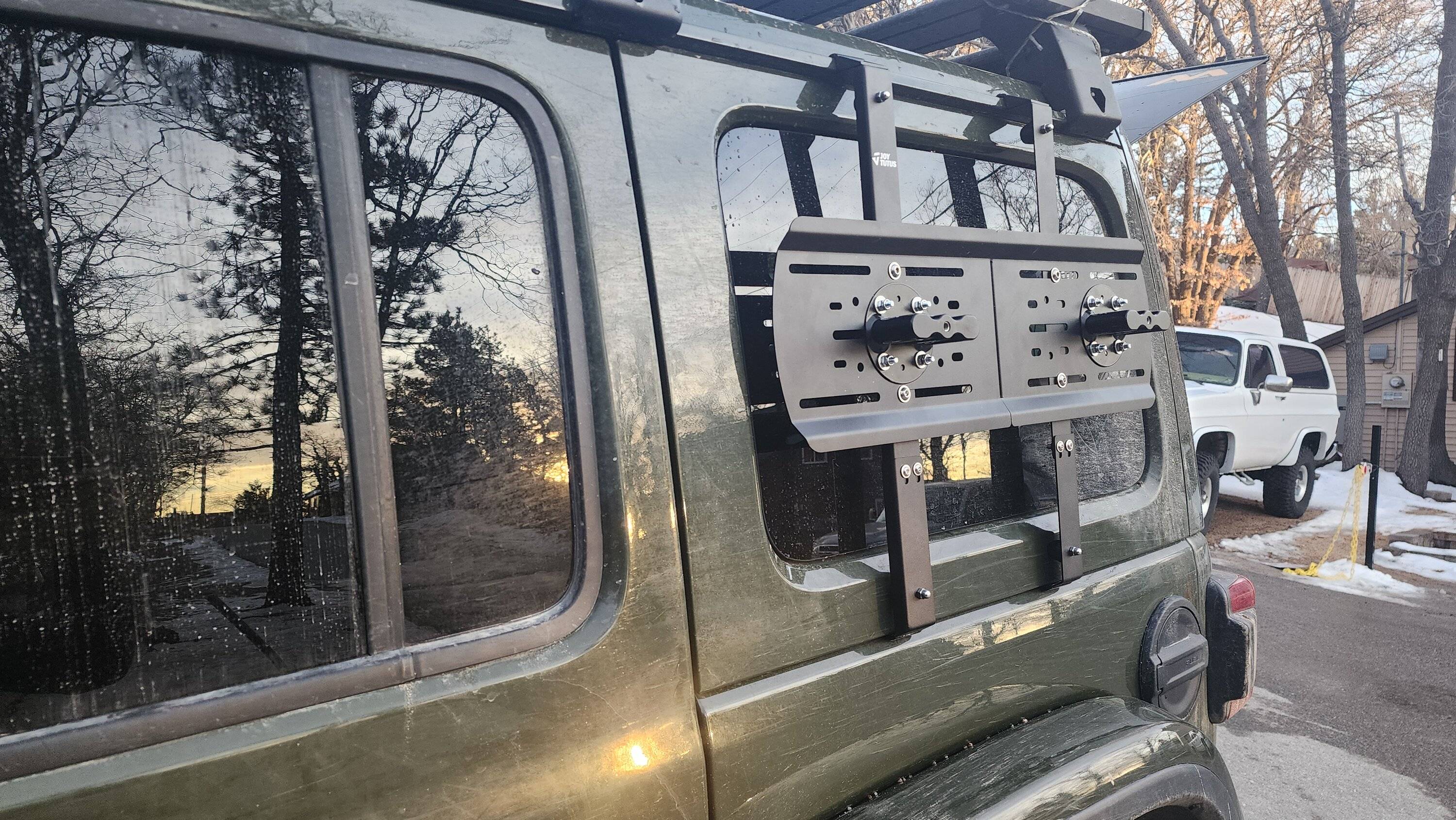

My plan was to mount Jerry cans to my roofrack.
Unfortunately my wife bought me 2 rotopax and a mount. My issue with rotopax is that their nozzles are garbage, and they leak.

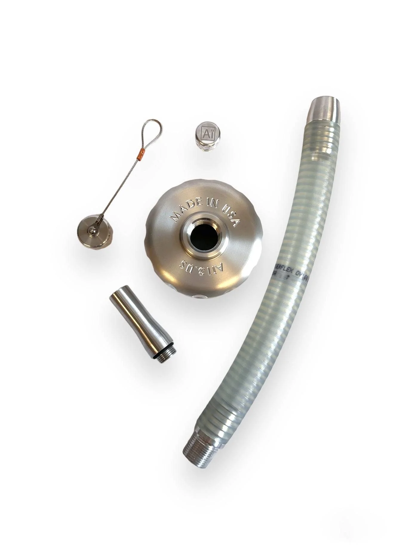

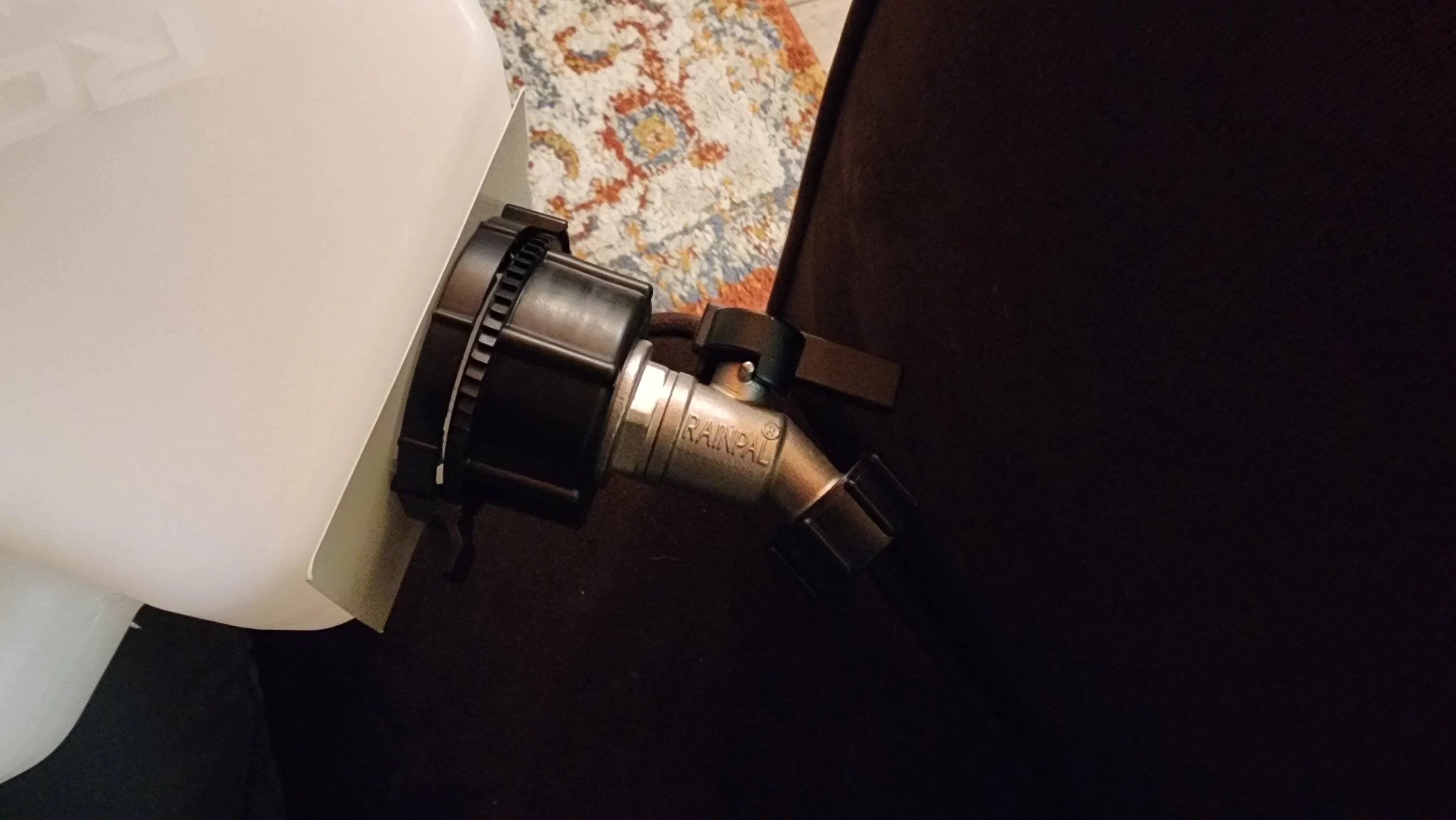

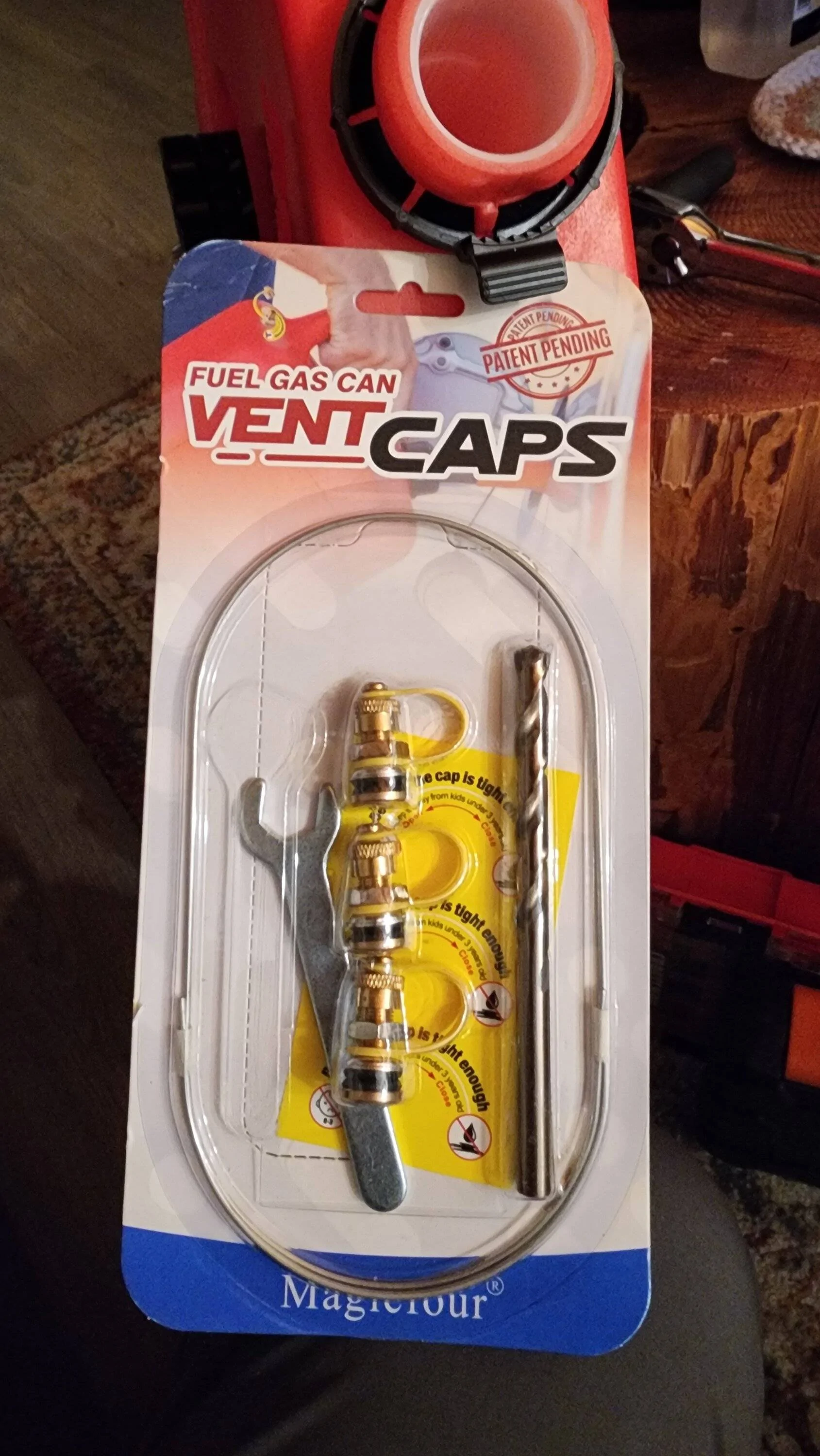

So I had to buy an aftermarket nozzle, and install vent caps, 2 in each (top and bottom). So you can vent while stopped on the road, and other for when you're dispensing fuel/water.

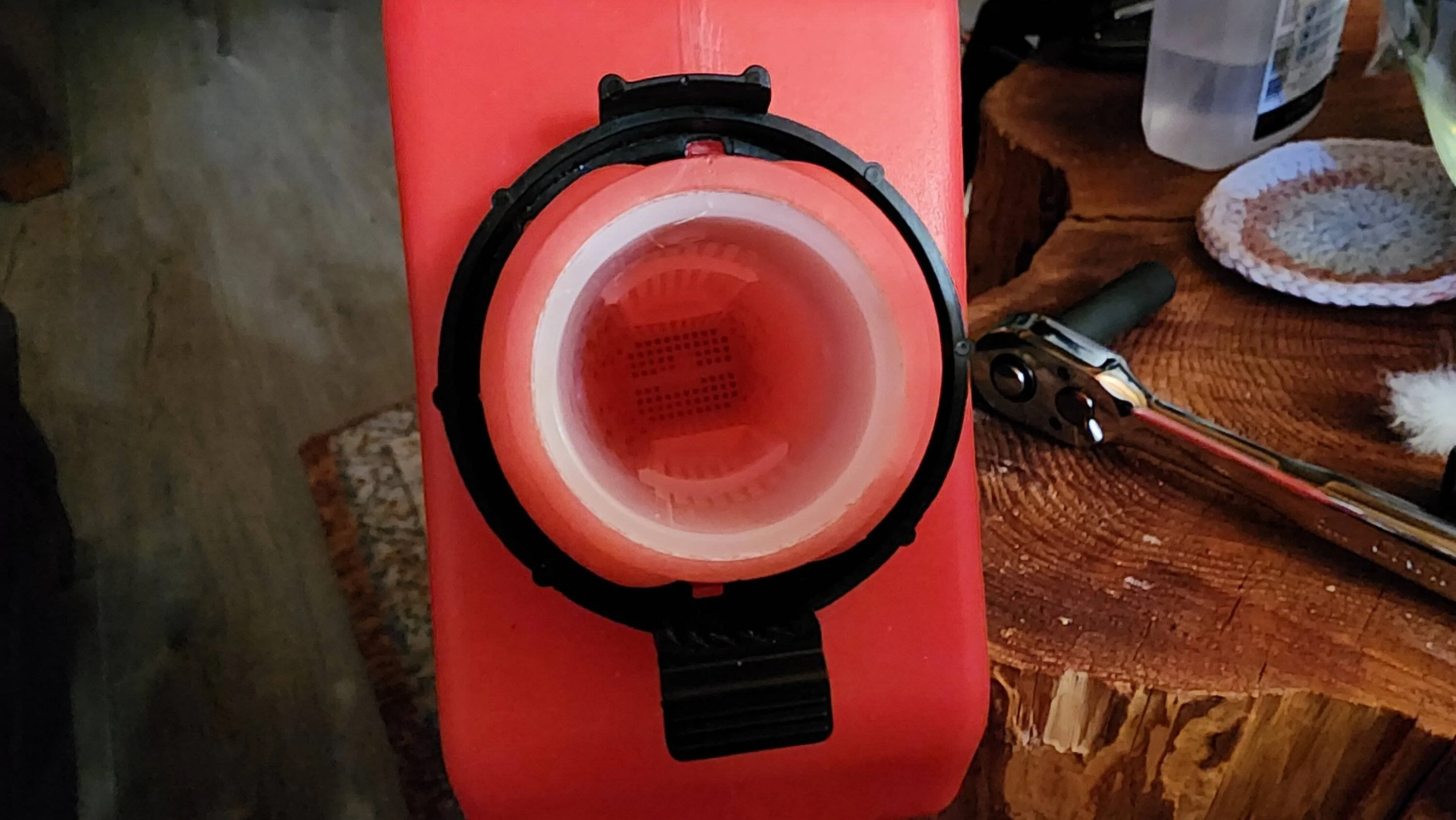

The fuel pax has a flame mitigator, which is a huge annoyance (gen 2 models). I ripped it out (illegal) to add my new nozzle, which is WAY better. I used the Billet ai13 nozzle, all metal.
No more leaks.
