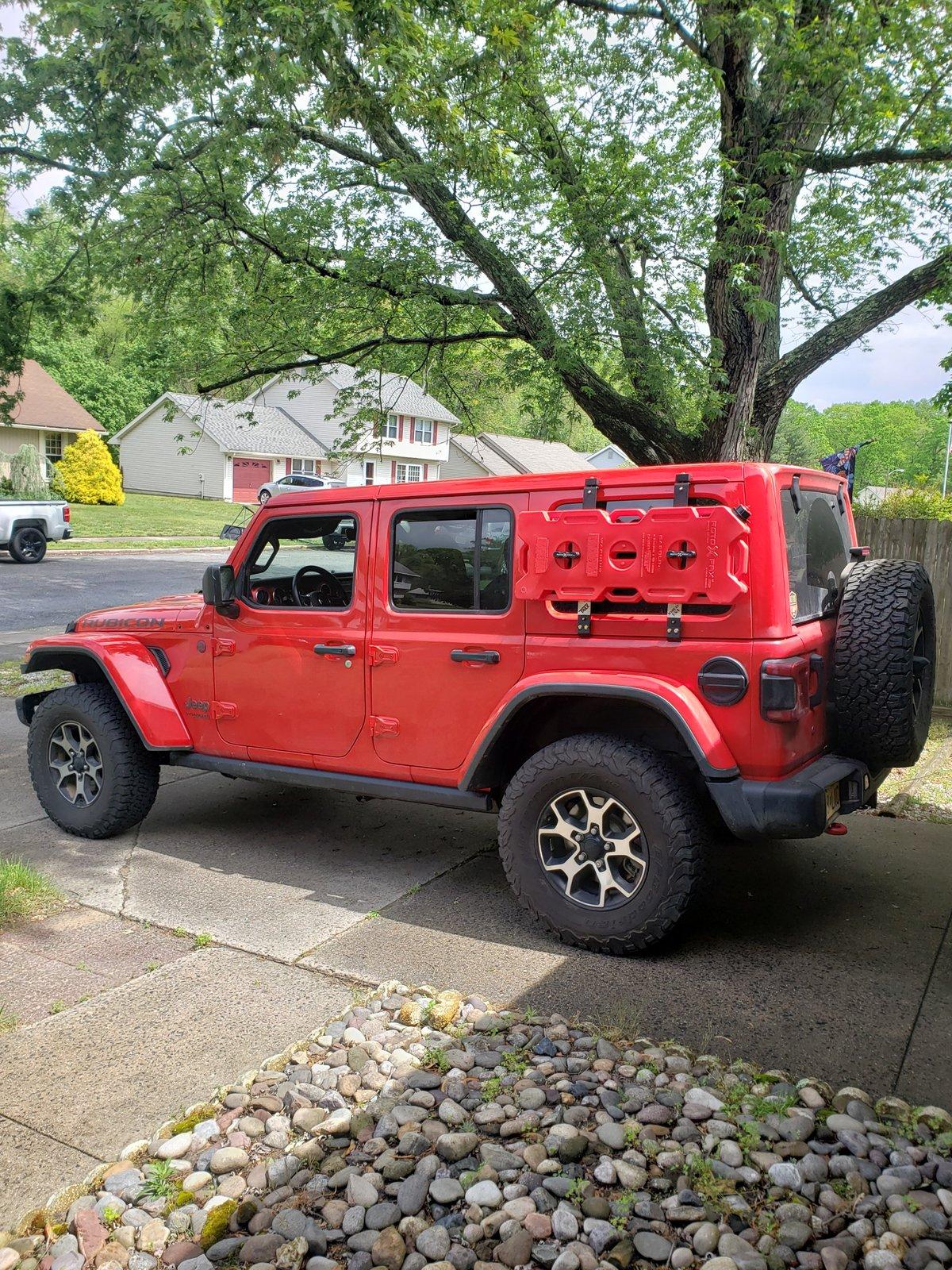

For those who have the Trailrax, can you highlight exactly how it attaches? Looks like it's kinda clamping to the rain gutter but what is doing at the bottom?
I've tried expanding pics on their site but I'm still unclear. I wish they had a downloadable instruction sheet but I'm not finding one. Any owners still have the instructions?

This video shows it pretty clearly at about 1:20. Ive seen it with a Yakima Road shower attached too.

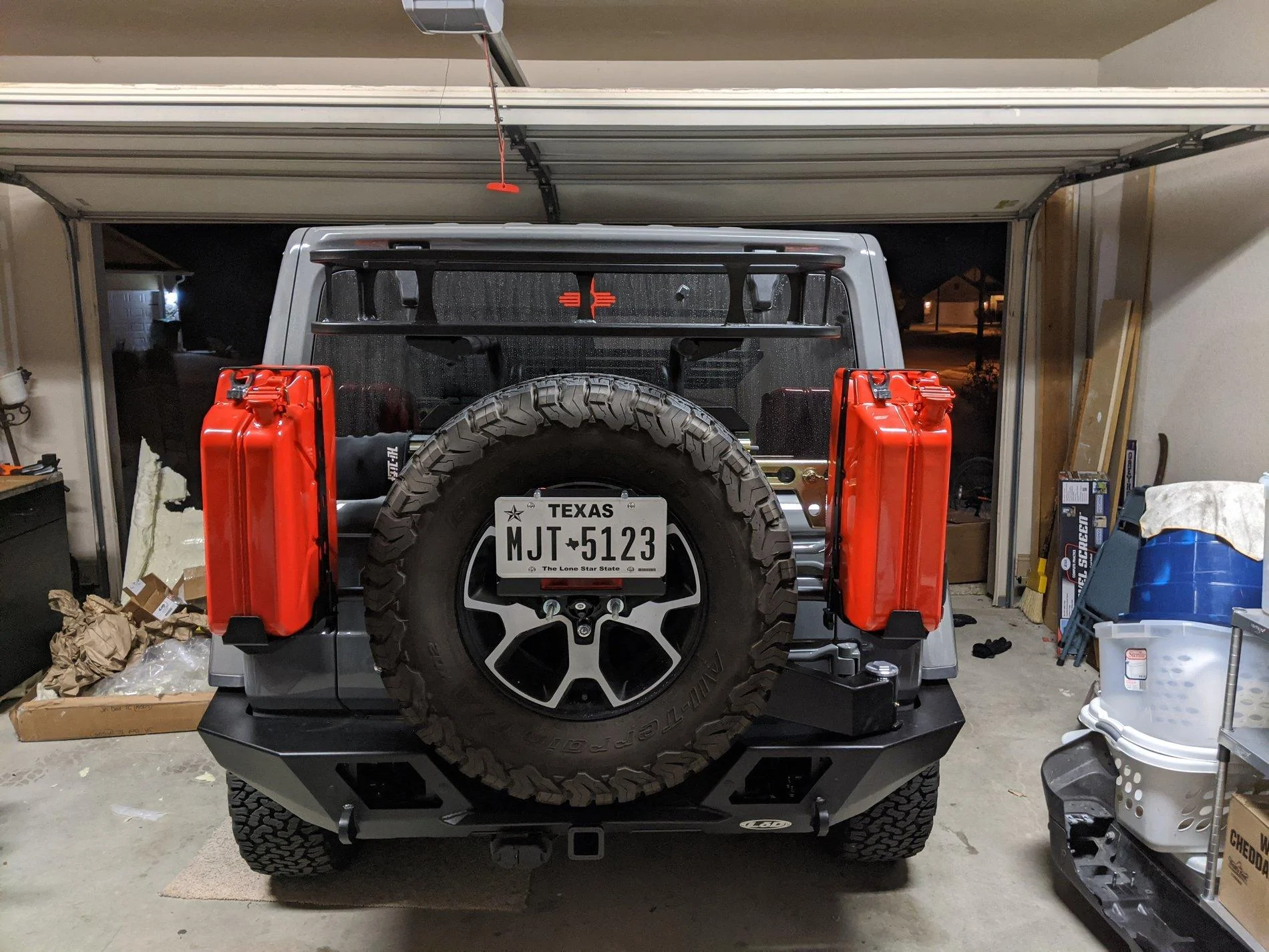

??? The plate I made is a point to attach your mount and can. Pictured is a 3.5 ga fuelpax can....if that question was being asked of me.

I have the TrailRax Pak Rax...easy install and very sturdy. https://trailrax.com/shop/jlpakrax/
Another vote for the Trail Rax, it's a little pricey, but a pretty sweet setup. I was going to go with a tailgate setup, but depending on how you mount it, if you go with larger tires it may not fit there anymore whereas the Trail Rax will work with any setup that includes a hardtop.
