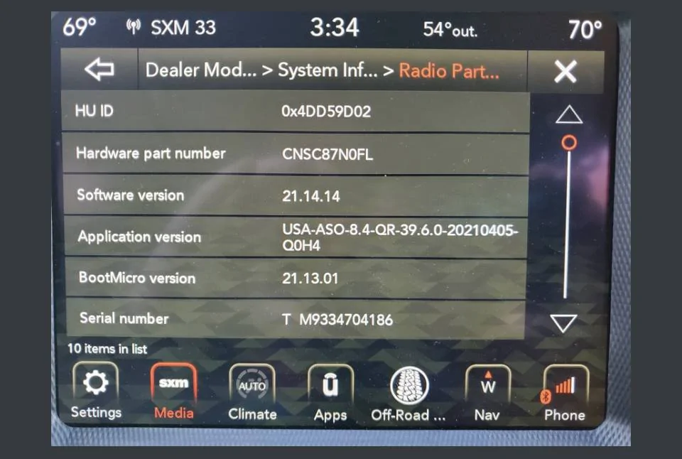

Duh lol I have 39.6
Besides the typical try a different cable, test a different phone, disconnect all other items from all USB ports except the phone, reset phone to factory to remove any potentially conflicting apps, try phone in a different vehicle, verify vehicle software is up to date troubleshooting techniques, I’m not sure what else would fix it. Maybe there are some clues here at the wonky USB thread - https://www.jlwranglerforums.com/fo...has-gotten-the-newest-update-report-in.77165/
