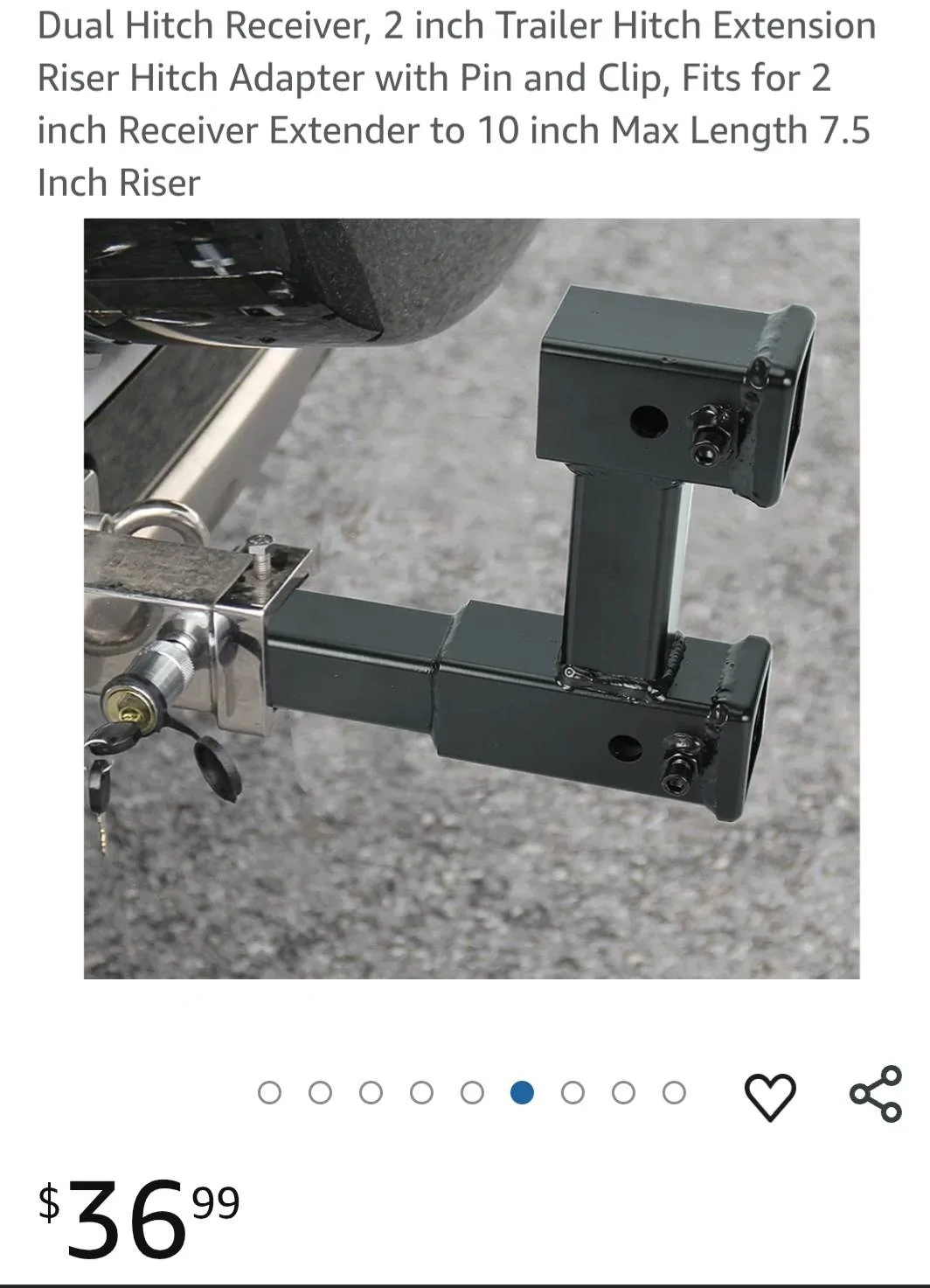

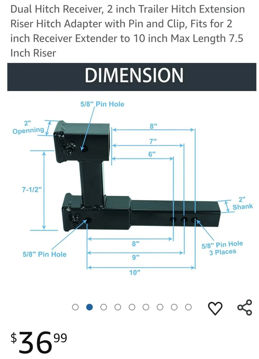

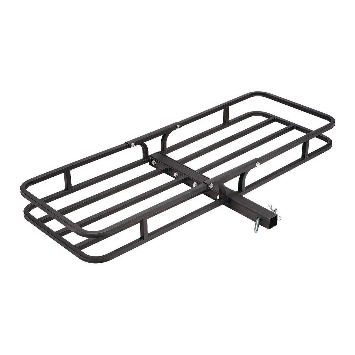

I bought a cheap HF cargo carrier a few years ago to carry some firewood for camping. I tested it on the trail, I lost half the wood and the carrier was dragging on basically everything. (Mission failed)
Does anyone think using a 7.5" riser will work off-road.
Will it be high enough?

Shit, I initially thought you were joking. Apparently not?
If departure angle was an issue in the past then I'd be wary of how far out it extends prior to rising.

I thought if I could raise it enough it might not drag but I don't know if 7.5" is enough. The only other option I can think of, is to have my local weld shop make one higher.
If welding one is an option then have it go up diagonally directly from the receiver.
Doing some measuring. I think 7.5" would be close, more would be prefered. 9 or 10" should be good.
If I go this route, how much of an angle should I have it cut & welded too? Maybe 20-30 degrees?
You'd need to figure that out based on needing to clear your spare. Maybe a cardboard cutout? Maybe the shop would be able to look at it and give suggestions?

I tend to doubt it will help much, given the length (depth, amount sticking out the back) of the carrier, but you know all the dimensions so why not sit down and calculate the angles and see where you're at? Or mock it up with cardboard boxes or something and measure on your Jeep?
I'd look at a regular drop hitch that is reversible (drop or rise) rather than that butt-joint adapter thing. You can get adjustable ones to at least 12" up or down (or maybe more; that's the most I recall seeing off-hand).
Personally I'd look at a carrier that puts stuff over the spare tire or on the roof.

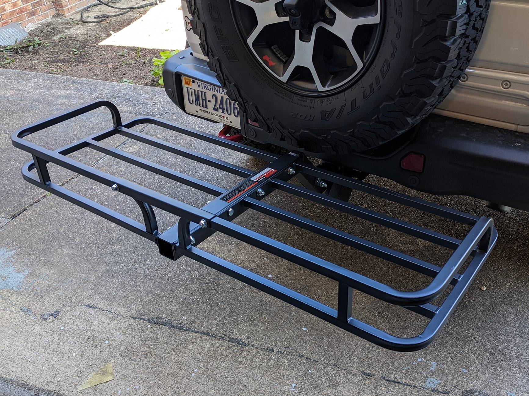

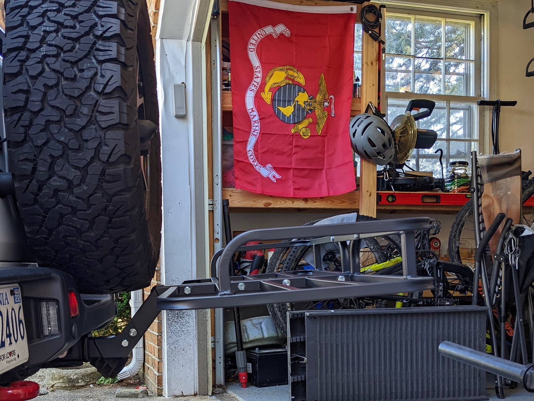

Old pics, don’t have any others on my phone.
We have used a HF ATV basket. When we’ve traveled with it I’ve used it paired with our Kuat pivot, which not only is nice for access but also allows it to clear the 37” spare
I'm thinking that diagonal hitch would meet @Flip's needs. Any details?
