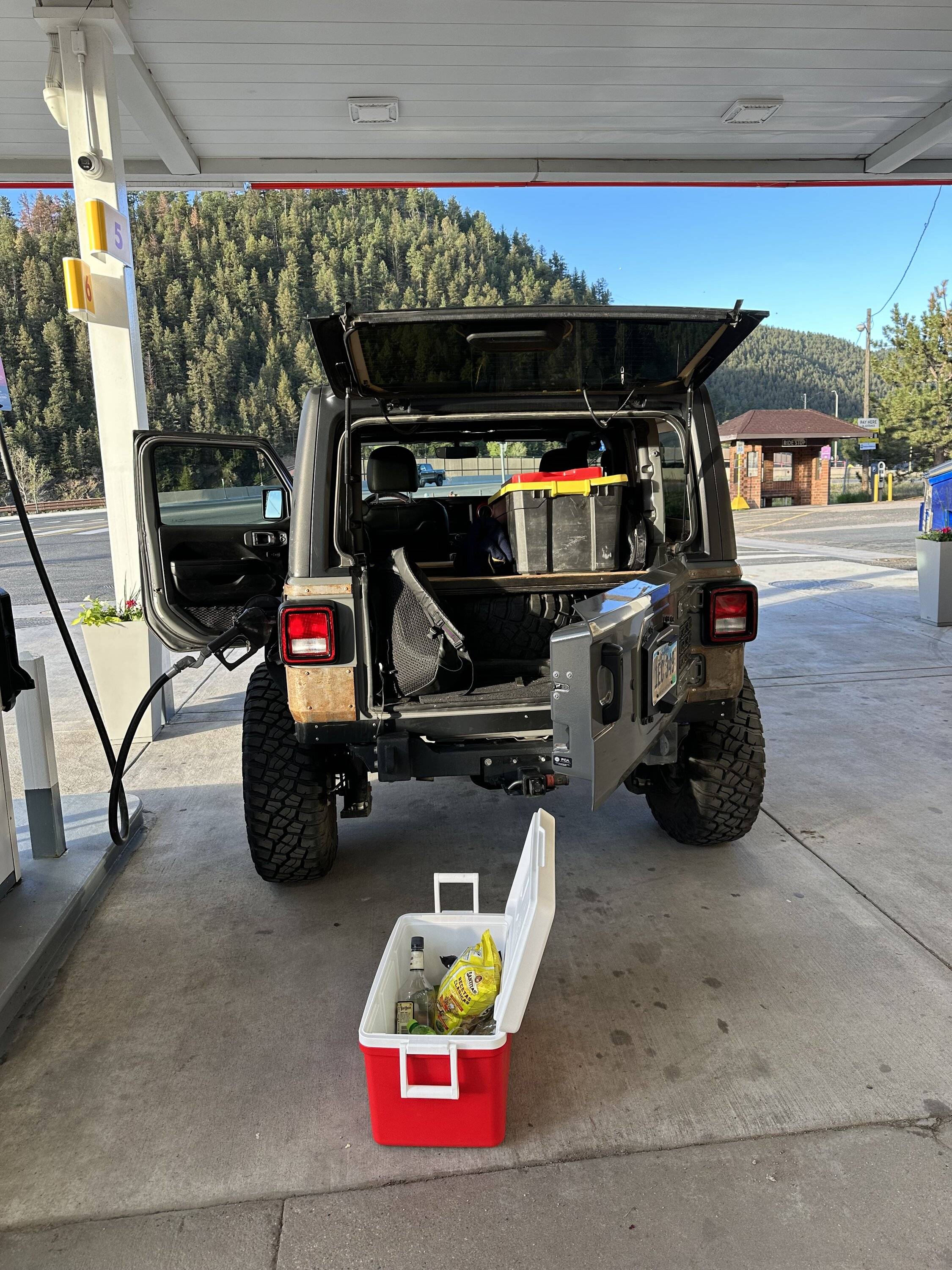

Wheeling will likely break the plastic. I’d build the platform below it.
I wanted to see better so my platform rests on my spare. Lots of space below the platform in the wheel well and four corners.
The idea is to have a place for the dogs to rest and attach their harnesses to and still have plenty of room under for camping gear. Which is why Im hoping to bolt it to the top of the tub.
Also Ive been trying to figure out what thats a bottle of in the cooler lol.

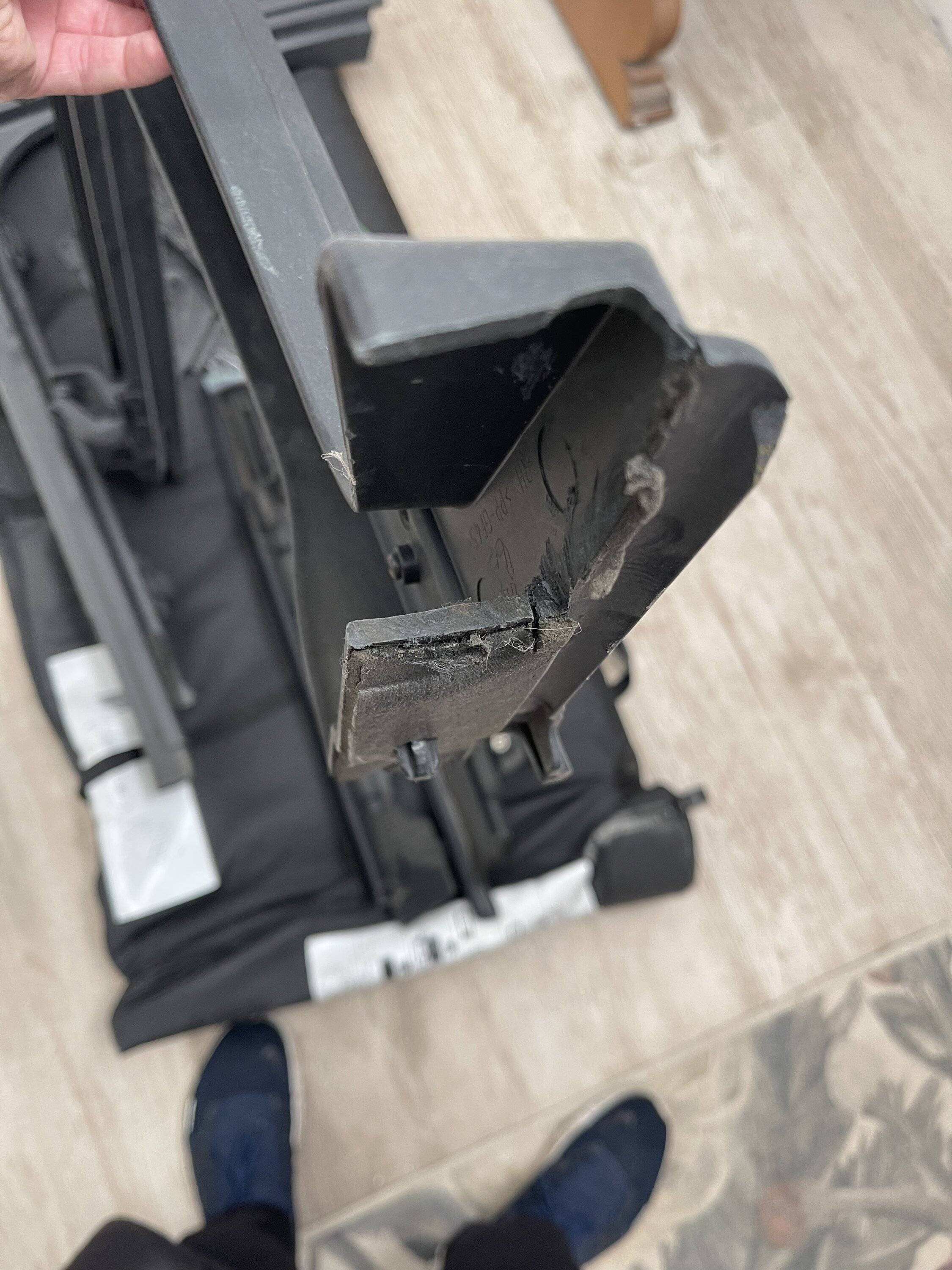

you can trim a section of it on the inside if need be to make room to bolt it down the hard top i bought off a forum member used to have an internal spare tire rack that used the hard top bolts which was in the way for the soft top. he trimmed some off. I have yet to have issues with the trimmed piece. ive attached a picture
Jeep Wrangler JL Can we cut this piece off? softto

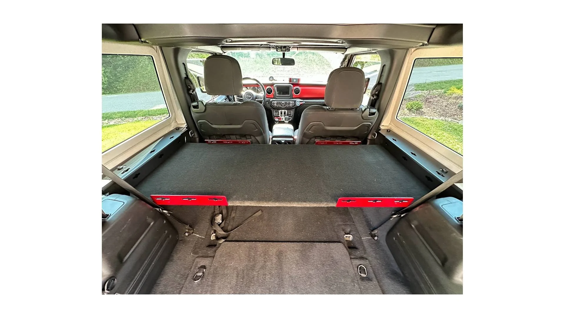

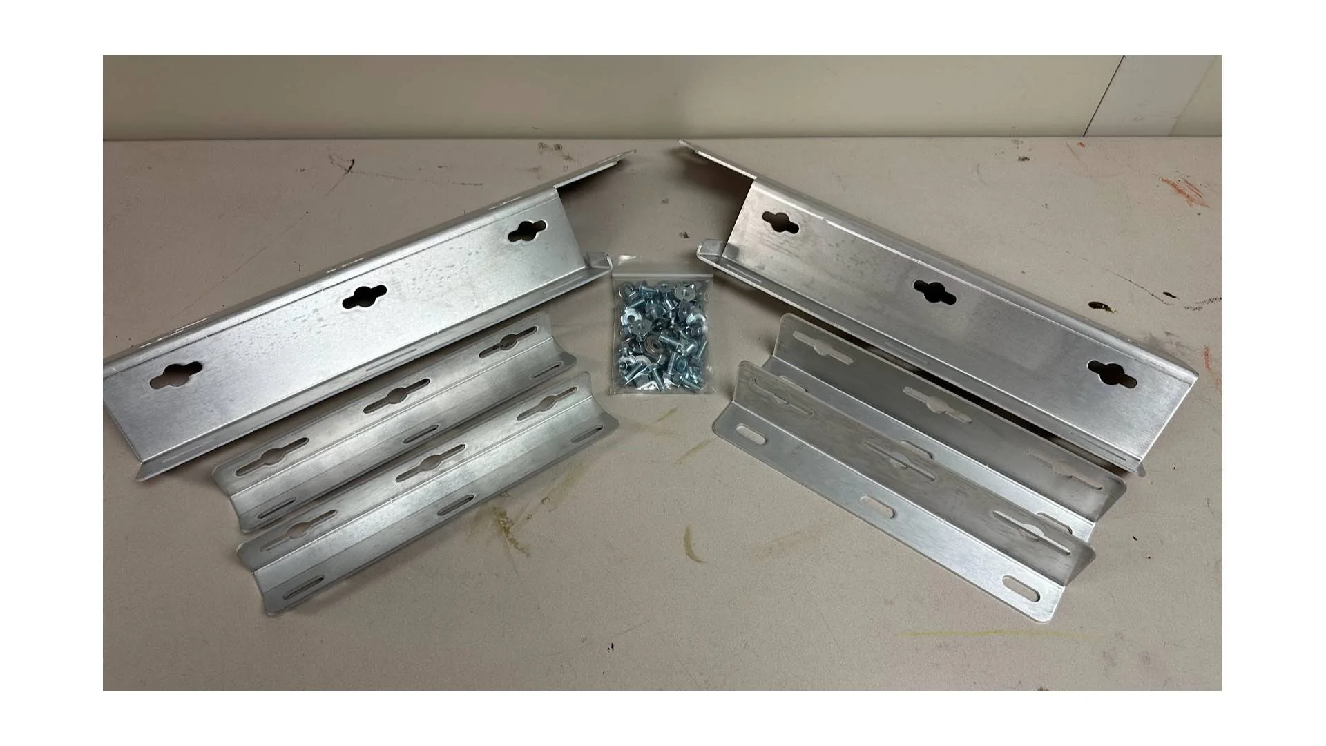

here ya go
Yep thats exactly what Im looking to do but theres a big plastic piece in the way with the soft top lol.
Dont suppose you are willing to part with the cad files are you lol.
