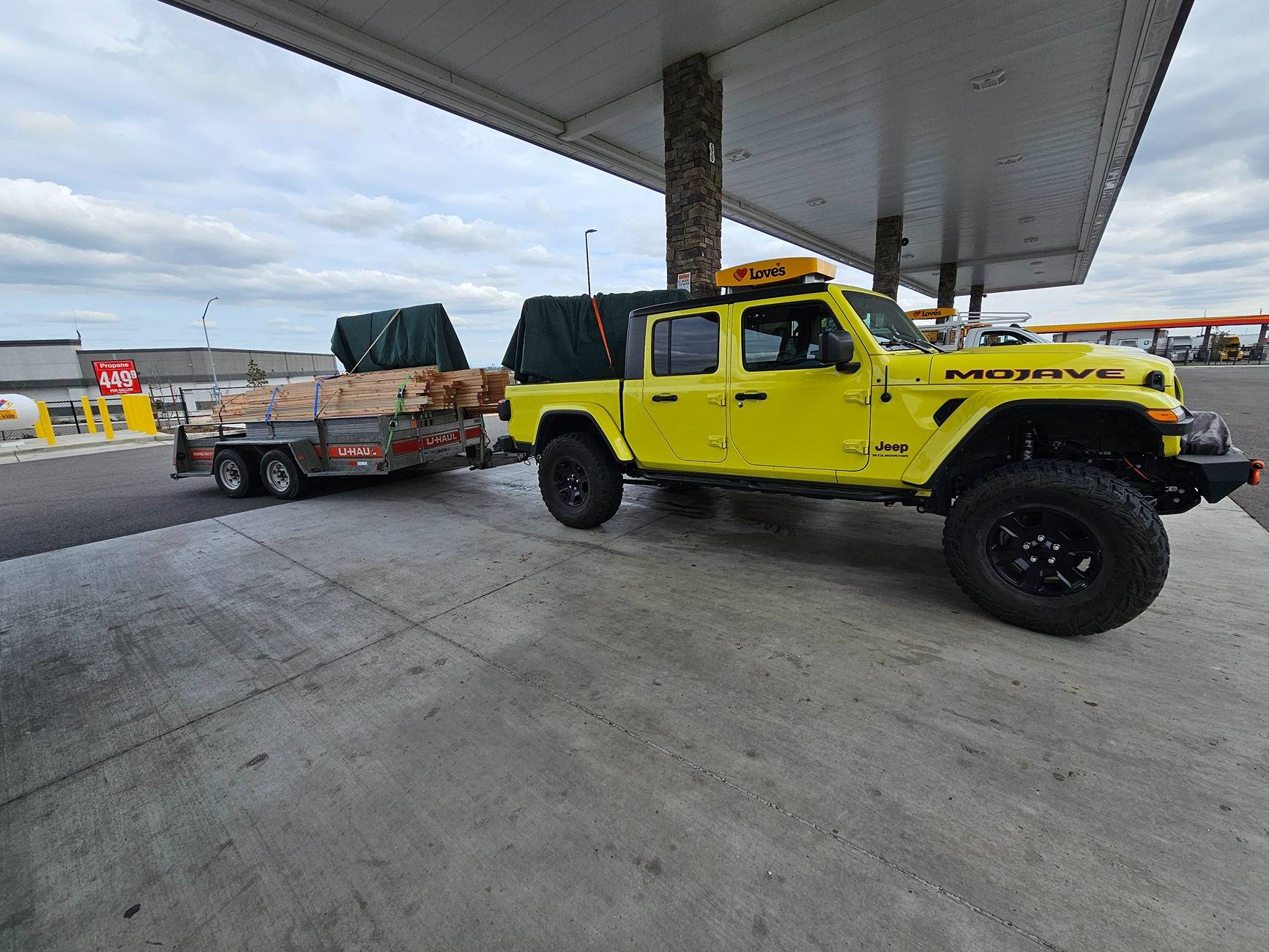

My JT mojave has a 6k pound rating. Towed 8420lbs 600 miles without issue. No weight distribution hitch, no added trailer brake controller, 3.5" metalcloak springs and 37s. Even up a 4k for elevation gain in 20 miles it had no issues maintaining 65mph. American tow ratings are very limited by the required grade test in 90⁰plus heat. I'd be way more comfortable towing 4500lbs with the JLU than the WJ that was rated for it. Stronger axles, stronger brakes, better engine, real frame not unibody and a longer wheelbase. The new JLUs are even available with a 5k pound rating.

My JT mojave has a 6k pound rating. Towed 8420lbs 600 miles without issue. No weight distribution hitch, no added trailer brake controller, 3.5" metalcloak springs and 37s. Even up a 4k for elevation gain in 20 miles it had no issues maintaining 65mph. American tow ratings are very limited by the required grade test in 90⁰plus heat. I'd be way more comfortable towing 4500lbs with the JLU than the WJ that was treated for it. Stronger axles, stronger brakes, better engine, real frame not unibody and a longer wheelbase. The new JLUs are even available with a 5k pound rating.
Wow howw did you get that awsome Loves light bar? Its way cool on your Mojave
That U-Haul trailer has an automatic surge brake system built in to it hence you not needing a brake controller. Just about every state will require supplemental brakes for beyond 3,000 lbs and some states require it for just 1,500 lbs.
Your JT will have a higher tow capacity over a JL/JK due to the increased wheelbase on the JT. Longer wheelbase allows a higher tow capacity as well as a longer trailer.
Next is the debate of if a towed vehicle counts as a trailer and thus requires a supplemental braking system. I went the route of yes I need a braking system to tow a vehicle plus my RV manufacturer states that beyond like 1500 or 2500 lbs (can't remember exact weight) then yes its needed.
As you noted, you don't need a brake controller for most trailers as the electric brake system functions off your brake light wiring. As I stated, the JT has a higher tow rating, and I exceeded it by 2400lbs. If it's wheelbase dependent, why can you buy a Rubicon with a 5k pound rating now? If it's wheelbase, why did my 01 grand cherokee with weaker axles, brakes, unibody, and 10" less wheelbase have a 5k pound rating? Why have JLUs world wide been rated at 5k pound since 2018? Sure most of Europe and Australia limit trailer aired to 60-65mph, but you could do that yourself if you decided to tow a 4k pound trailer.
