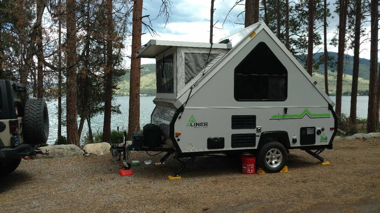

This was the max I towed it was around 3000lbs empty
Jeep Wrangler JL Can I safely tow this?? IMG_0002
and I always had the water tank empty...flat land no wind it was ok but I live in mountain country and lots of wind...so did not make a great combo. I was much happier with the Aliner. JKUR's had 3500lb tow capacity and my new JLUR says it is 5000lb but no way would I tow close to that. if a person tows anything close to 3000lbs they need to make sure they have their trailer brakes properly set up.
