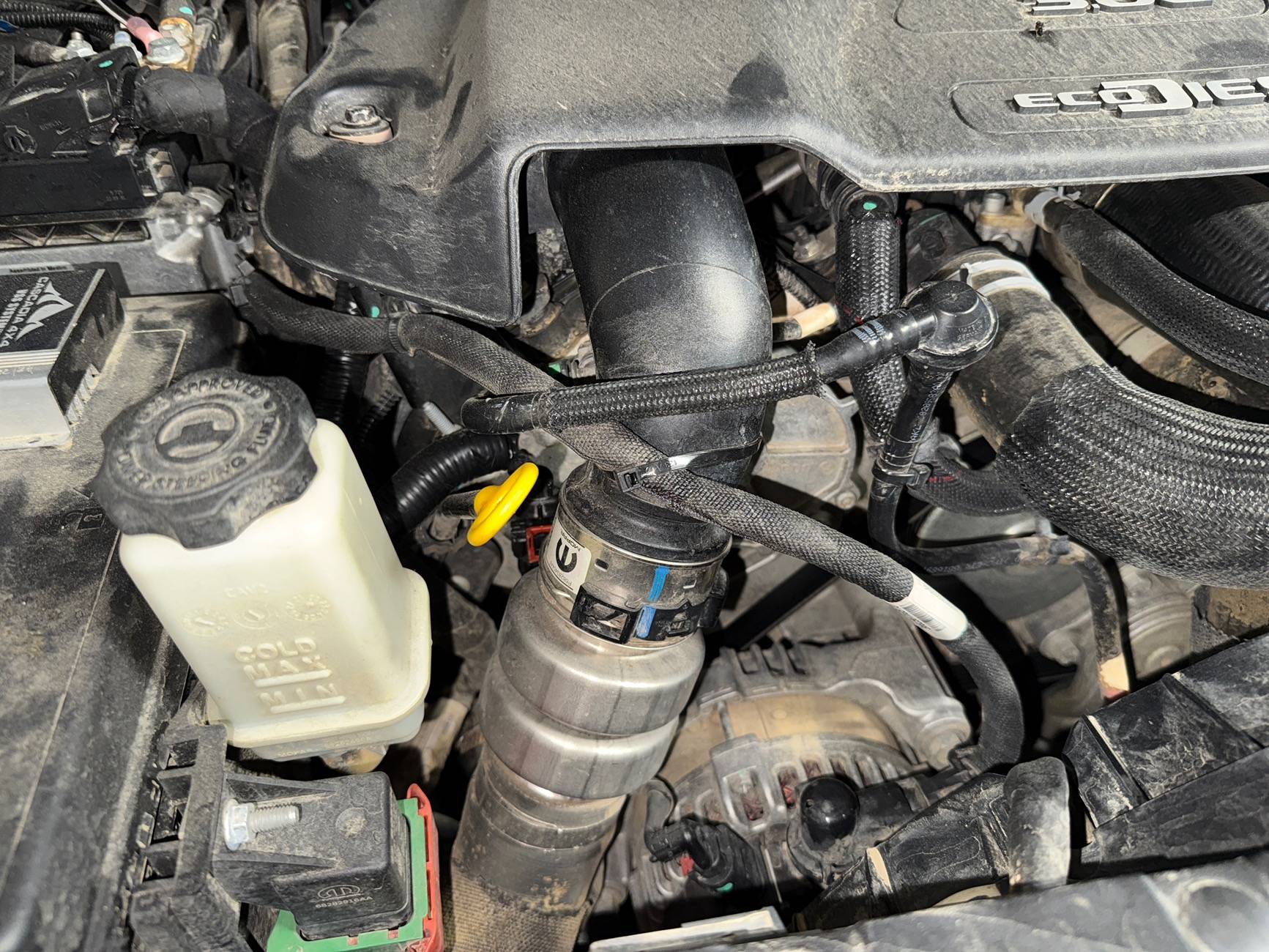

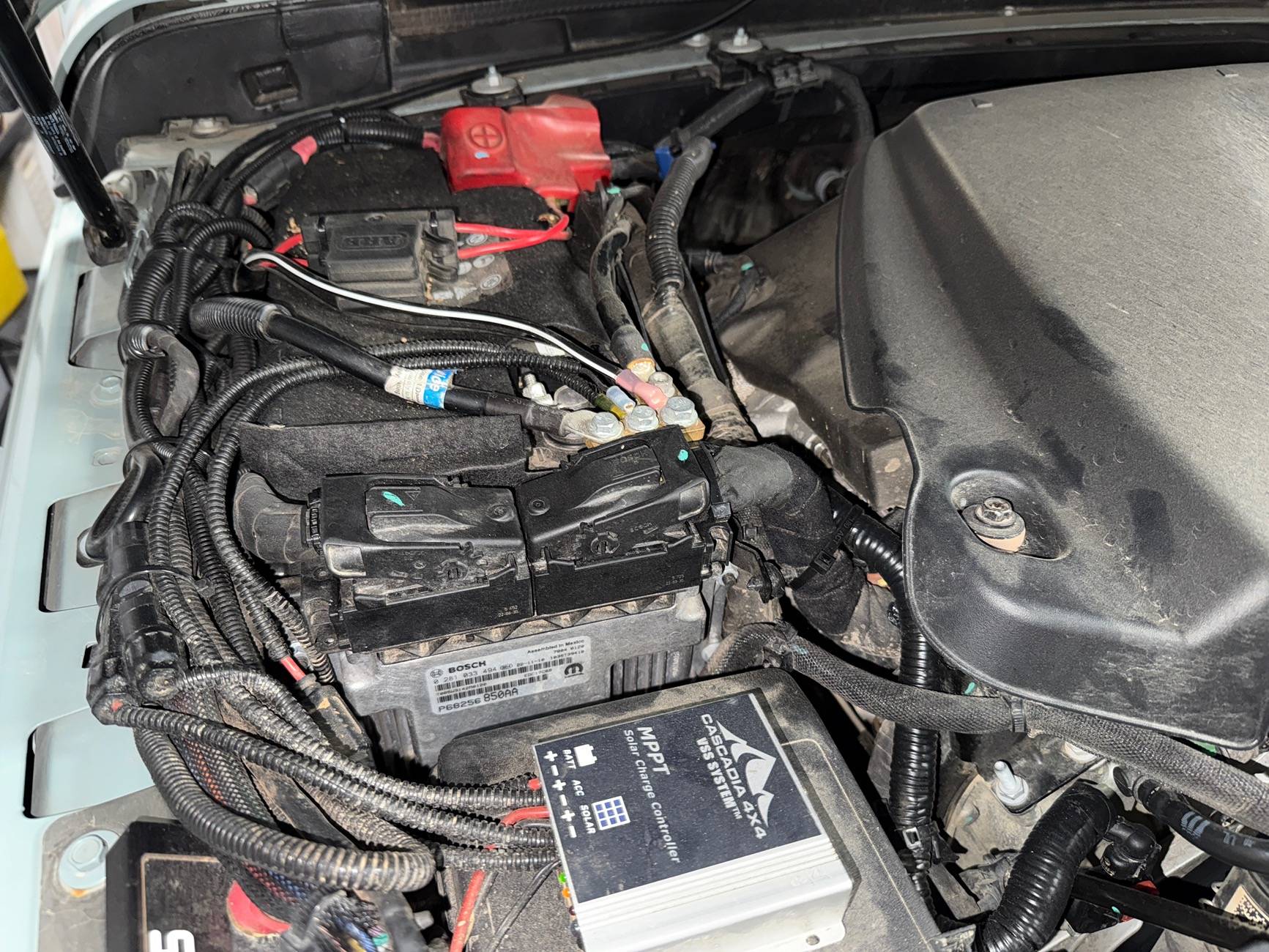

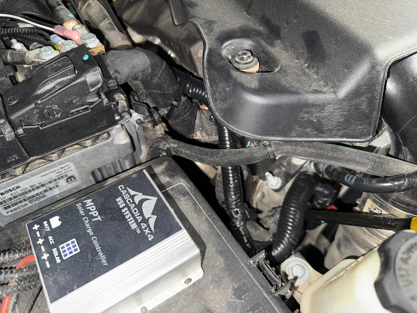

Update: CEL back on. It was worth an $8 try.

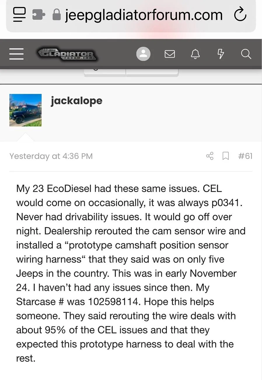

since the wires are all wrapped in that loom right under the engine cover, I’m not going to try with the metal tape. I’m going to call Jeep and open a case with them and see if I can get the same fix that the guy on the JT site got. I’ll keep you guys posted.
