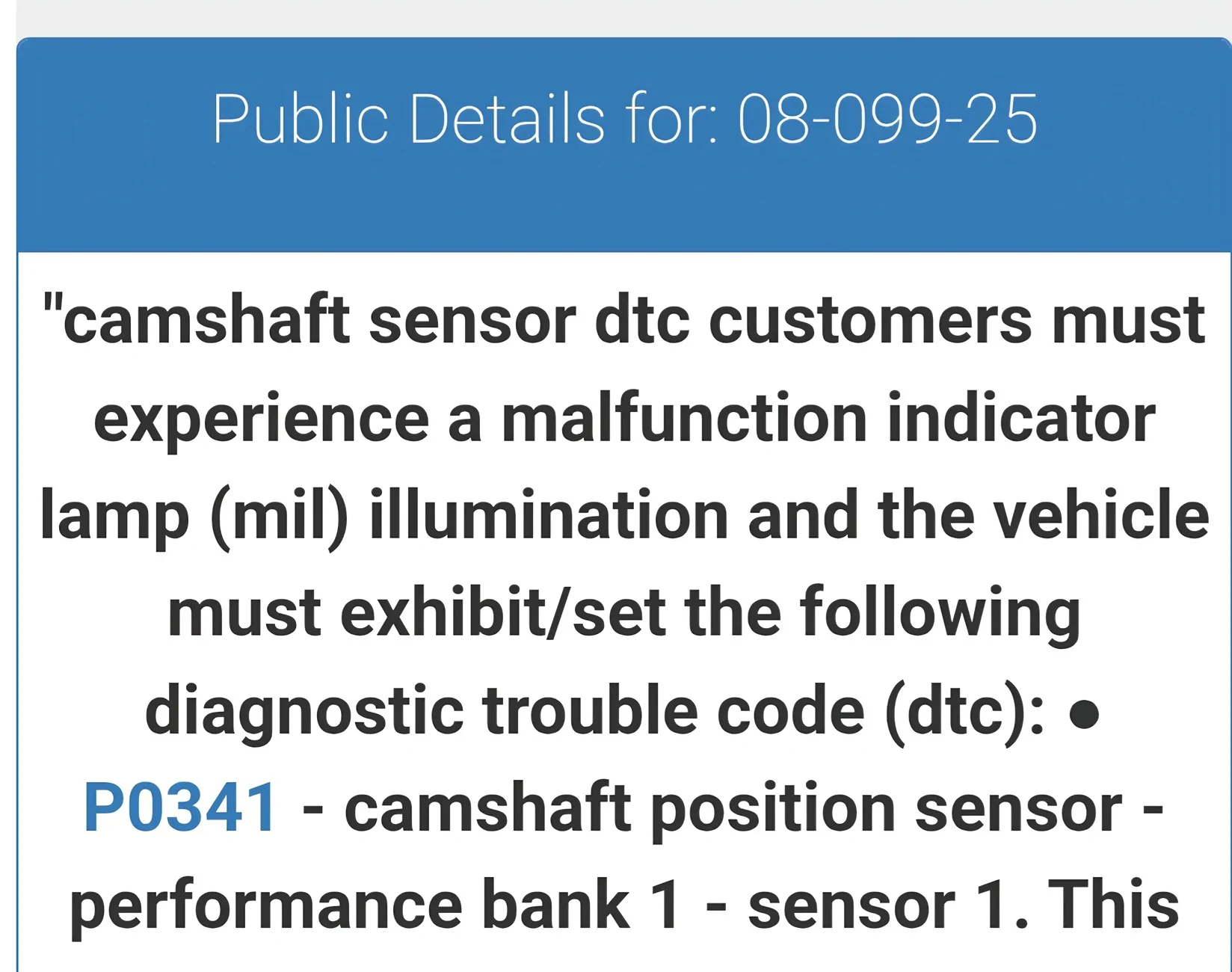

That comment probably unnecessarily complicated my response, sorry.
I am under warranty, but that is not what I was referring to but rather the verbiage at the beginning of the TSB:
"camshaft sensor dtc customers must experience a malfunction indicator lamp (mil) illumination and the vehicle must exhibit/set the following diagnostic trouble code (dtc): P0341 - camshaft position sensor - performance bank 1 - sensor 1."
