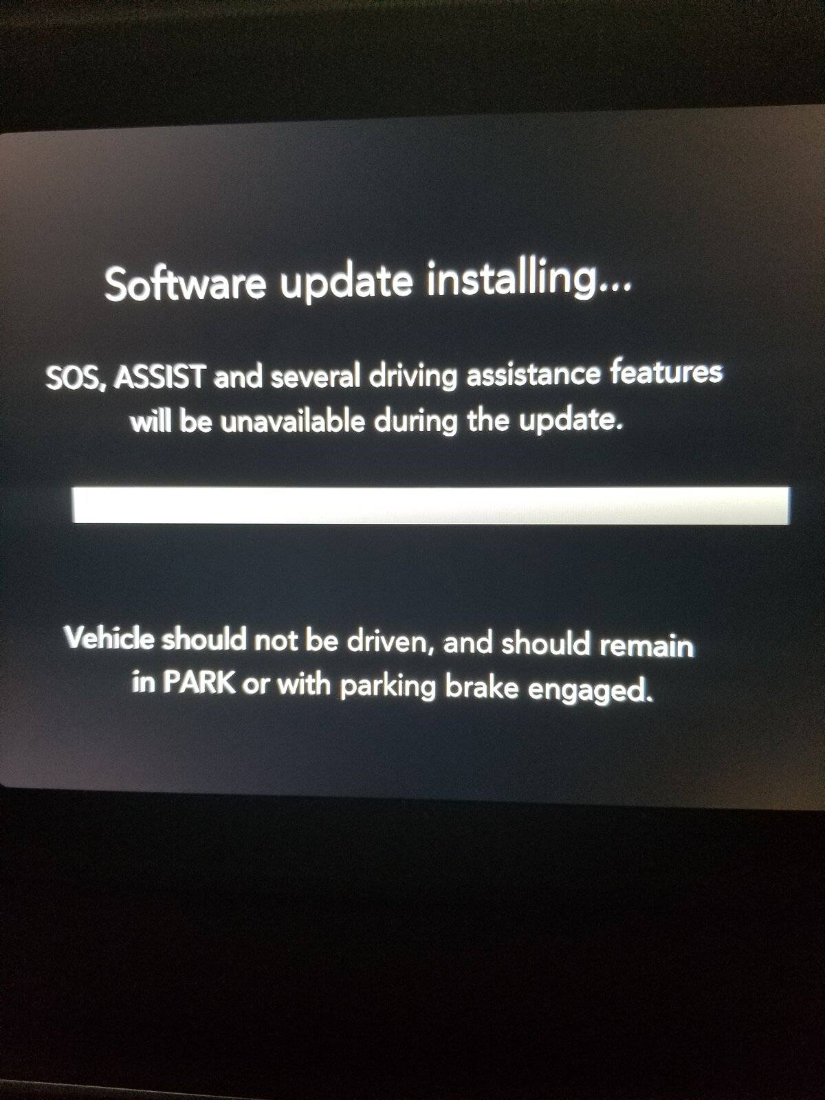

I just had my UConnect fail when doing an over the air software update. only have 4k miles. It ran the battery down almost leaving us stranded. Now going a month with out it. Where did you find a UConnect Case manager?

I received an email back from Jeep Wave Customer Cares center and basically said Nothing could be done. " Unfortunately we do not manufacture the Radio's ourselves, the radio's are Uconnect Radios that we put into our vehicles. We do not have any direct manufacturing oversight on the Radio's themselves". I only have 4k miles.

Your vehicle is still under warranty. Take it into the dealer and have them get you a replacement radio. You’ll likely have to wait a while, but that’s basically your only option. In the interim, you can pull fuse F97 to disable the radio.

Yes that's what we did and the dealership pulled the fuse like you said. Now when we drive it we have no controls for the A/C, No Radio, SOS emergency and Backup Camera warning. ECT. Seems everything is based off this radio head being in place. Have been waiting for a month and all the dealership says we will notify you when we here something. Going on a month now with out it. Thanks

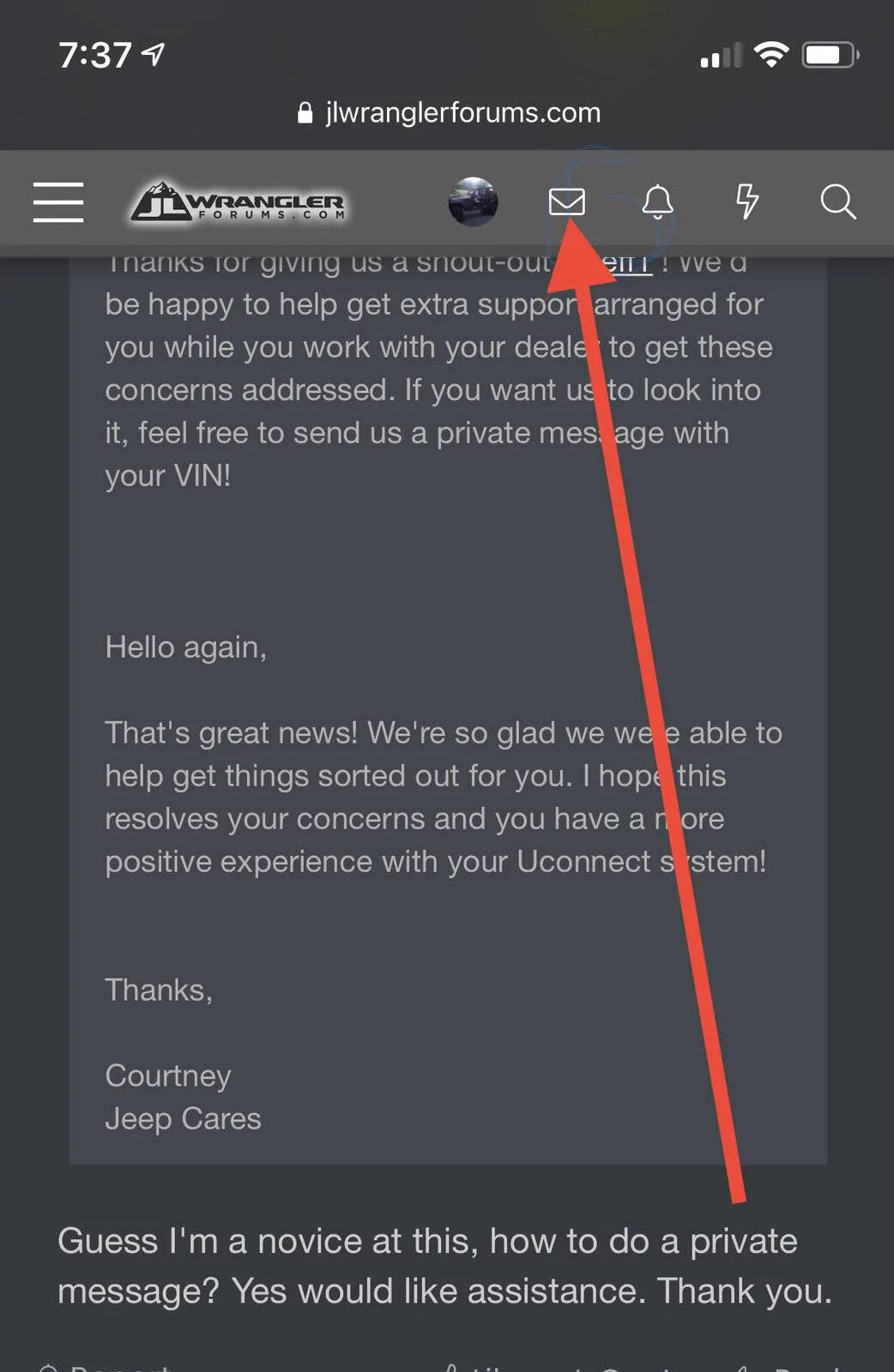

Guess I'm a novice at this, how to do a private message? Yes would like assistance. Thank you.

Click/tap the envelope, then Start Conversation, then put JeepCares as the recipient.
