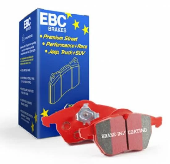

YES, pads are the stopping power.
EBC Pads are the best I have ever run and they have just come out with a new one for Jeeps.
https://ebcbrakes.com/products/ebc-extra-duty-light-truck-jeep-and-suv-brake-pads/
I am going to order a set for my 2024 JLR-X and I have them on my F 450 Heavy Duty truck, makes a major difference and also ran them on my JKR. Great improvement!
Jeep Wrangler JL Brake pads make a difference? product_photo-large_image-197784
EBC Redstuff Brakes
EBC Redstuff Ceramic Low Dust
Part# DP3108C
For:2018 up Jeep Wrangler
Position:Front; Pad Set

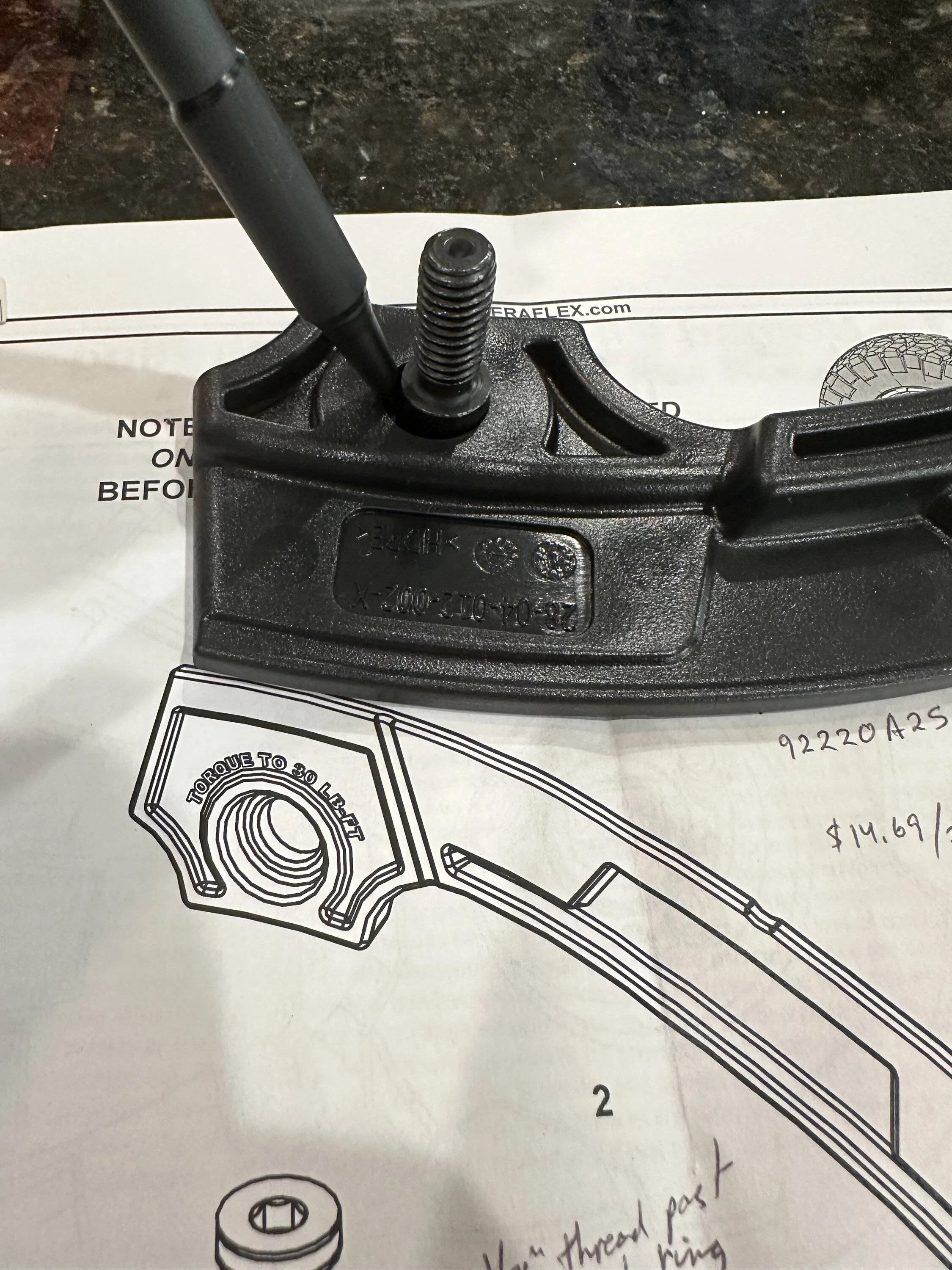

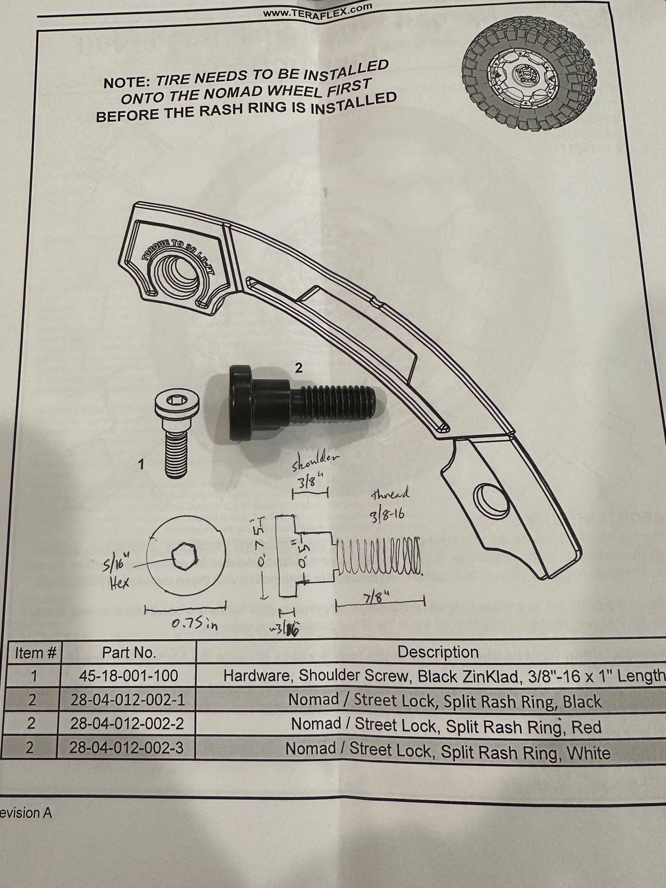

That got me curious, since I had the parts in the garage.
Of course, those exact bolts seem hard to source. :headbang:
Looks like McMaster only has short length shoulder screws in that thread pitch.
They have a pretty close fully threaded, low profile socket head screw (drive size is 3/16 instead of 5/1) and there is no shoulder, but I don’t know how much that matters for these. The shoulder doesn’t even fit snug in the opening of the rash ring, so it’s not like the bolt shoulders index the rings at all. Teraflex instructions say 3/8”-16 x 1” length but there’s nothing 1” about it. The threaded portion is 7/8” and length under the head is 1-1/4”.
Link for 92220A254
