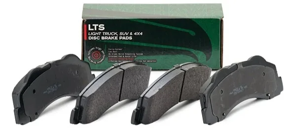

Will hawk brake pads make any difference in stopping power?
I have 37" tires and rented a stock wrangler and when I got back in my jeep, I noticed a massive difference in stopping power.
I know I'll need a big brake kit down the road, but ordered hawk pads for the moment.

EBC Yellow Stuff will provide more stopping power. Those LTS pads are a milder pad.

I cannot speak to the LTS pads on a Jeep, but I have used them on my '93 Land Cruiser. They make a significant different on that truck vs OEM. I can just lock up the tires with the LTS pads, not happening with OEM pads. That is stopping 38's with smaller brakes than the Jeep. When the time comes they will be on my Jeep.

I've used both the Z36 Powerstop rotors and pads and the Hawk LTS pads. The Z36 pads were a very mild upgrade from stock. The Hawk LTS pads are better. EBC pads should be even better than the LTS, but I haven't used them on the JL platform.
I'm currently using the LTS pads. Yes, a big brake kit would be the ultimate brake upgrade, but at a big cost. Hopefully you like the LTS pads. Just ensure you do the proper brake bedding procedure.
