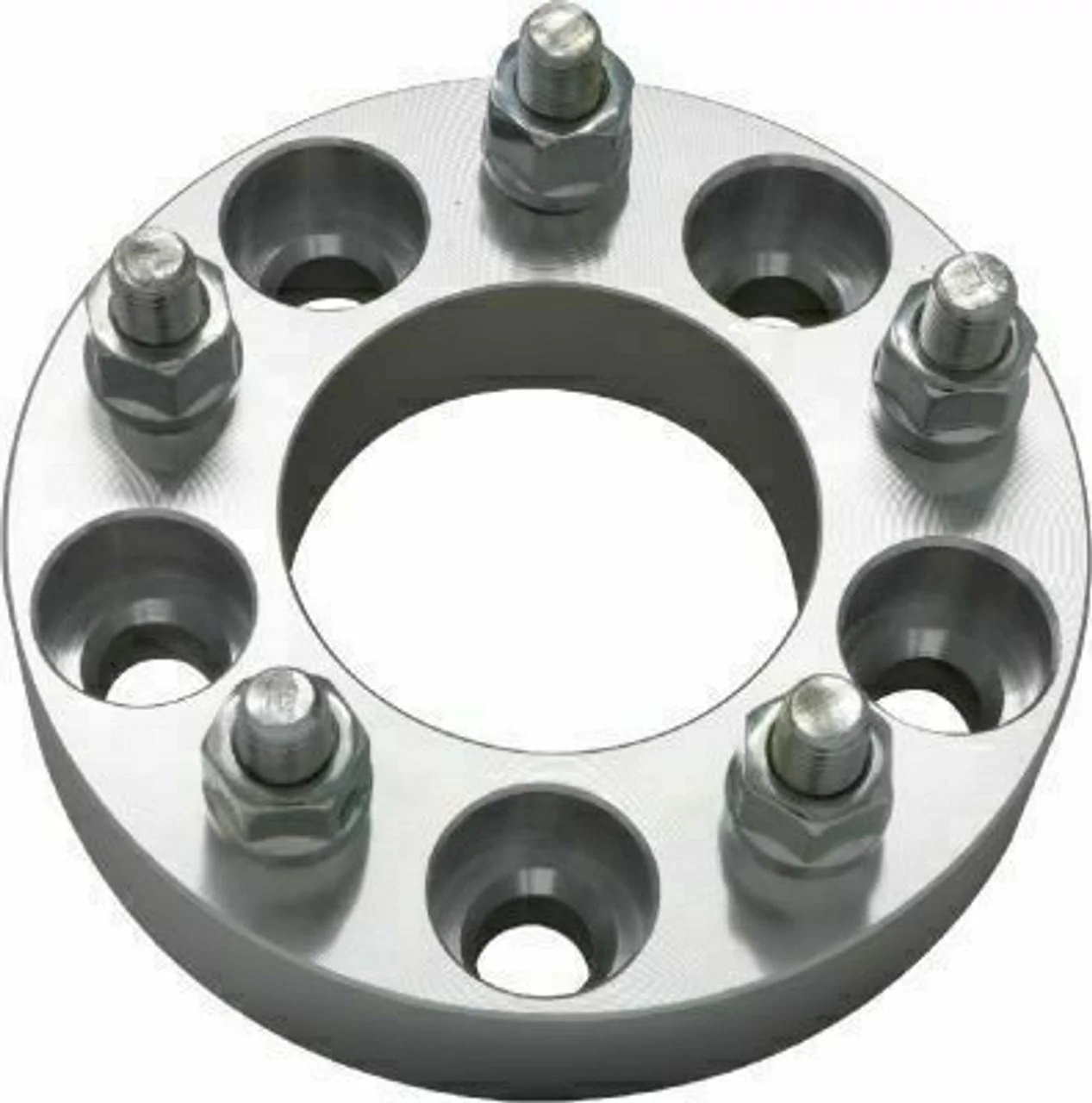

Hope you did not cheap out on spacers... fully hub centric, not just done at hub. There will be a flange at the wheel side to locate and center your wheel to the spacer. Having that type of mounting greatly strengthens load reliability.

I have Rough Country 1.5" Adapters, for my 18" all weather road rims. They are pretty thick and have a large radius, pretty hard to beat.

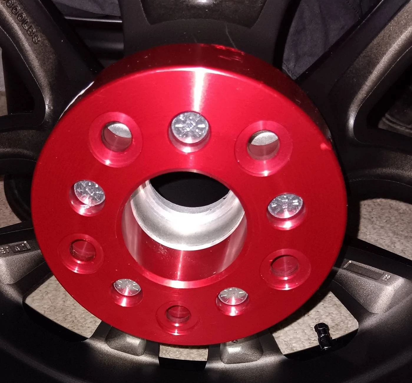

Images on line don't really give you a good reading on build quality... here is an image of how well made the Adapters are. I assume other big named spacers use similar standards.
Here is an example of good quality and bad....

No name brand... oversized center and smaller diameter. Not as strong as above with loads.
