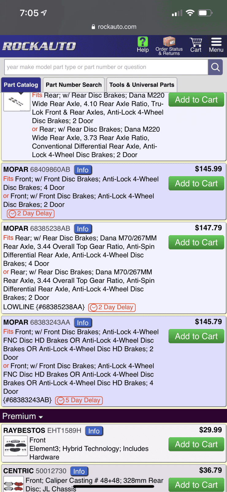

Yes but, all my research shows the below
Yeah, I'm not sure regarding pads, I know the rotors and calipers are different, front rotors are thicker. IIRC the pads are the same part # for all models but???
Yea I can’t get a definite answer. From what I can tell pads are the same with calipers being tweaked to accommodate differences in rotor thickness.

Even the insanely priced mopar pads list all front axle applications
